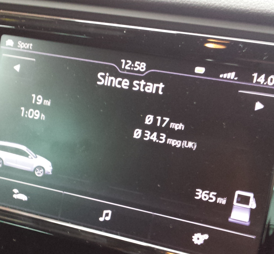

This is really starting to annoy me now. Just a run to the shops today which included a fill up and this is the result.
Surely this is not good enough. The same trip in the old car would be 45 mpg easily.
I don't want to be over dramatic but starting to think I made a bad decision buying this car. At 34mpg it's just not worth having. I'd prefer a megane 275/Golf R/Civic Type R that would yield 27-30mpg.
