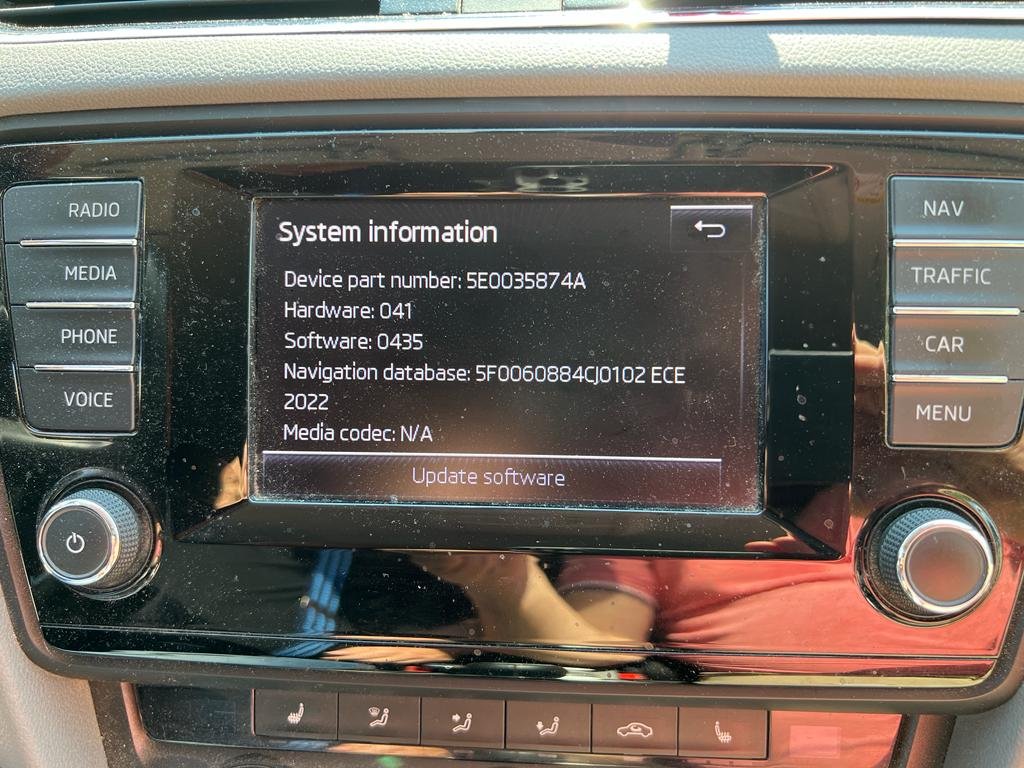

Hello!
Can anybody help me with the firmware update?
Hardware number: 5E00035840A
Hardware version: 041
Software version: 0435
My email address is    [email protected]
Thank you!

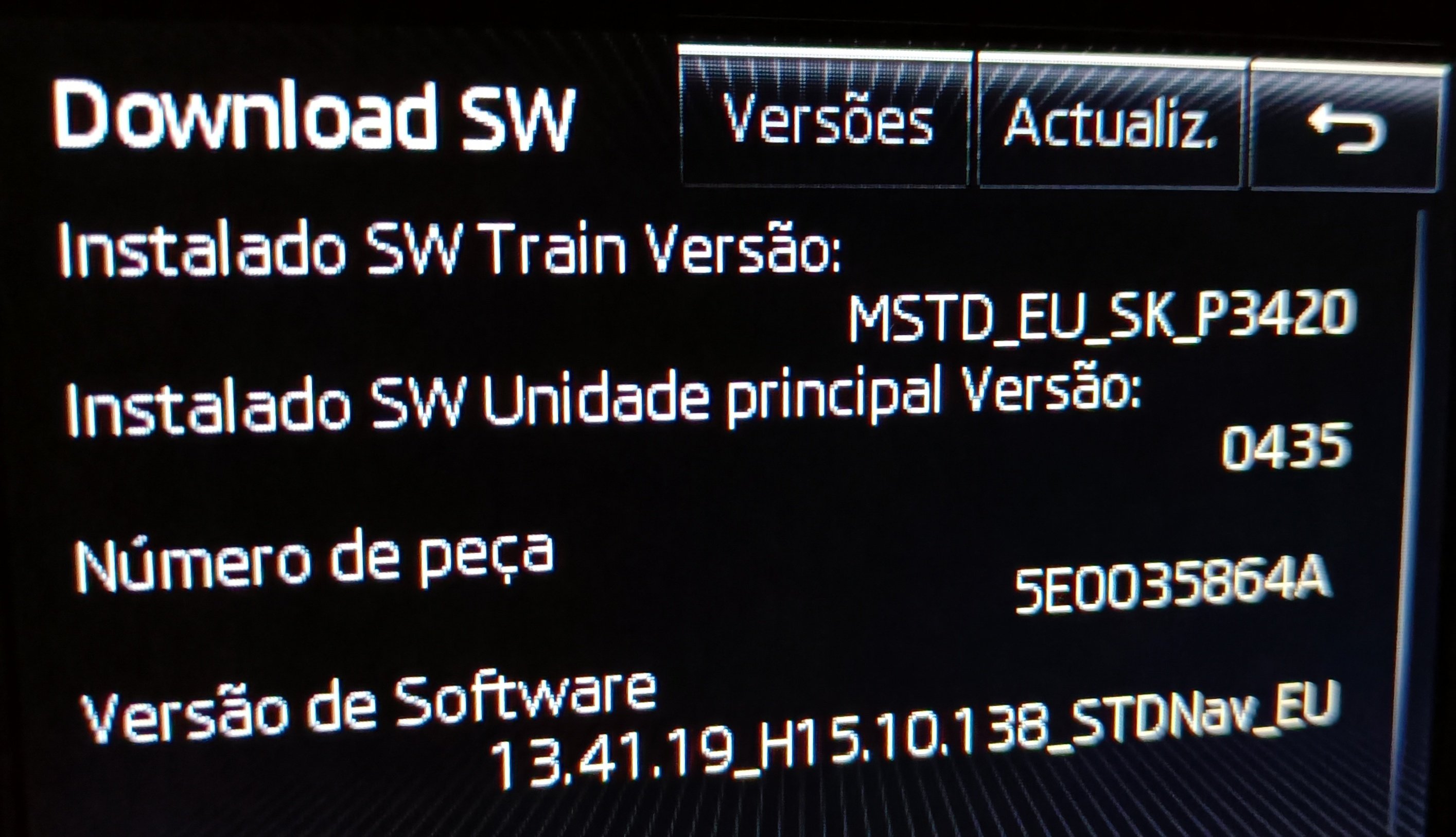

Do you still need firmware update?
If yes, can you get image of Software Train installed in the car.
Use this video to locate the value
MIB Infotainment version check (MIB1 MIB2 MIB2.5 MIB2Std MIB2High)

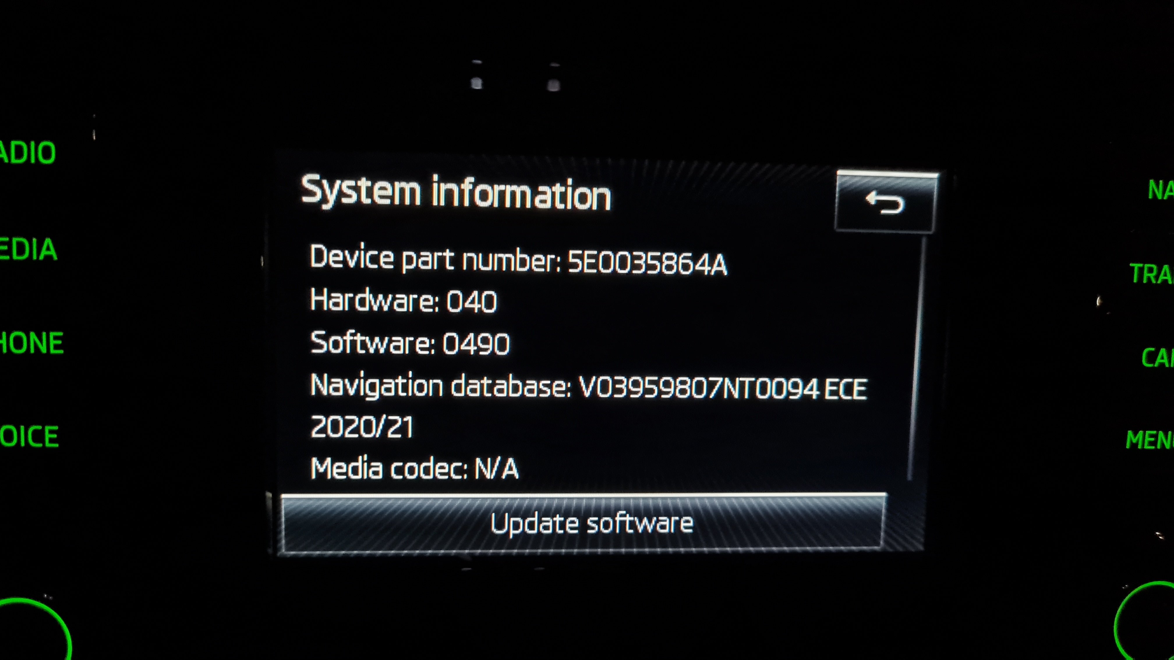

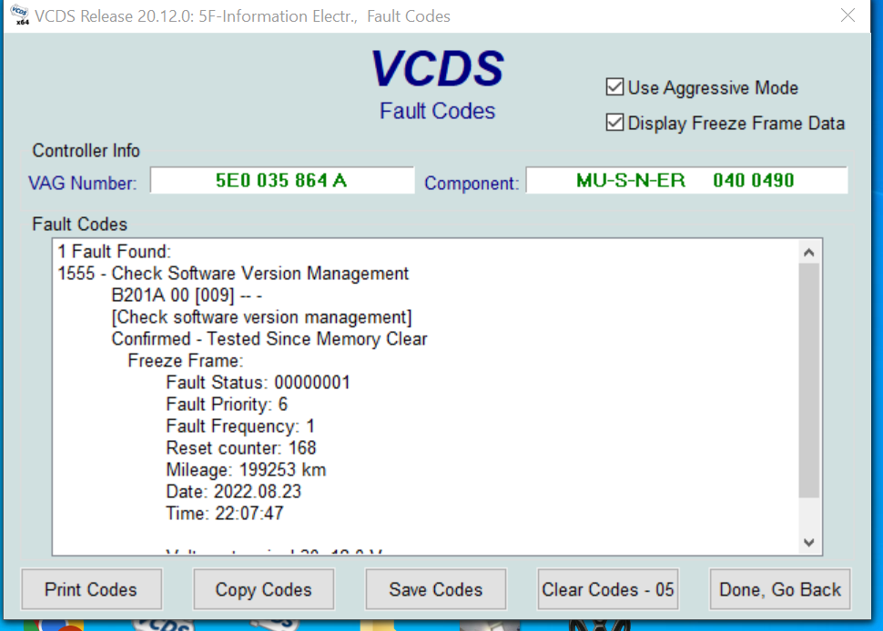

I successfully updated from 0435 to 0490, everything works. Does anyone know what to set on vcds?
Do you have some problem?
The only thing that occurs during updates is a fault code will be set for SVM (Software Version Management) where your car cannot update the SVM server with your new software version.
The fault code will not stop the radio working, and you can clear it with VCDS with some calculations.
5 minutes ago, leskopeter said:
SVM Check, not a physical fault as mentioned, it's the car complaining it cannot talk to the SVM server to acknowledge the update of firmware.
Fix B210A SVM "Fault"
Thank you, you have helped me a lot!
