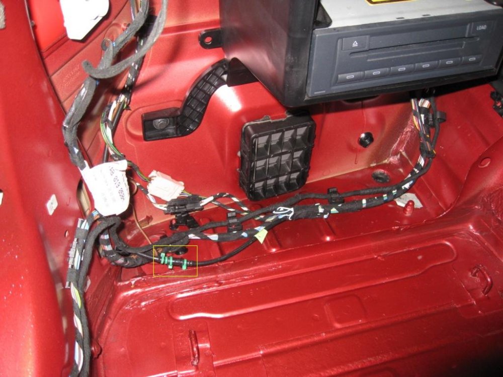

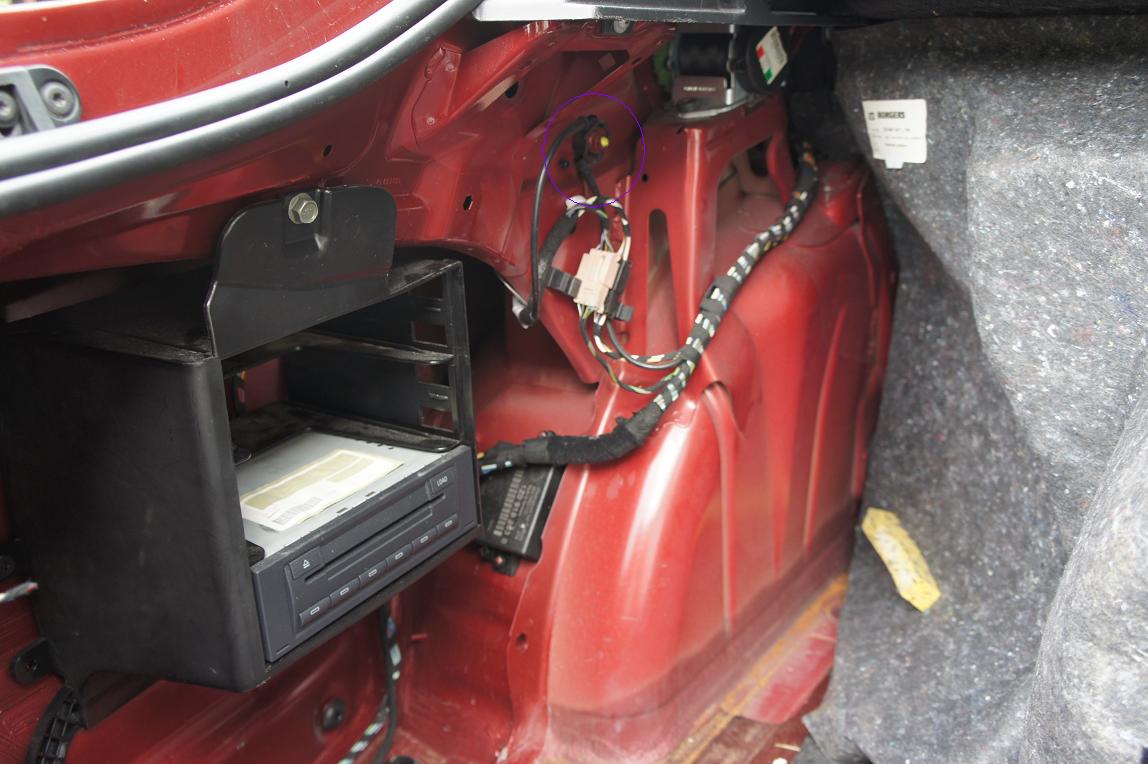

 I am having the NS Rear light trouble with my VRs, I suspect a bad earth at the moment. i just wanted to clarify your quote, "There is a control module behind the carpet on the passenger side (where the CD multi-changer would sit), if this gets wet all hell can break loose." My CD multi changer is in the boot just behind the NSR light, is this where you mean?
Thanks in anticipation, John
Yes, you have it right, passenger / near side (NS) versus drivers / off side (OS), for UK / right-hand drive cars at least.
Here are some pictures to show the location of the connectors and the weak areas of the rear washer supply pipes...

Thanks for your help Silver1001, the pictures are quite good, they tell the story.

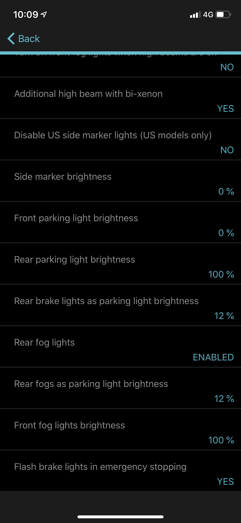

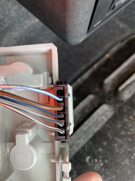

Old topic but I have a similar issue. I have correct bulbs 21/4w but I don’t have a cable in the harness jack for the tail lights. Is this normal? Basically, now I have set my brake and fog bulbs to 12% brightness to create a “C” shape. Any ideas? It’s a pfl hatchback
Yes that's normal :)
Not sure what you're using to adjust the lamp brightness but please take care as it's easy to mess up the lighting config on these cars...
Thank you for clearing that up 👍🏻
Im using Carista but I try to stay away from sections I don’t understand 😆
