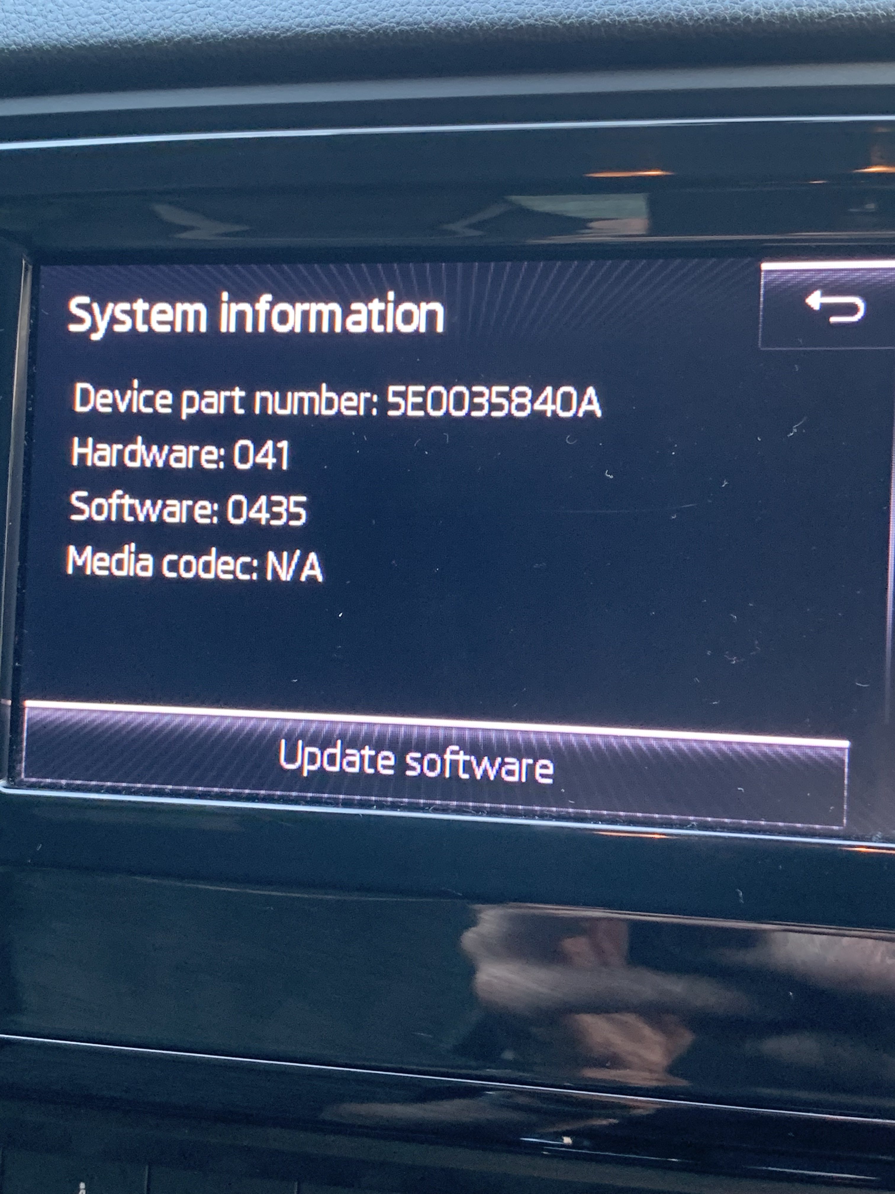

Have tried:-
Parent folder with contents
Contents only
Zip file only
Each time same result, no available media to perform update. Anyone know how it's done? SD card is formatted FAT32, I presume that's correct?
FAT32 is correct.
Have you tried using a USB drive plugged into the AUX input instead?

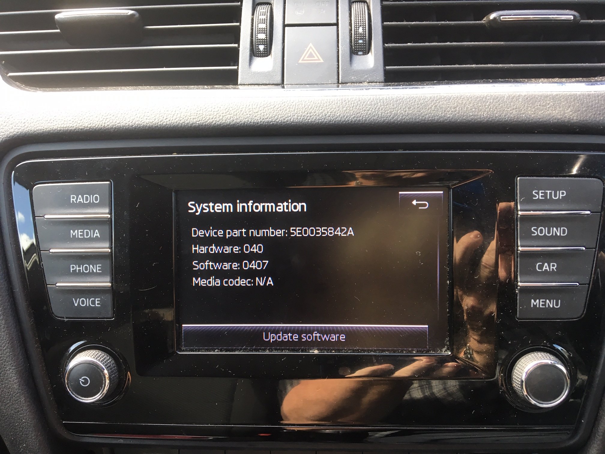

On 15/06/2019 at 10:43, Hasenbraten said:
Hello,
please send me also the link for downloading the newest firmare version of bolero system.
My bolero Hardware: 040
Software: 0421
part number: 5E0035812A
Is this update possible via USB?
Thanks for advice.

File is called "FW upgrade guide" and is a PDF file
It says: Copy the archive to your SD card/USB stick (formatted to FAT32 filesystem), 3 folders and metainfo.txt goes in the root directory (use a reliable error free flash drive)

Nope, PDF file is the instructions. You need WinRAR to open the rar file, it's just a compressed file. You get a free 40 day trial of WinRAR  after installing so no need to purchase.
You should end up with a mib0490 folder, open the mib0490  folder and you should have three folders SKODA_NAV_SSB, SKODA_PLUS_SSB, SKODA_STD_SSB and a .txt file called metainfo2, copy these to root of USB or SD Card and follow instructions in the PDF - read instructions carefully as there are some important details in there.
