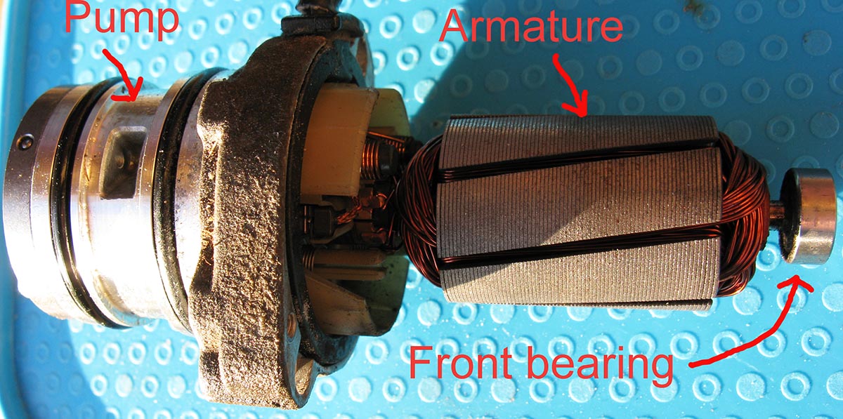

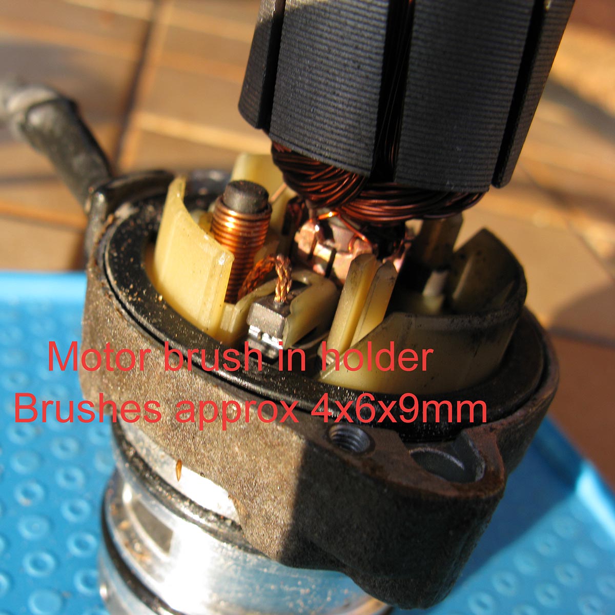

  • O.K Here are all the answers:   Haldex Gen4 pump teardown:   VCDS scan reports 'motor open circuit'.  First step is to test the motor resistance to confirm it is open circuit.  With the rear of Ye

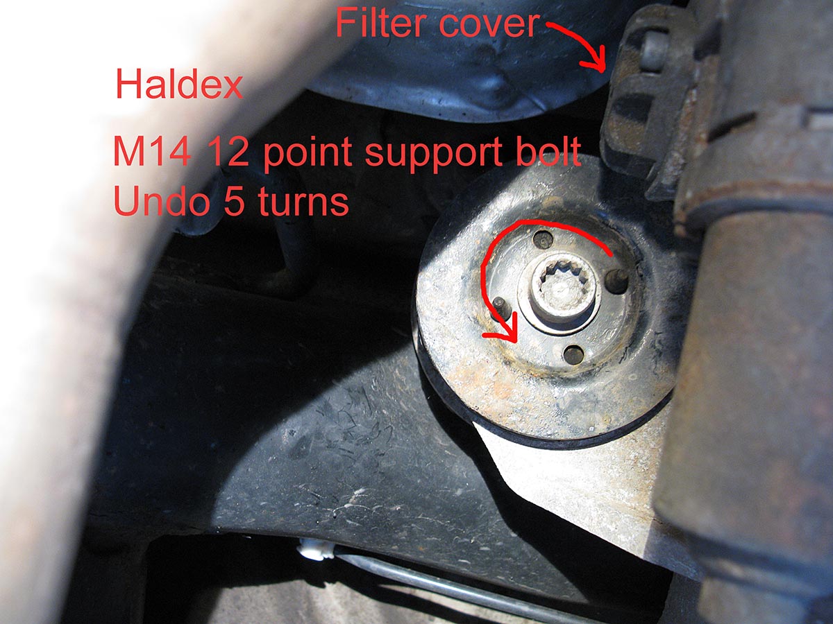

  • I just want to add a few practical notes after getting into my Haldex Gen 4 pump filter in Yeti 2012 Tdi CFHC common rail 51,000 miles. If you have older generation Haldex pumps there is a lot of info

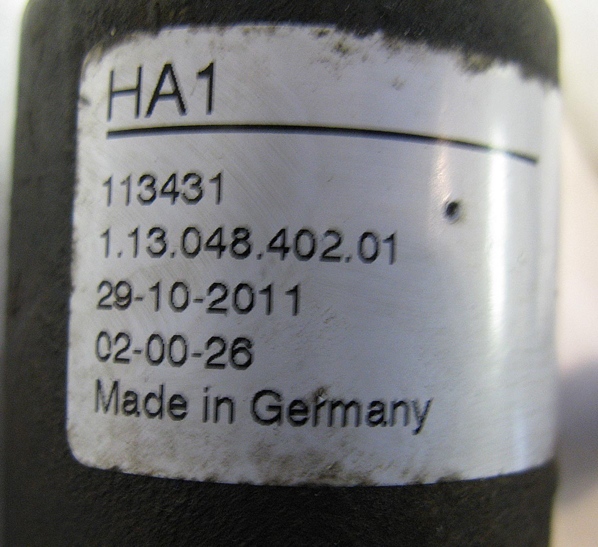

MY12 Yeti  (50k) Gen4 Haldex oil and filter was clean when i looked at it a few months ago. VCDS now flags the open circuit pump motor fault others have reported and reports voltage but no current taken by the motor.
I'm hoping there are some 'outside the box' engineer types like me that can post up hard info. on the Gen4 Haldex. Has anybody looked at the wiring, are there connectors which might go bad? Has anybody removed a pump motor and gone inside? I'm curious to know if this is the kind of motor with flimsy brushes that is going to shout 'unreliable' at me or have they been clever and put an over temperature cut out in the armature windings? or are their motor brushes small soft rubbish, or have they got open ventilation which dumps crap on the motor armature, or is the motor electronically commutated.
It looks like I'm going to have to get inside and do the autopsy myself when the weather warms up, but any help towards the end goal of explaining the failure and a possible fault cure would be appreciated. Since I do this kind of work myself, I don't keep it secret if it helps others!
Along with other VAG parts, the Haldex pumps seem to have high reported failures on discussion forums and it would be nice to find out how they fail and why. If Skoda put in a badly designed or unreliable part, I don't want to replace it with the same

Have you removed the pump itself and had a look at it?

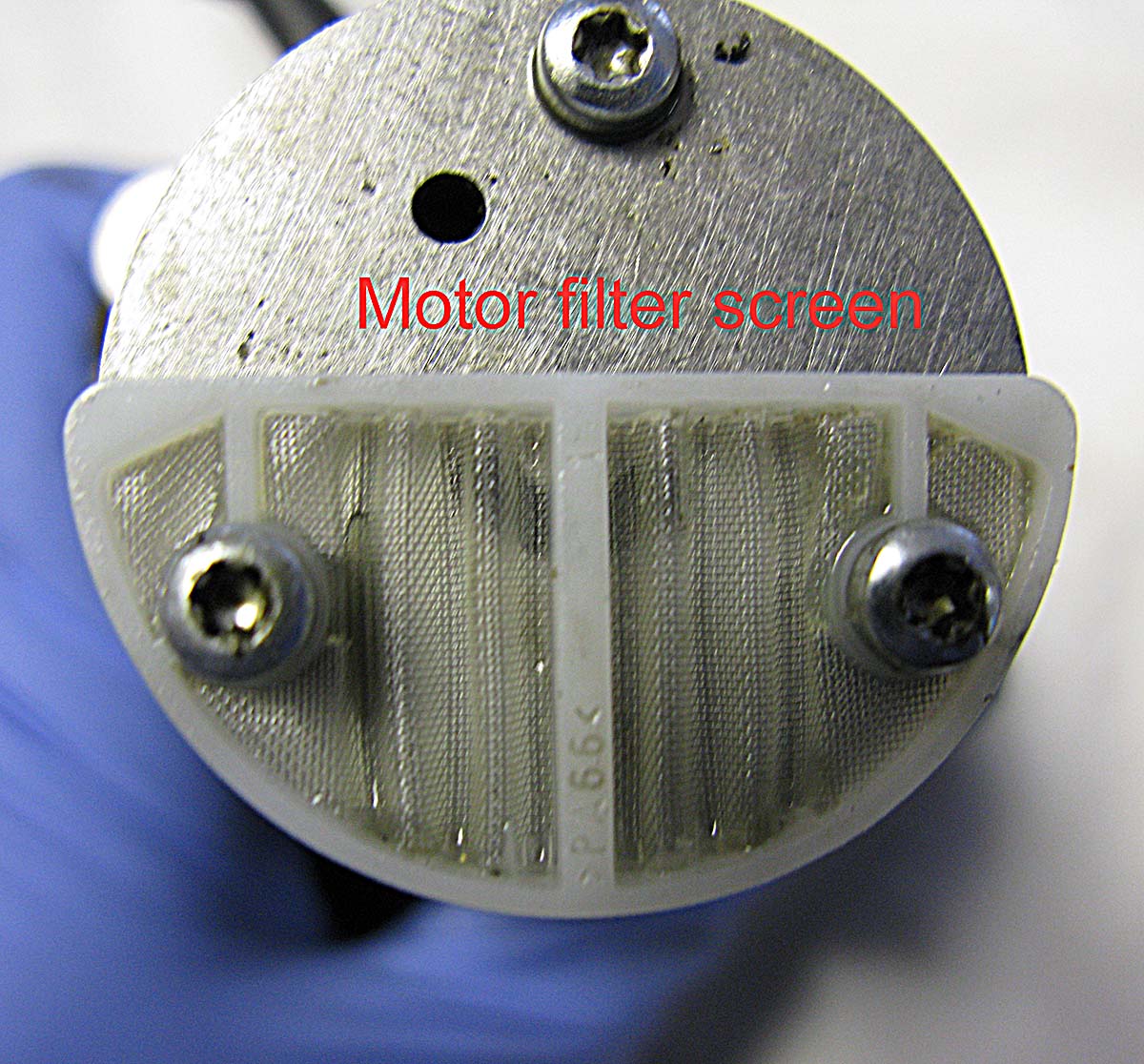

The gauze in the lower region is normally filled with gunge, even if the oil and filter are in good condition.

How much crud was there on the gauze filter, did it look enough to impede oil flow ?
Hardly any, but more than I found on the main filter at the top, which suggests if you are going to check and clean the filter(s) you should remove the pump motor and clean both.
I noticed something when looking at photos for a replacement pump (which I didn't need). My OE pump has a very shallow strainer fitted on the far end as per photo. But I noticed the same pump with a much larger nylon filter. It's too late now to check the housing depth behind the pump and see if a longer filter would fit in the space.

I haven't been inside the mechanics. But from what I could see and feel it is the kind of soft grey sludge you can get from decomposing epdm rubber brake lines seen in a brake master cylinder or from wear on seals with rotating shafts. I couldn't find many metal particles.  It didn't look like extenal road dirt contamination either. I haven't seen this in gearboxes or diffs so I suspect it comes from components used inside the Haldex clutch. MY12 Yeti had done about 50k miles.
The motor filter wasn't completely blocked with sludge and I don't believe the sludge that was present contributed to bad brush contact. The pump is a gear pump and as long as there is some oil to wet internal parts, the pump and motor should be o.k to run off load or with a blocked inlet.  However, it looks as though the main filter doesn't trap it completely and the fine stuff in the oil falls to the lowest point which is the pump. If the sludge is from internal epdm parts, they might be wearing or decomposing in the the oil?
