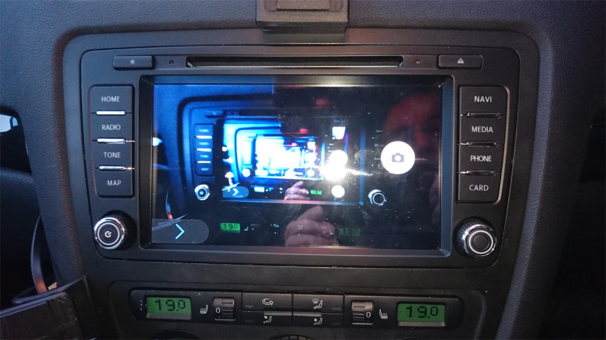

Here's a couple of photos I took this evening.
The first one is of the USB music player, with one of the albums where album art gets displayed. I haven't worked out yet why some display and some don't.
The second is with PhoneLink running, displaying the phone's camera, taking a photo of the camera taking a photo of the camera taking a photo...

How are your contacts displayed?
I bought the Pumpkin Audio FTN600, for some reason it displays some of my contacts surname first or if I ve included a number in the first name i.e. Alan 1 then it will display as
