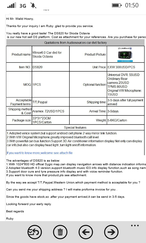

Here is the price quotation from audiosources company.

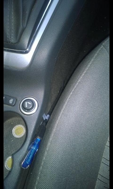

It is very easy to run the USB cable no need to put it in the glove box just pass an electric wire between the passenger chair floor mats and the hand brake mat till it appears in the DVD place tight it with the end of the USB cable then pull it till it appear in the DVD place. The double USB sockets will be fixed between the passenger chair and the hand brake console.
USB double socket fixed between passenger chair and hand brake console
