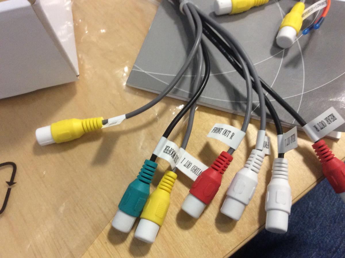

I am considering one of these myself, but can anyone confirm if the DS820 has RCA pre outs for external amps?
Also, what are the main differences between the DS820 and the Andriod unit exactly?
Offline-Navigation is not longer a problem, because Google Maps works very well offline now, also in satellite mode...
Now I am really happy with my Pumpkin...
DS820 has RCA outs on a pigtail.
Big difference is the 820 is Windows CE, not Android and looks more like the original equipment. It really depends on what you want out of a head unit.

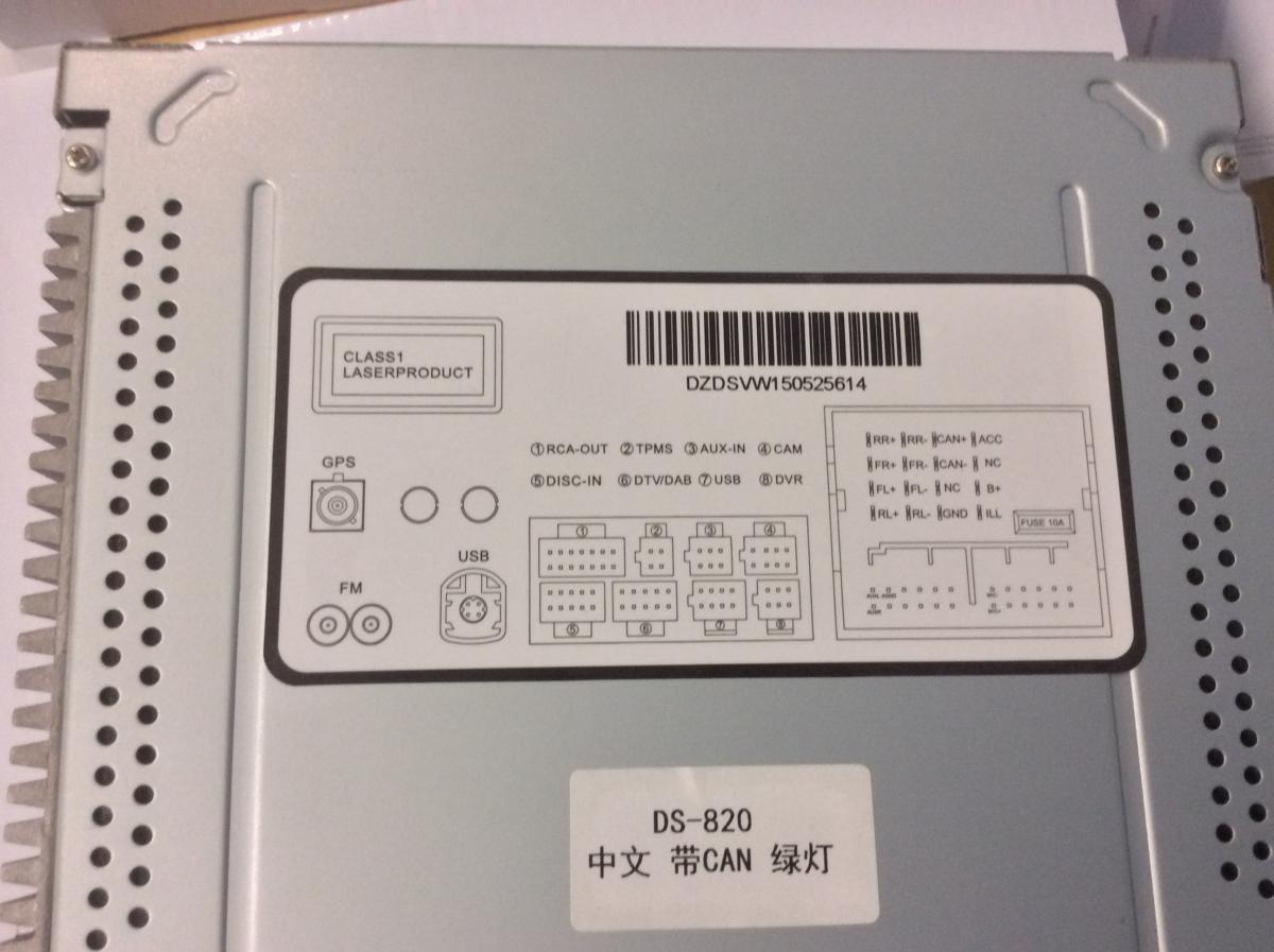

Looks about the same head unit to me

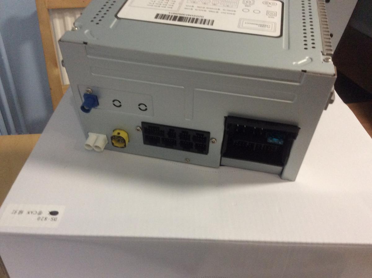

this rear view of unit might help people

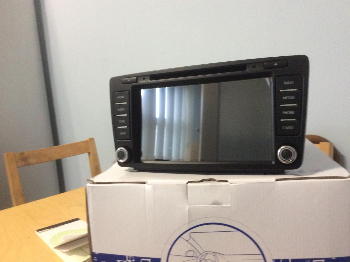

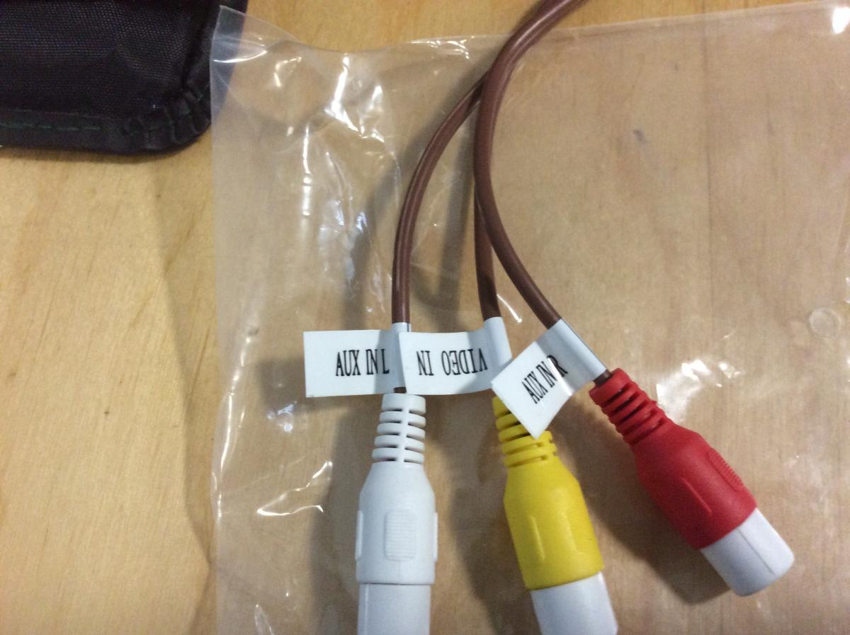

Ds820 arrived today so took a few pictures before I installed it,
Now done installation once I found the English settings it only took about 15 minutes to set up.
All I need to do now is install the reversing camera,post-144753-0-78168800-1477484907_thumb.jpgpost-144753-0-56541600-1477484928_thumb.jpgpost-144753-0-80005300-1477484944_thumb.jpgpost-144753-0-67924200-1477484976_thumb.jpgpost-144753-0-54172600-1477484989_thumb.jpgpost-144753-0-54172600-1477484989_thumb.jpg
All I need to do now is install the reversing camera,attachicon.gifIMG_0520.JPGattachicon.gifIMG_0524.JPGattachicon.gifIMG_0528.JPGattachicon.gifIMG_0530.JPGattachicon.gifIMG_0527.JPGattachicon.gifIMG_0527.JPG
cracking looking screen. Look forward to seeing it installed and running
Sound quality is real good phone book set up straight forward as said before just need to fit reversing camera.
Really happy with this head unit so far
