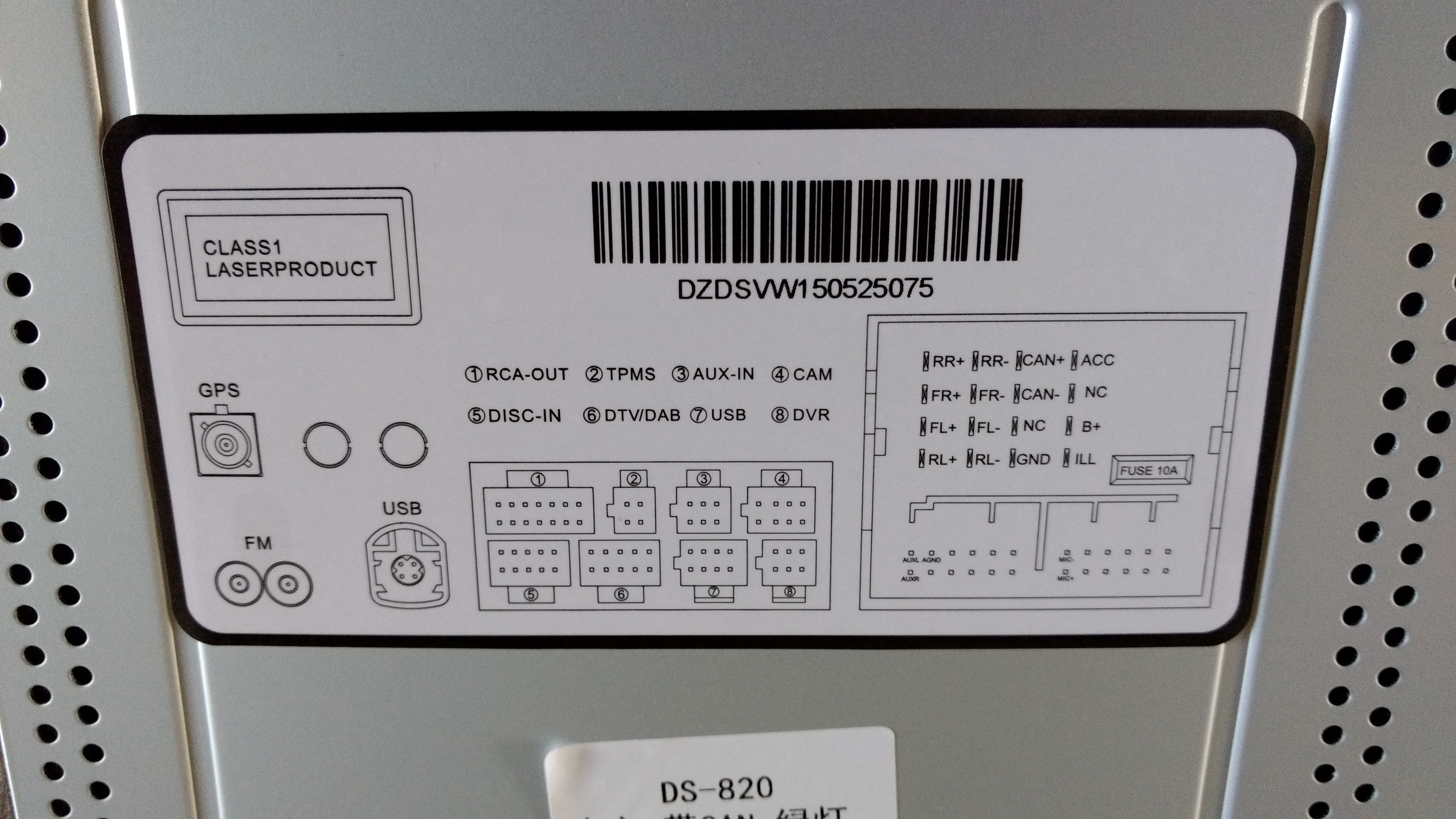

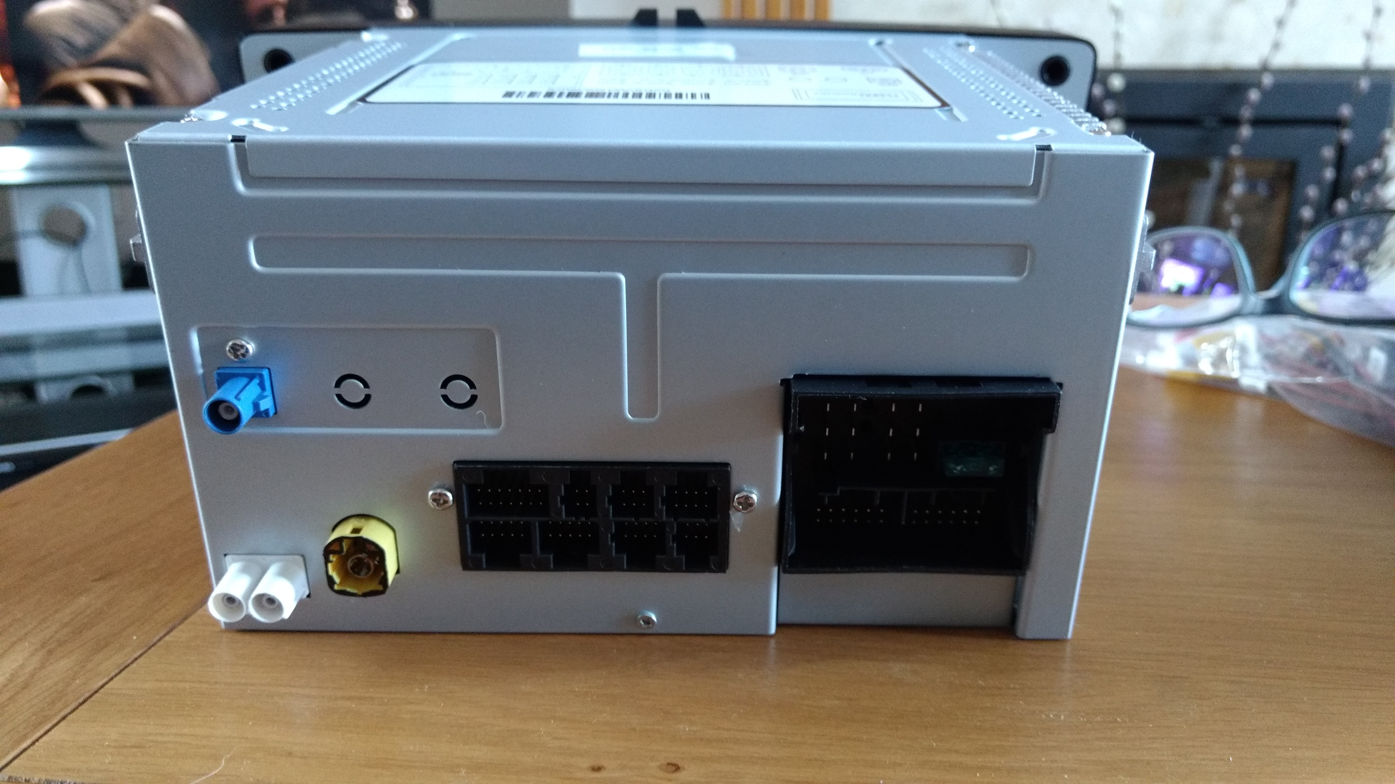

Hi All,
I purchased this one from juan27 and was just wanting to know what fakra adaptor is needed.  Long time since i upgraded from a stream to bolero in a previous car.  I see on the back of the 820 its a double socket.  Do i need to get a single to double fakra adaptor?  Also i emailed icebox about a mic but didn't get a response.  Any ideas on where i can source one?
Thanks in advance.
1 hour ago, bestyuk said:
Hi All,
Thanks in advance.
Hi maybe try ringing Icebox? They are quite slow to respond to emails, but you are asking to buy something?
Gave them a call, they didn't "think" they sold the external mic and didn't know if the vag mic would fit.  Didn't know about Fakra connector either so i guess i will have to take it out and then order any bits after rather than having it all ready.

There are some on ebay, but I don't know where it plugs in and hence what the connector should look like.
On 5/8/2016 at 08:25, deemack said:
The microphone was supplied by Rob in Icebox Auto along with the DS820 head unit. It's a tenner and consists of a rectangular block microphone with an electrical connection which clip into the relevant sockets in the overhead light and a long cable which is routed via the headliner and pillar then behind the dash to the big block connection on the back of the radio. It just clips in, can only go one way.
I don't have MFSW but I do have full maxidot.
From reading posts on other forums I gather only some functions of the MSFW work but can't recall which.
Its six years since I've seen the back of my Bolero, but I'm pretty sure the aerial connector looked like the one on the DS-820.

Yeah it's exactly the same.
This is good news.  I have a mic in the post so should be good to go.
Thanks for the info.
