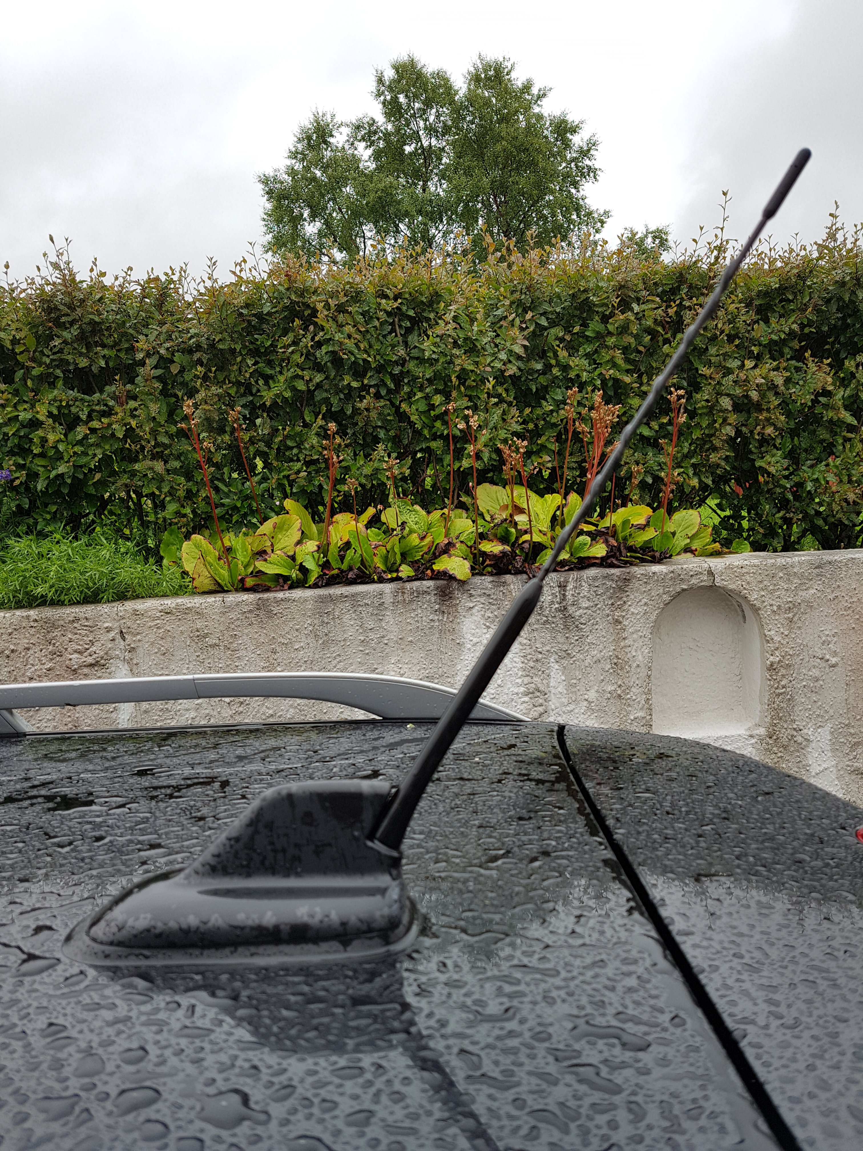

Bad reception on the DAB+
Does anyone know if it is possible to use the original gps antenna on the roof? And is it possible to replace the FM antenna that is colocated with the gps antenna with a original DAB+ antenna?
