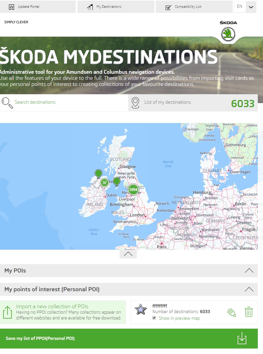

I have been trying for some time to try and get Skoda to sort out their MyDestinations website so that the POI installer actually works.
Most recently Skoda claimed it wasn't their problem because the data for updates and POI's is not provided by them, it is provided by a company called HERE and their website is www.navigation.com.
Having contacted HERE, and having gone on to their navigation.com website, you can see that they provide the data but they insist, and I think they are correct, that the Skoda website is provided by Skoda, not HERE.
I have gone back to Skoda customer service and will update this forum in due course.
In the meantime if others could help by emailing [email protected] to also complain about the POI problem it might help a lot.
Has anyone managed to load a KML file into the Skoda My Destinations website?
http://mydestination.skoda-auto.com/POIs
I have attached a file I just created with Google Earth. When I try to import it to the Skoda POI site I get an error page:
