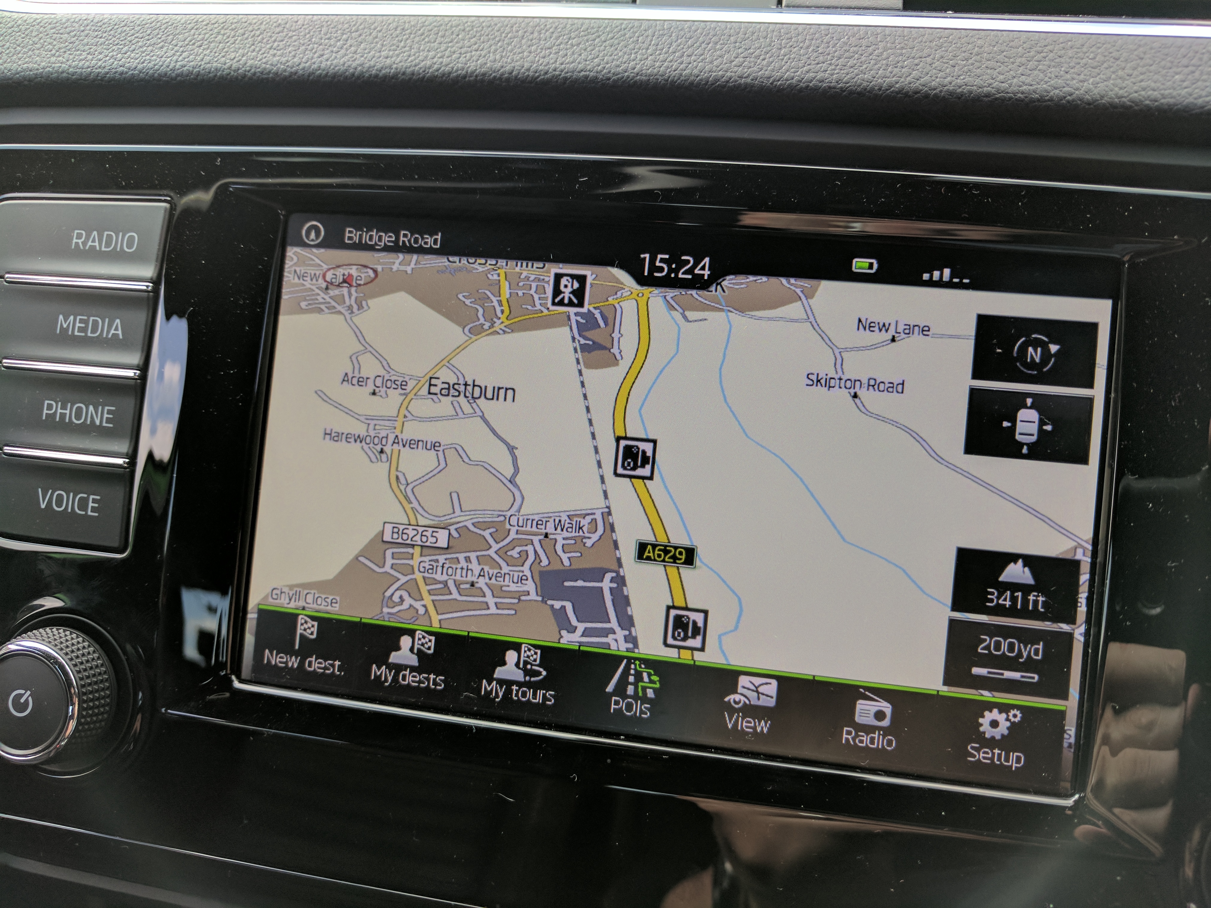

I've been playing with getting Camera locations working also; managed to get it running (using the VW utility in German and the PocketGPSWorld CSV database)...
If anyone needs a guide i'd be happy to put one together.

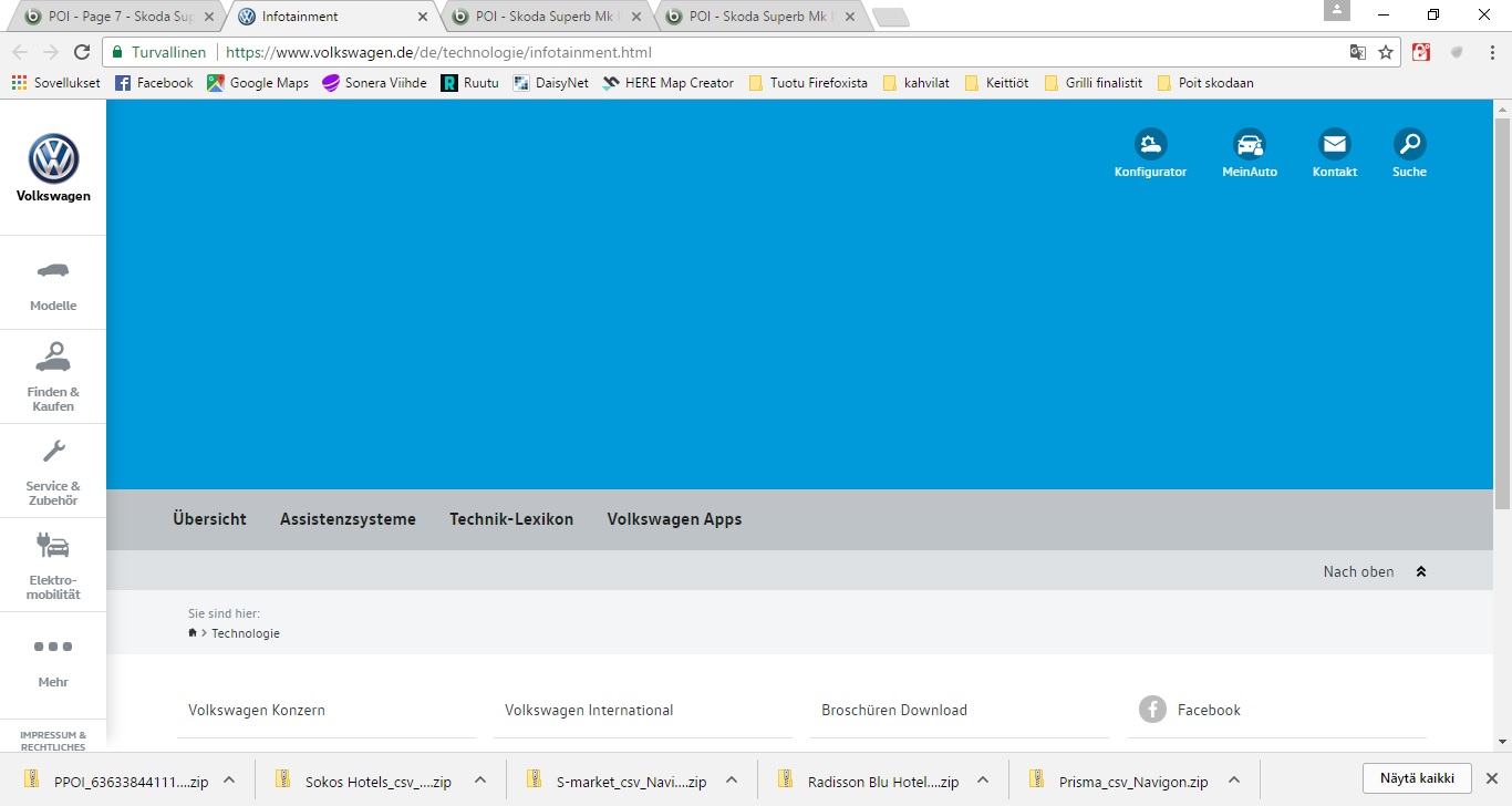

Hi,
I get this worked earlier this year but now I can't find that VW converting site. Those links won't work anymore.
Is it now working through Skoda converting site?

On 12/05/2017 at 11:02, Rainmaker said:
Guys there's already a step by step guide by BillyJim on the first page of the thread... or am I missing something? You just need to substitute the text file generated by the German VW site for the older working version, uploaded by Rifleman here.
GeorgeB, did you try to do that now?
As I told I have done that earlier (on January) but now if I use that link VW POI site, that POI generator isn't there anymore (I go to site which you can see in attachment).
I know that it worked earlier fine but now it seems to me that  .
So does someone no if it has moved to othere destination or what?
Maybe I'm only one who has this problem if you can use it normally.
I made a thread recently about that Pete. It came back again but now it's broken once more. I sent Skoda an email about their own site being broken, and included the server error logs. They replied to say there's nothing wrong with it but if it happened again to email back with a copy of the error.
Perhaps if everyone in this thread tries to use the Skoda my destinations site and sends a complaint and a copy of the server error log they may actually fix it for us. It's ridiculous we spend all this money then have to resort to using a sister company's German website for basic functionality.
