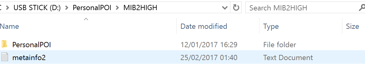

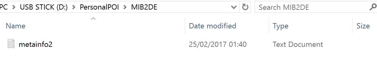

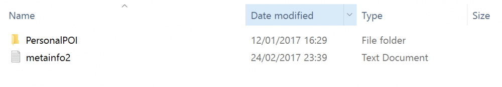

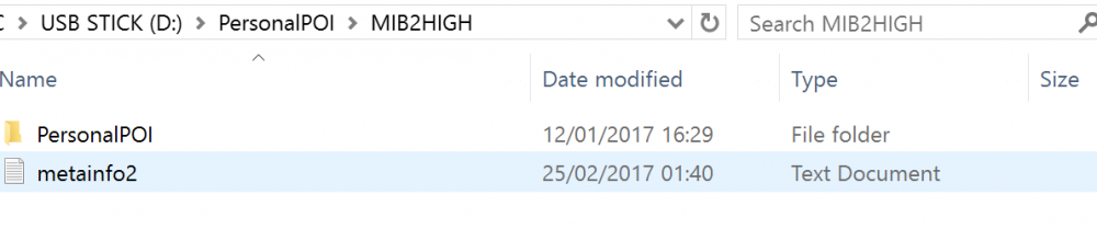

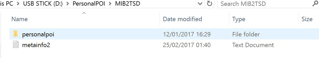

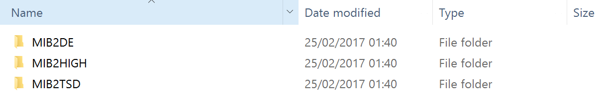

Hi POI gurus - I've followed the various instructions in this thread to create a USB drive with 7 sets of POI (6 from PocketGPSworld, plus the free speed cams from POI Plaza). All were downloaded and then put through the VW POI site in ASC format. I've now got a USB with a 'PersonalPOI' folder and the metainfo2 file in the top level. I replaced the created metainfo2 with the one provided in this thread.
But when I try to update the sat nav in the car, it says no update is found. I now notice that within the top level PersonalPOI folder there are 3 more folders, each of which has its own metainfo2 file. Do I also need to replace each of these metainfo2 files with the version provided in this thread??
Edited by Mon55
No, just replacing the single file in the root folder works for me.
Hmm, I'm not sure what is wrong in that case. I'm right in thinking it should work fine using a USB stick in the AUX USB slot in the phone box (ie rather than an SD card)?
Personally I have only used an SD card.
You should have Personal POI in the root folder and within Personal POI should reside
MIB2DE
MIB2HIGH
MIB2TSD
Also in the root folder should be
metainfo2.txt (the old version)
In my case I left the metainfo2.txt files which were installed by the VW site within the MIB files without there being any problem.
Edited by Hozz
Yep, that's how I've always done it. Something must have gone wrong with your conversion or in writing them to USB. Just start again and see how you get on. Make sure there are no other files on the USB and you follow all the steps for converting them on VW's site.
I've now found an old SD card in that odds and sods drawer, and it has worked straight away without any issues. So it seemed to not like my Sanddisk USB stick for whatever reason.
