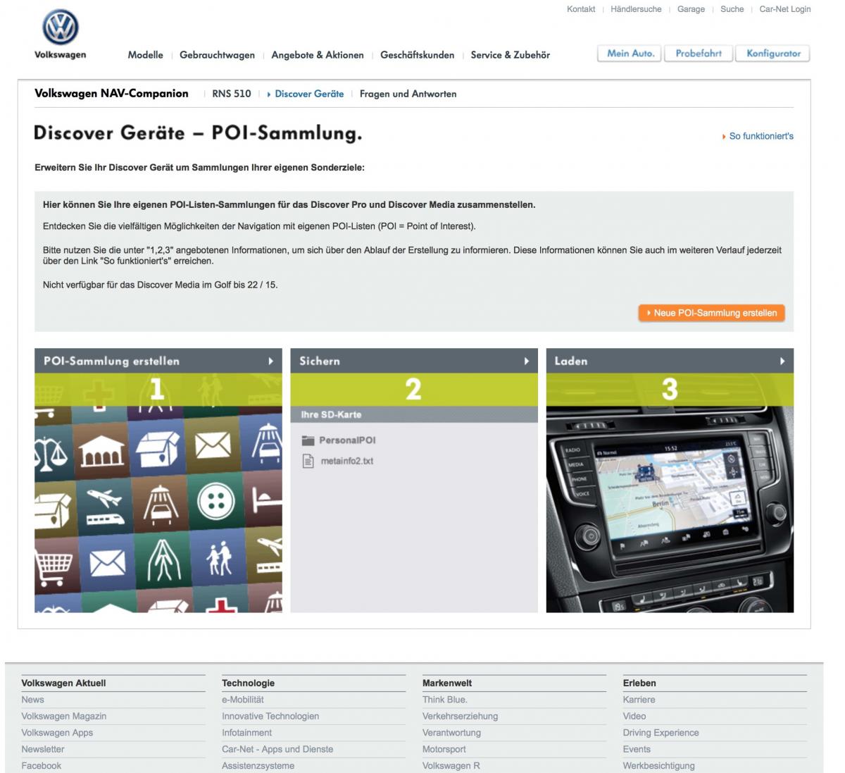

Well I have finally cracked it with no thanks to Skoda.
Basically the Skoda MyDestinations POI website does not load the correct files.
The solution is to go to the VW Discover Pro website
http://www.volkswagen.de/de/navigation/discover-pro/poi-listen-sammlung.html
However having downloaded and unzipped the file it produces you must only copy the
metainfo2.txt and PersonalPOI files to an SD card.
Then follow the manual for loading the POI's into the navigation system.

Thanks for the explanation. The first bit is where iam falling foul. When i click on the link there is no add new poi in orange. It just looks like a german vw sales site. Is it because i am opening it on android and not wundows based laotop? I will give it a try on a laptop.
The screen should look like this, with the orange button on the right (screen grab is from a Mac)...
The 1, 2, 3, sections at the bottom are guides (in German).
