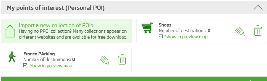

post-28131-0-92102200-1461441269_thumb.pngI've followed the instructions above using the VW site to import a few sets of POIs which I created in Google Earth and saved as .kmz files.
Using the German VW site everything worked fine and I now have all of my custom POIs in the Columbus.
I decided to try the Skoda My Destinations site to do the same thing but it doesn't work.
It imports each of the POI sets, let's me name them and attach a jpg picture. When I press the import button my POIs appear in the list BUT it shows zero destinations in the set.
These are exactly the same .kmz files that I imported using the VW site so why do they work there but not in Skoda My Destinations ??

attachicon.gifCapture.PNGI've followed the instructions above using the VW site to import a few sets of POIs which I created in Google Earth and saved as .kmz files.
The Skoda My Destinations site is, unfortunately, next to useless for POI.
I get a SQL Database error no matter which type of POI file I upload.
The ability to create your own POIs on the site is also poor. I painstakingly created a POI database with the addresses of friends and family across the continent, complete with GPS-embedded metadata photos.
Everything looked great until I loaded it into the Columbus.
Half the images don't show their thumbnails and many of them are not even pointing to the correct location, sometimes not even the correct country, and the same applies to the vCards it creates.
Skoda UK have been made aware of the issues, but until it's fixed I recommend you use the site only for map and firmware updates and not for POI.
