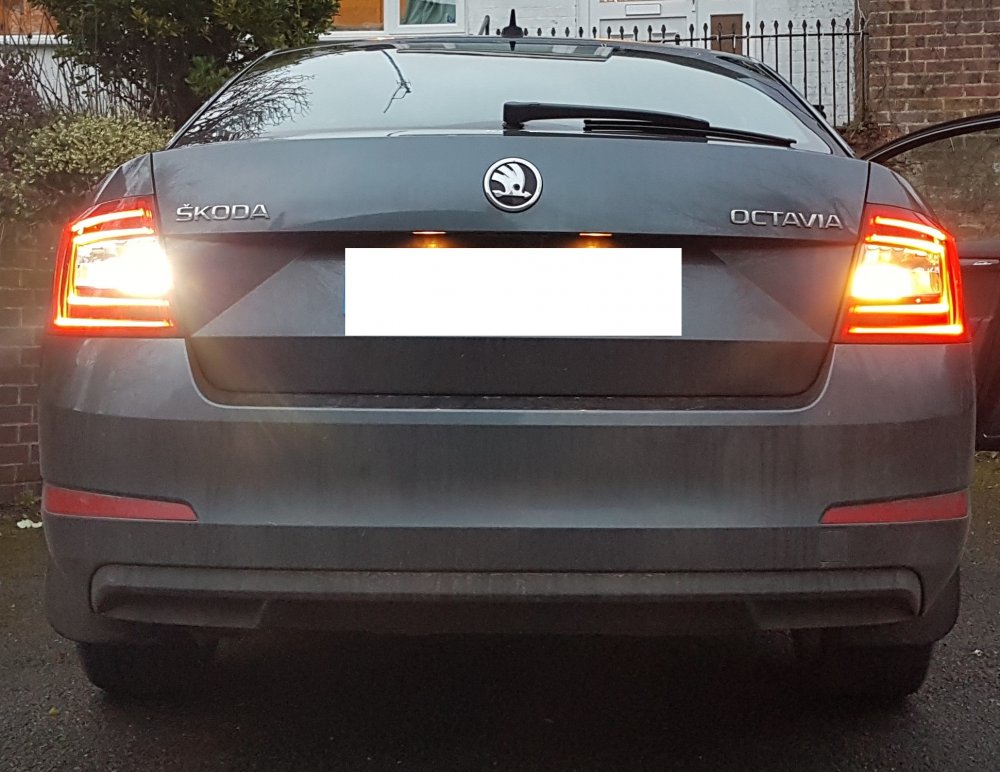

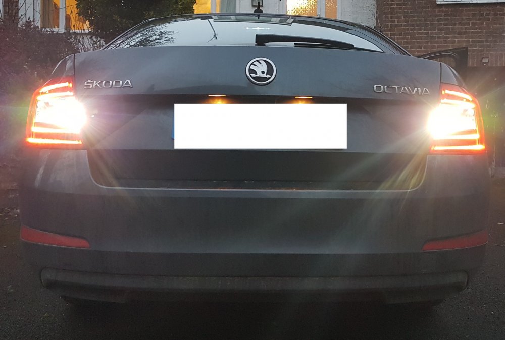

Hopefully there is a picture of the Car system LEDs installed on our Style Combi. Excuse the dirt on the rear, it hasn't been washed in over a week.

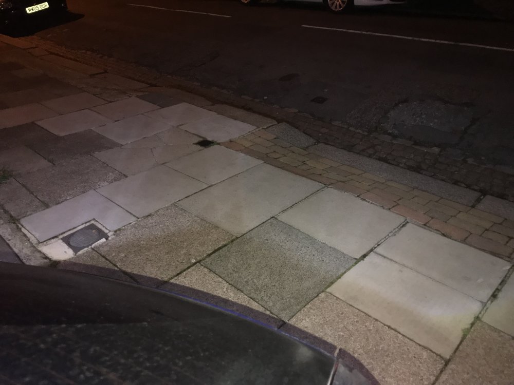

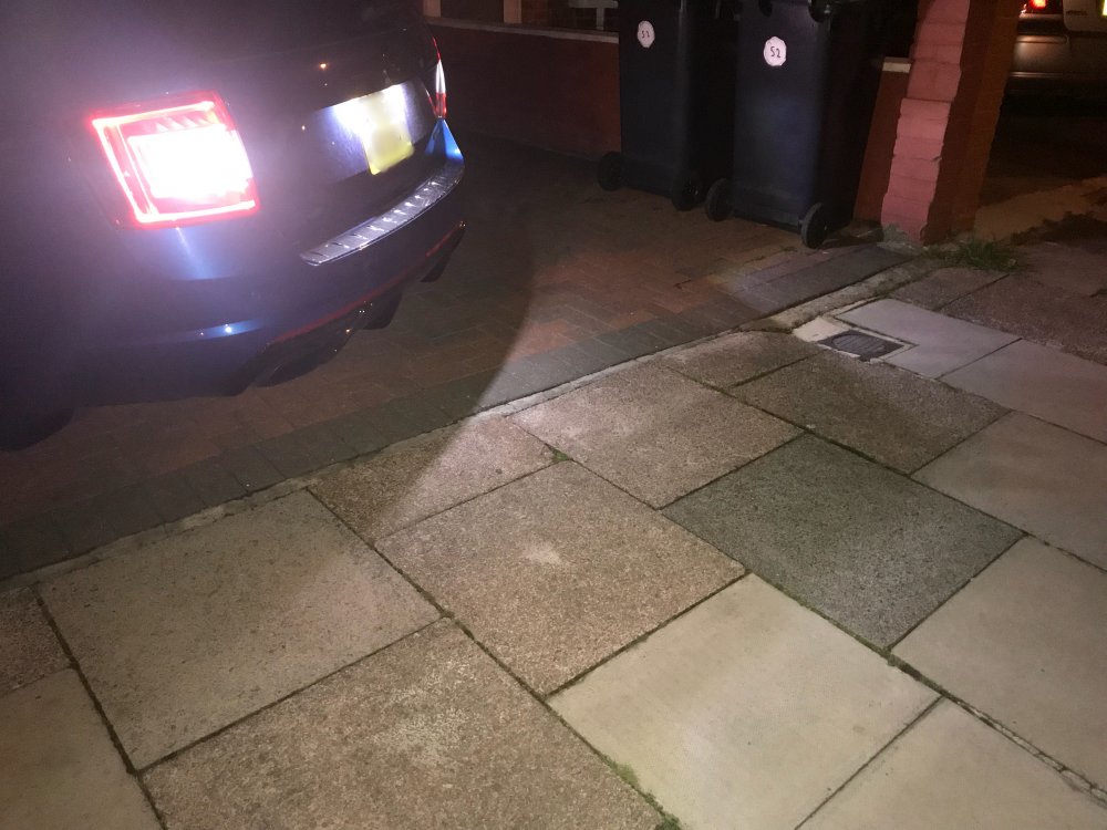

  • Hi all,   just put the same reversing bulbs as recomended look to be much brighter, I found a little dab of lube on the pegs made the light pop in very easy. I have attached some pics t
  • I have these: http://www.aliexpress.com/item/HotSale-2pcs-lot-super-brightness-High-Power-1156-led-30W-CREE-XBD-p21w-led-ba15s-Reverse/2036956876.html Cheaper, no bulb out error (did not need VCDS co
  • Nice one for the info I just brought them from Aliexpress I used my debit card that has hardly any money in that account, I transfer funds to that account (exact amount) that way I know my card has
They look good would just need someone to code them for me

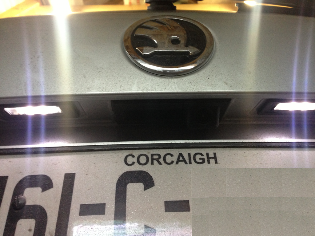

2 pictures showing the sidelights with the 36smd T10 LED bulb :)
...and an 'illegal bright' one sided T10 LED bulb only for trunk lights (too bright for other purposes).
Additional heat shrink tube is needed because of the bulb holder design.
