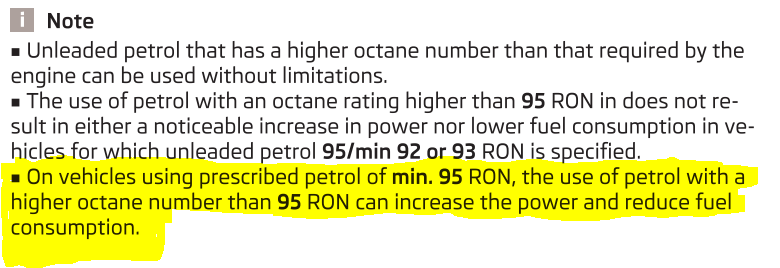

  • The Skoda manual says that "Min 95 RON" means that you can use 95 RON without harming the engine [nb: this is EU law for all petrol vehicles], but that it will return better economy and produce more p

It says 95 RON on the fuel flap and I much prefer to follow manufacturers advice. They do much more research than a few owners doing fill ups at various filling stations.

Does the 1.4 TSI say '95 (min 91)' or 'minimum 95 RON'? There's a difference, and Skoda say that cars saying 'min 95' will perform better on 98+ but cars saying 95 (min 91) won't.
My Leon say 95 min and that is exactly what I have always fed it. The car runs absolutely perfectly in all conditions but I suppose in a lab at max rpm/load it may run better on 98 RON. But since I drive in the real world rarely exceeding 4000 rpm or more than 1/2 throttle any benefits that 98 RON may have would never be spotted.

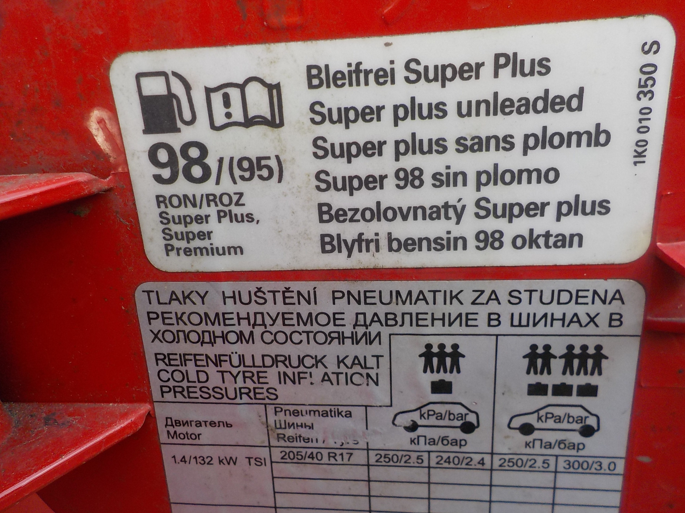

No UK Filling stations sell 98 ron Super at the pumps currently so you just have to go with 97 ron minimum or 99 ron minimum.
http://volkswagen.co.uk/need-help/owners/Fuel
& not just VW GTI / R engines,
ones used in Skoda, SEAT & Audi like the Euro 5 emission 1.4 TSI 132-136 kW Twinchargers. (177-185 bhp)

Skoda (the 'manufacturer we should listen to', in your words) say 98+ RON is best for these engines. You can choose to follow that or not. Who cares? That's about all there is to it either way.

Skoda say 98+ RON is best for these engines. You can choose to follow that or not. Who cares? That's about all there is to it either way.
I will post next Wednesday when I get the car but if the fuel flap says the same as the brochure I have in front of me then its Min 95 RON or Min 91 RON. No mention of 98 RON at all. But it does say that using low octane fuel (presumably the 91 RON) will affect engine performance. Irrelevant in the UK since 95 RON is as low as it goes.

Don't have a manual, have a brochure. Superb 1.4 TSi 150 PS arrives next Wednesday to replace the Leon 1.4 TSI 140 PS have have owned and run for almost 4 years on 95 RON petrol.
If the fuel flap says 98 RON then I will have to search our some fuel but if as expected (reading the brochure) its 95 RON then its business as usual.
