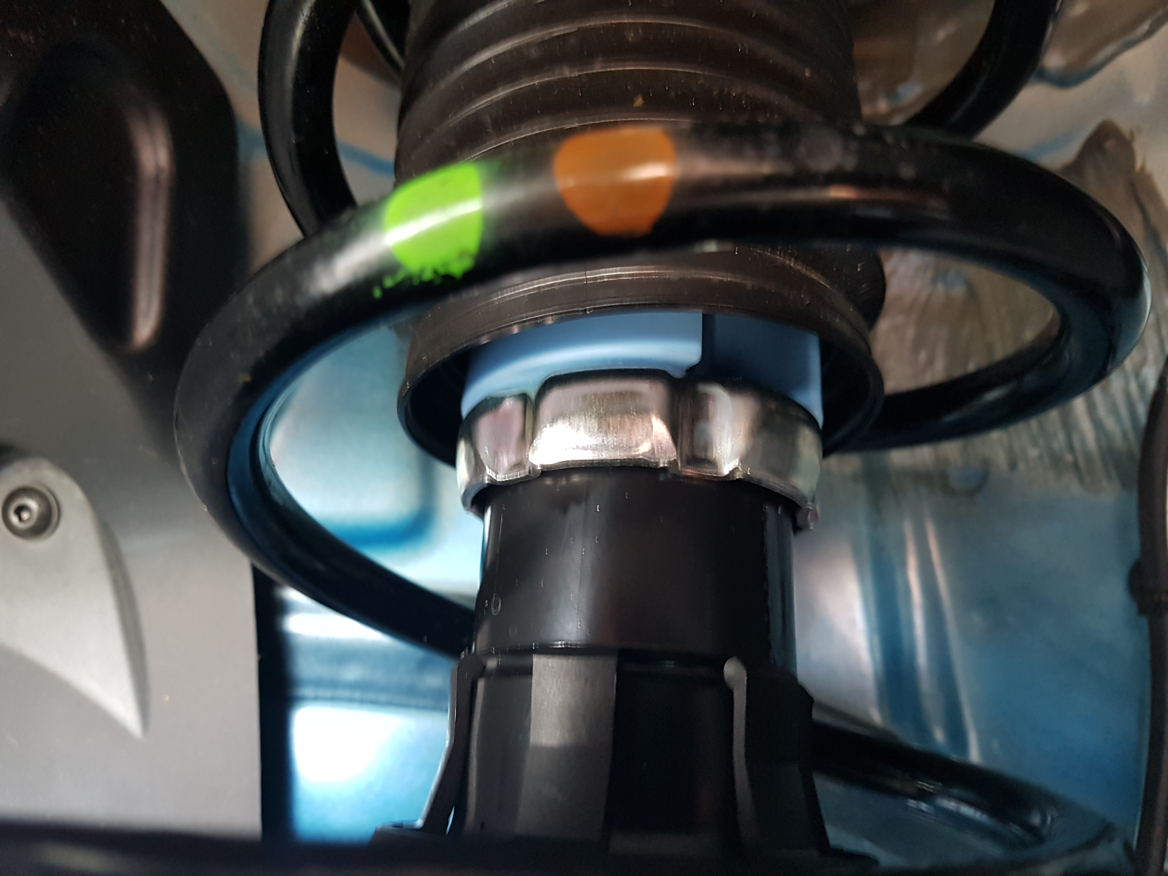

Sorry to bump up an old thread but my FL VRS had blocks left in on the offside front. This led to a jarring ride principally over potholes and it took me 100 miles to work out something was wrong and ask on here. The telltale sign of them only being on one side was that it went over speed bumps in a very strange way!
Dealer's service manager couldnt quite believe it especially as they are bright blue. There was even a label saying 'PDI OK' on the key! I'm not going to name the dealer as they have been very reasonable in response but I would urge anyone who thinks the suspension on their car is harsher than expected, to jack it up and have a look. This is what you will see if they have been left in.

On my 2013 model which I bought in 2015,  I thought the ride was harsh but put that down to the big wheels and low profile tyres. After reading about transport blocks on this forum I jacked mine up and was staggered to find 2 blocks on each side so the suspension travel was reduced by about 3". When I removed them the ride was transformed. The dealer was very embarrassed when I showed them, as they had done the original PDI (my car was ex-demo) and had sold the same car twice, firstly to the original buyer and then to me. In all those checks they did not notice the blocks.
