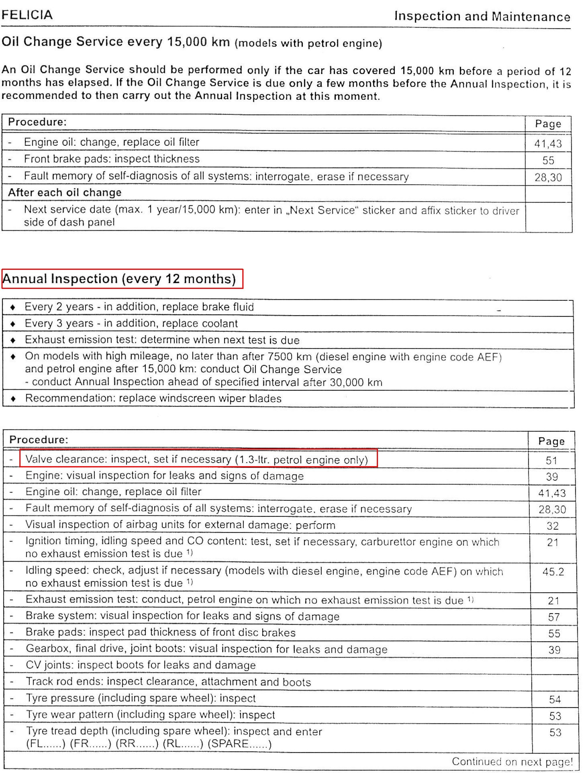

I’m currently planning a 4500km road trip with the felicia. And I’m thinking if I should check the valve adjustments or just go after the moto " don't touch it if it works".
When should this job be done?
I’m also curious about why should the air temperature be below 20 degrees, when adjusting the valves?
Thanks.
Edited by nimbus
@nimbus :-
  1. Given your circumstances, will the engine pass the next mileage valve adjustment interval before your return? If so, then I'd certainly do the valve adjustment before leaving.
  2. You are aware that metal expands when it gets hotter? I think that the air temperature is probably "best practice" rather than a mandatory requirement, given that the engine was installed in cars sold to nations where daytime temperature would be above 20C for several months at a time.
Skoda manual says "room temperature and engine cold (about 20°C)". This is for convenience. It is a standard, fairly easy achievable air temperature, that happens to be right in the middle of our comfort zone.
OHO, well then it's time to check them 😅
Thanks
