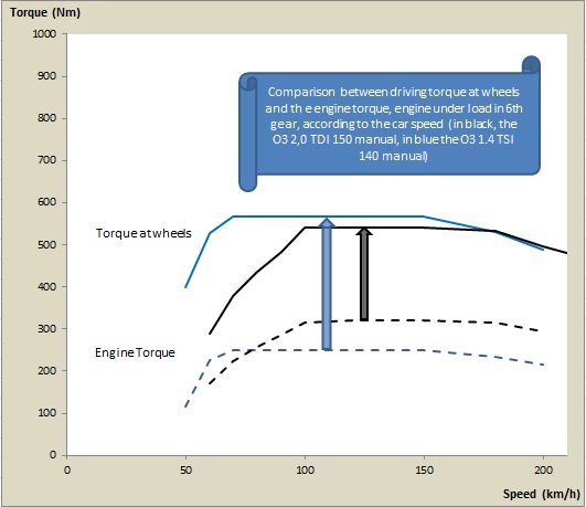

Torque and power curves are easy to get. As well as the transmission ratios of the gearboxes.
Probably to sustain a comparable top speed, and reduce fuel consumption on highways, the 2.0 TDI 150 is equipped with very long 5th and 6th gears (meaning short multiplicative ratios).
As a consequence, with its more suitable gearbox, the 1.4 TSI delivers higher torque to the wheels on 5th and 6th gears, and from very lower speed, and without screaming in high revs.
In fact the petrol engine will behave like a diesel, while the 2.0 TDI will often require to shift down in same conditions (e.g. go to 5th below 100kph, or in 4th below 90kph)..
This was the 140 bhp 1.4. I gues the 150 bhp is a bit better.
So, very little between the engines according to those curves, about 4% difference max. Probably not even noticeable to most people.
