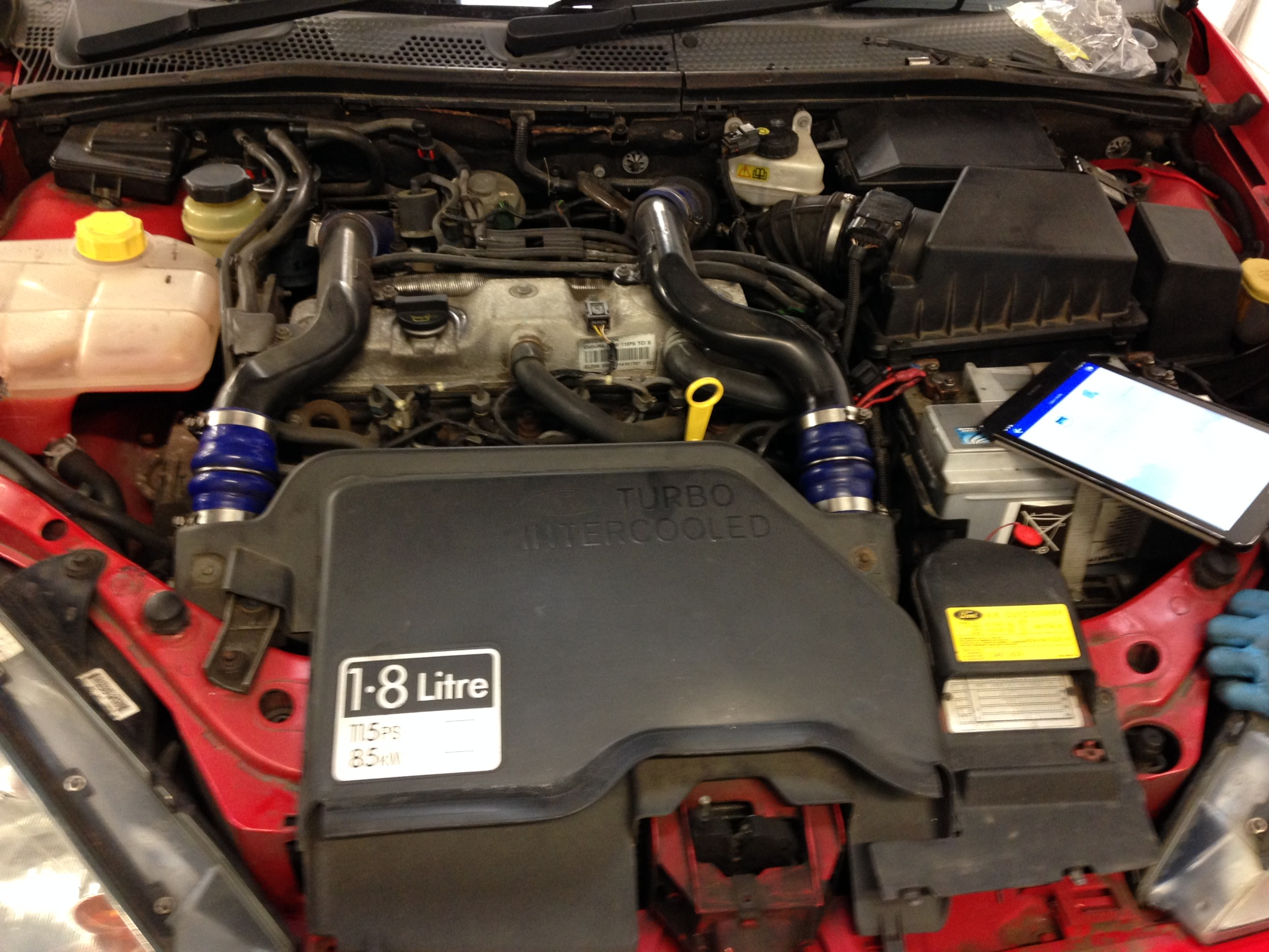

Just an update on my cars and cgon unit.
I have had a cgon unit fitted today to our old Ford Focus 1.8 tdci Zetec which we have owned from new.
It is 15 years old, has done 118K miles and had an egr blanking plate fitted 6 years ago.
It is of an age that it does not have a dpf fitted but does have a cat and it is the original exhaust system as fitted at the factory.
Car was manufactured in Saarlouis, Germany,  delivered November 2002
It's been a solid and reliable car that does over 50mpg average.

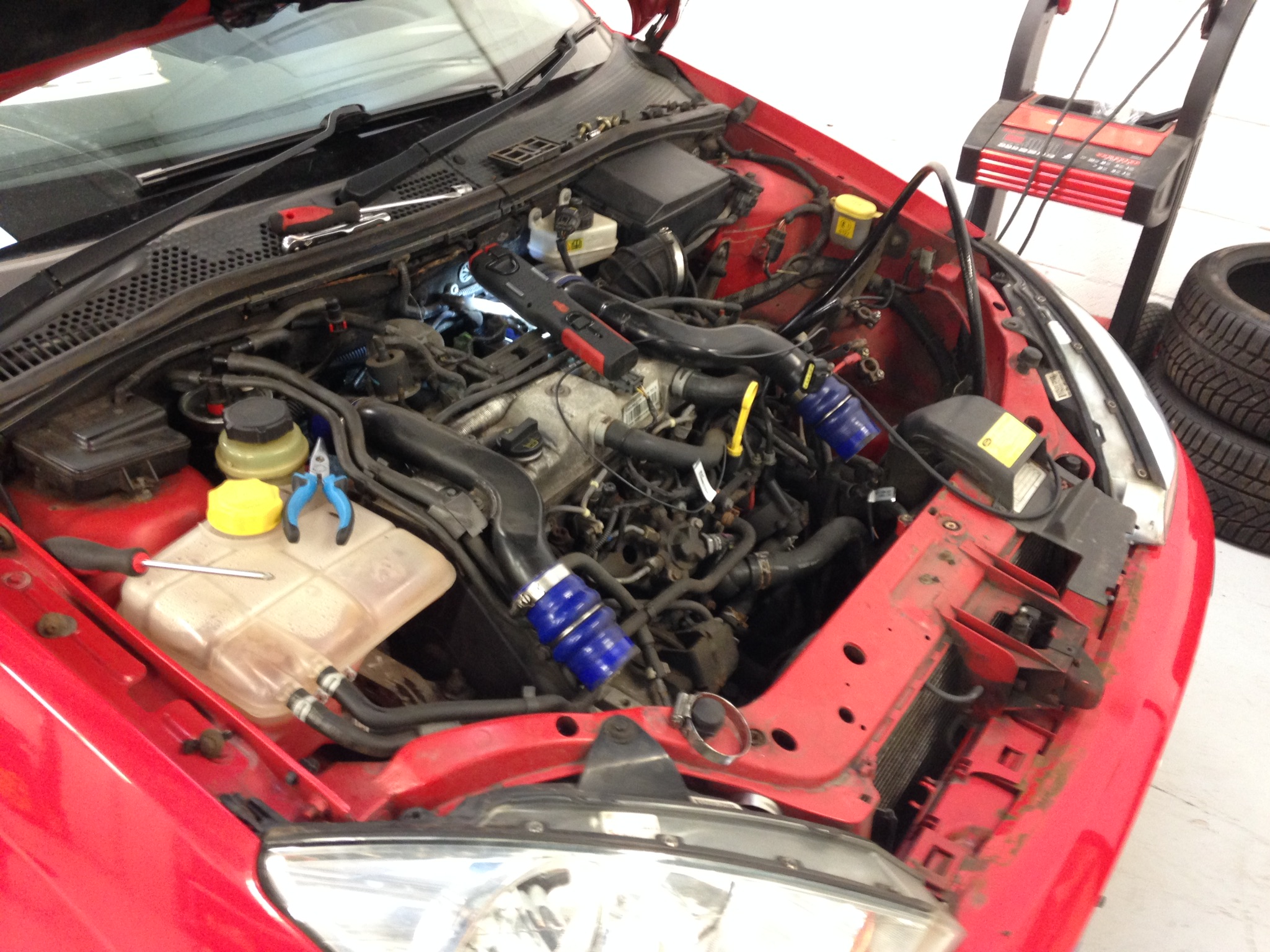

It was fitted at a local tuning company in Banbury (Angel Tuning) who have just become installers.
One of the them was having their own vehicle fitted today (big V6 Audi) which regular does runs to Germany and back.
As they are primarily a tuning remapping outfit they do not have MOT emissions testing (which is a shame as I wanted to see some before and after info).
I have some basic pics of the install which I have attached fyi.

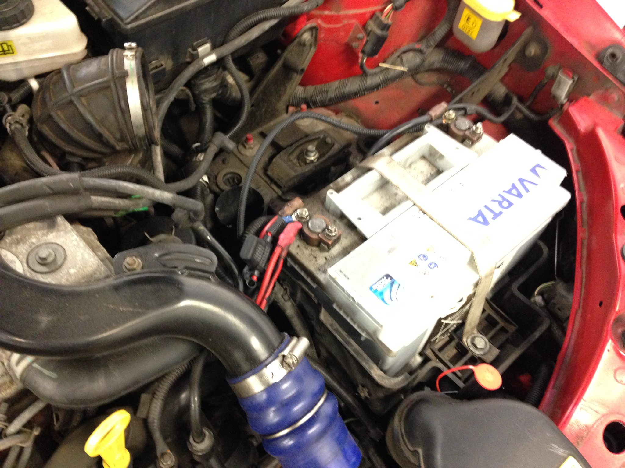

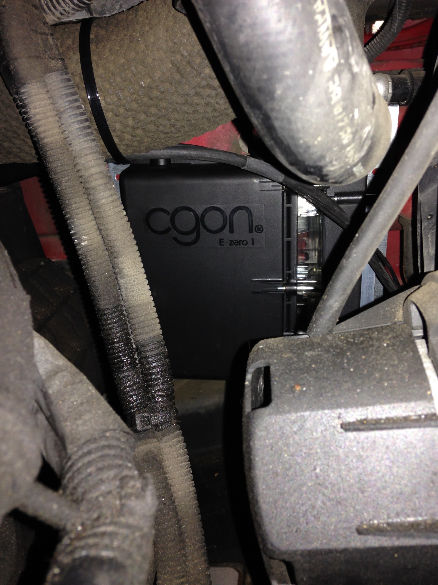

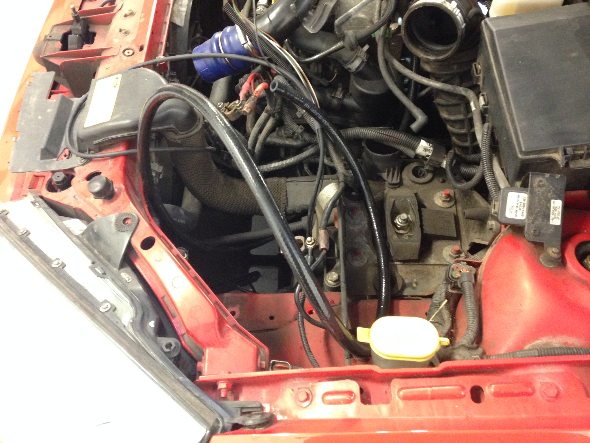

Best place for this fitment was beneath the battery tray as surprisingly little space in this older engine bay.
Really neat install, with everything hidden and neatly and professionally done.
Some customers like it this way, other want it visible apparently.
If it gets transferred to another vehicle, then blanking plugs are supplied to bung the hole just after the maf sensor in the inlet pipe.
A wire is connected to the map sensor as part of the install. Used for info on engine running etc.

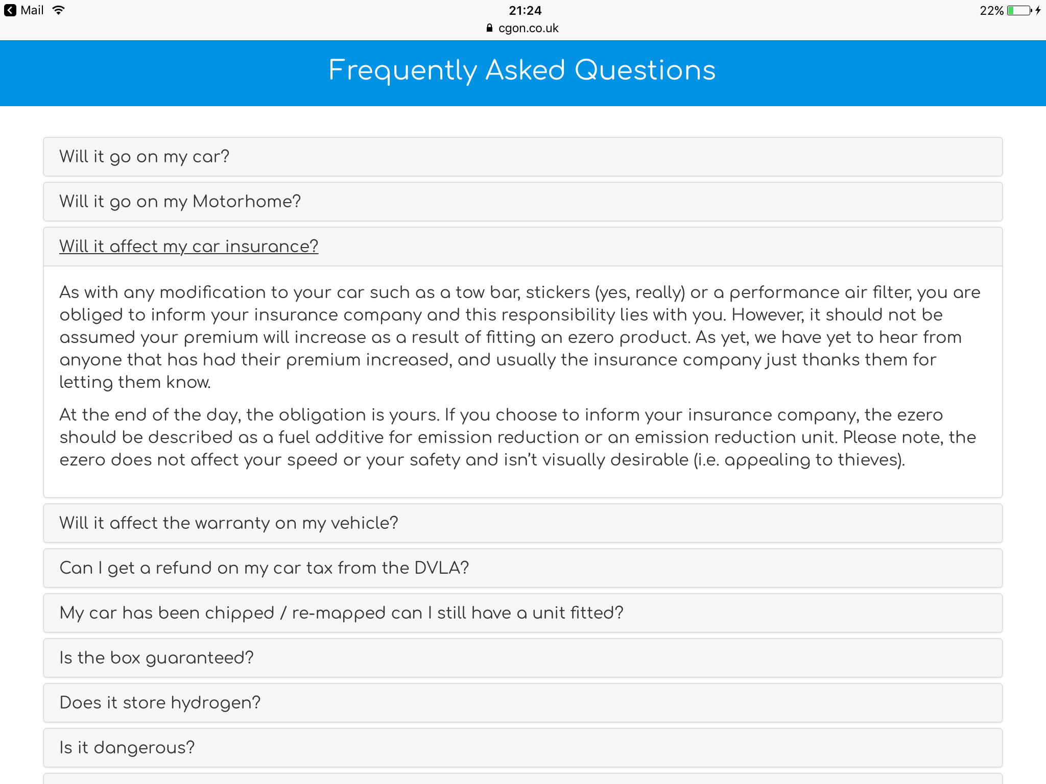

1 hour ago, Wino said:
presumably CGON encourage adopters to inform their insurance company????
I told my insurance company no increased premiums.. but I have heard some May charge £15-20
Thanks, but that doesn't quite answer my question. Do CGON advise people who have this fitted to tell their insurance company? It may be on their website I guess, but with first-hand experience you could save me looking.
Here is a pic from there site..
  • Sponsor
Thanks, presumably your installer referred to this or reminded you in case you hadn't seen it? Who was your installer again?
