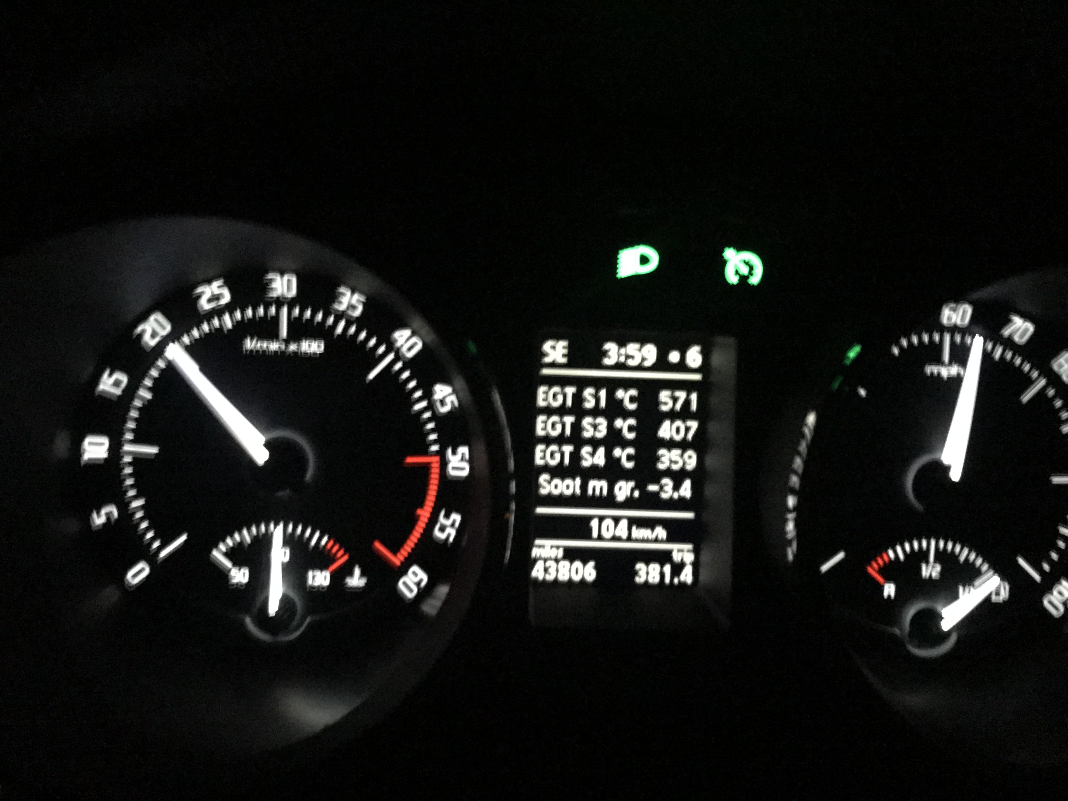

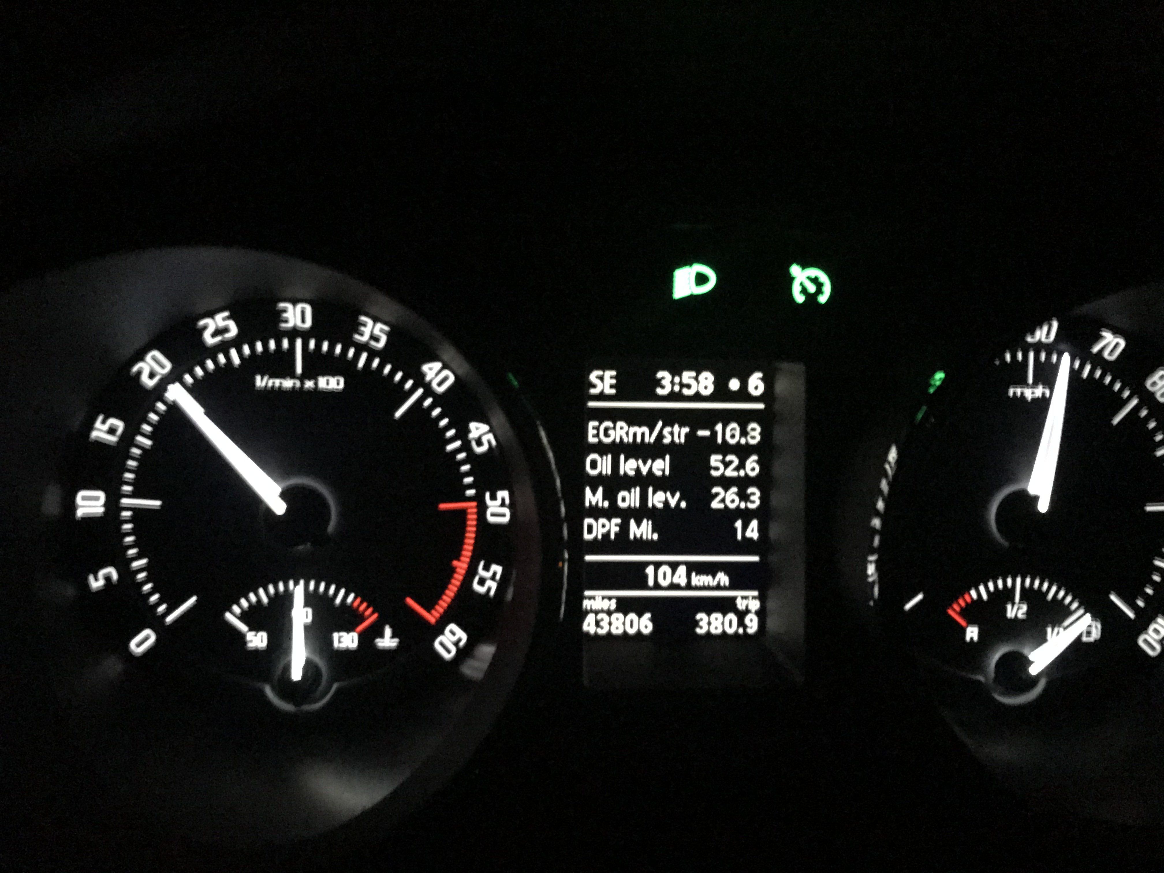

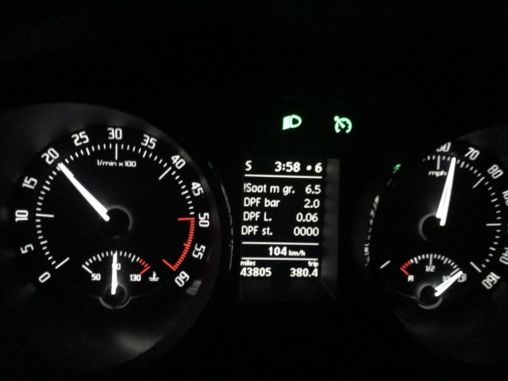

I think the factory should have some sort of display for DPF, the car has the information already, you could fit an Autopolar interface to access it if you were that bothered.
