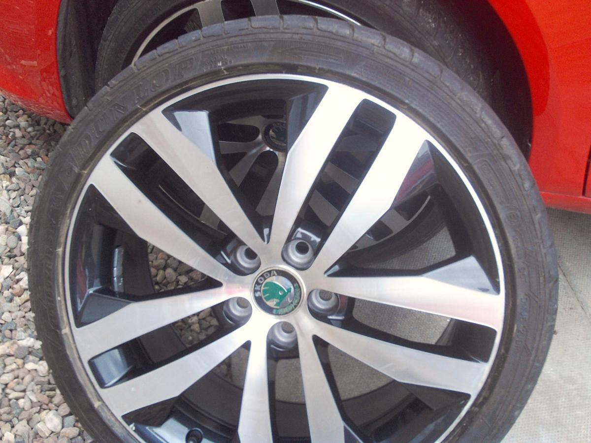

I have to say I had 205/40 R17's on mine when I picked it up but the sidewalls looked very small and it pulled to the left, last week I got some 2nd hand alloys that came with winter tyres that are the same size 205/40 R17's but the side wall looks thicker and I have to say the car doesn't pull to the left anywhere near as bad and the ride is also much better, less harsh/crashy

Yeh swapped the tyres over Front to Back
Popped 2 steel wheels on the front today!!!
Still had the pull to the left stumped any other suggestions
