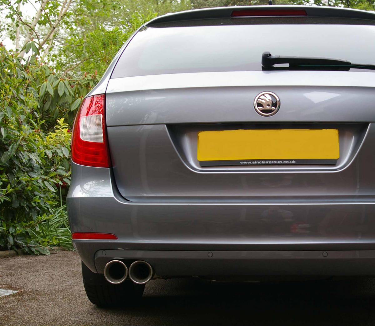

I've de-badged my Superb TSi. Just used a hair dryer on a warm still day (you could do just as well in a garage) and heated up the badges. After a minute or two I used an old credit/store card to lift the edge up the badges and slowly peeled them off. Try not to scrape at the badges or you'll get marks in the lacquer. After all the badges were off I cleaned up any 'shadow' of the badge glue with a rag and meths, then lightly T-cut and polished the areas. Now you cannot tell where the badges were. It took about 40 mins to do all the boot badges.
If you want to remove the bonnet 'nose' badge and central boot badge look up on You Tube as there are some good videos. Basically use a credit/store card to gently slide under the plastic and they come off easily with a bit of care. Don't use a screw driver!! Good luck.
Sounds good, I want to remove my Greenline badge so will have to borrow the wife's hairdryer! Have you got any pictures with the badges removed?
Here's a rear shot and a close up.
Just make sure the badge gets really hot so that the glue is softened and de-bonds easily. Good luck.
Wow, good job!
