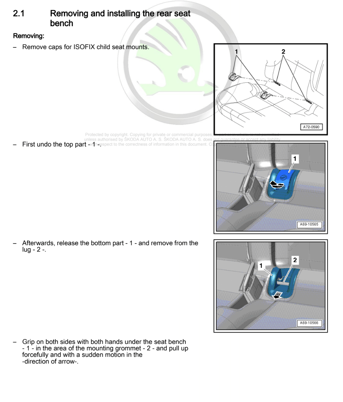

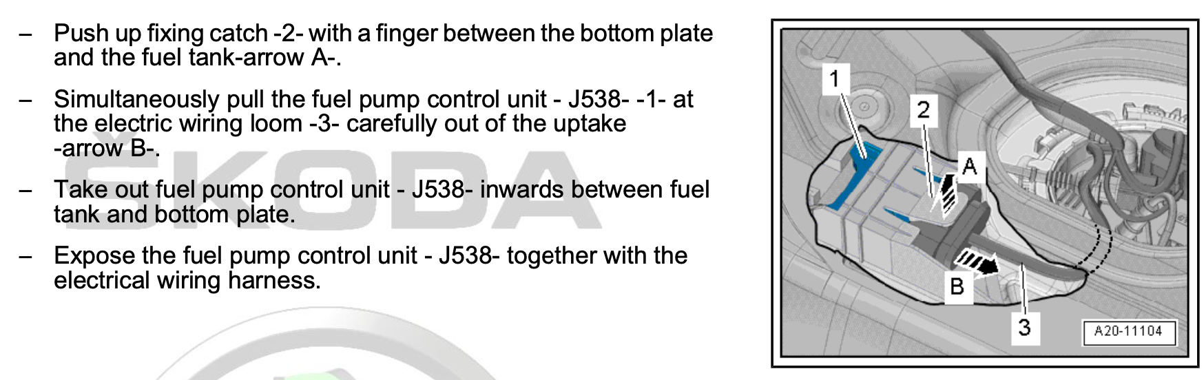

Okay so I've taken a look at my fuel pump control module and it is revision letter F, dated 12/07/2014. I've ordered one from a 2016 Passat with part no. 5Q0906121M and a date of 29/01/2016.
I've attached instructions below for removing rear seat bench and module:
Edited by jordy_wd
Spelling
