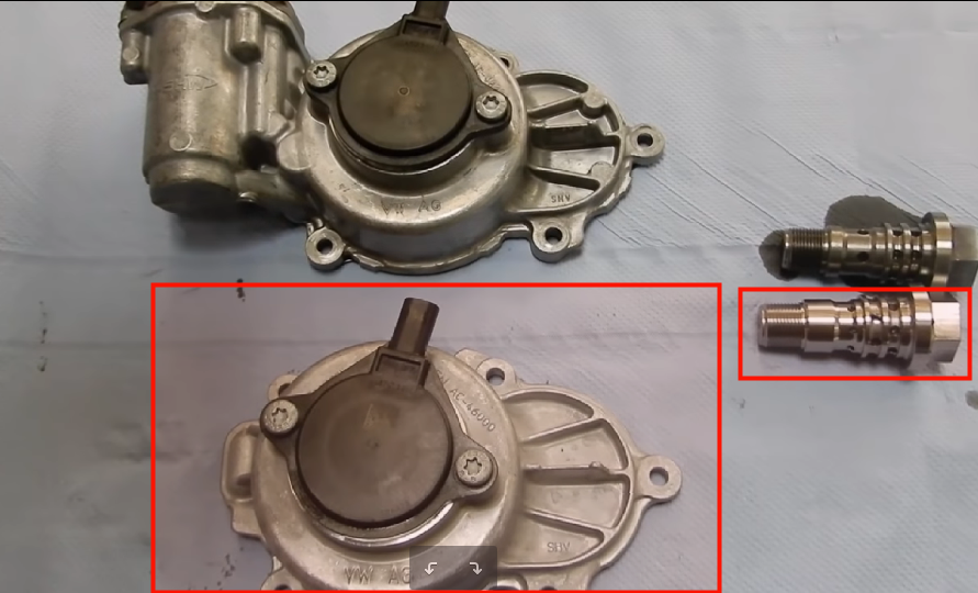

This video on youtube shows it could be a problem with the camshaft adjuster for the variable valve timing. Revised part numbers are:
03L 109 096B - body with the solenoid valve
03L 906 455C - bolt/valve assembly
From reading that thread though, there could be a number of issues:

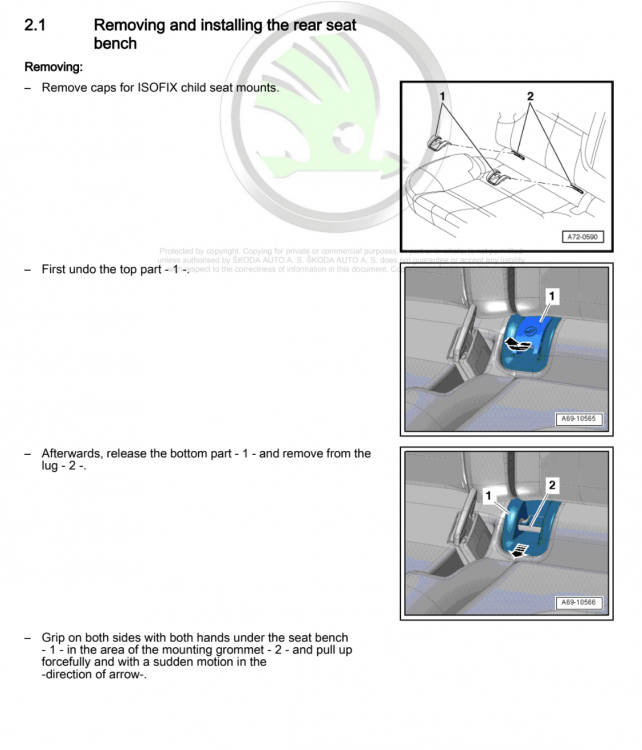

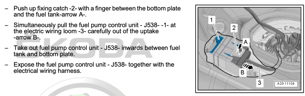

EDIT: In this thread regarding a MK7 GTD, it was the lift pump CONTROL UNIT that caused the issue:
http://www.vwaudiforum.co.uk/forum/showthread.php/175756-2014-GTD-Cold-Starting-Issue?p=1096231#post1096231
Part number is 5Q0906121. Most recent one from 2016/2017 seems to be 5Q0906121N
It also appears to be easily replaced. This for a TSI petrol but the diesel one will be similar:

I have an A3 8VA 2014 with the 2.0 TDI CUNA motor ( EA288 ) 135kw Diesel. The same motor as the GTD or your Skodas VRS TDIs.
I had the long coldstart issue some times and the error code:
P0341 - Camshaft Pos.Sensor Circ. Range/Performance Intermittent
So I replaced the VVT control Valve and the Housing as in the Video you posted: "Vw golf 2.0TDI EA288 long crank diagnose P0341/P0016/P0011"  https://youtu.be/DXvHdmq0reA
Its quite easy, you just have to block the Camshaft in TDC as in the Video (you can use the VW recommended block pin T10492) and replace then both parts. In the video they remove the battery, in my case with the air filter housing was enough.
The issue should be solved, VW did a totally new  VVT control Valve and a totally new solenoid housing without any accumulator (you can appreciate that in the Youtube video from DiagnoseDan I did a screenshoot, in red the new versions).
03L 109 096B - body with the solenoid valve 118€
03L 906 455C - bolt/valve assembly 70€
Both with tax 227€
In the last week the car started just fine, we have around 15 to 10 C outside but my car even startet some times wrong in summer, hopefully this will remain this summer and the next winter. I will inform you in some months.
Regards!

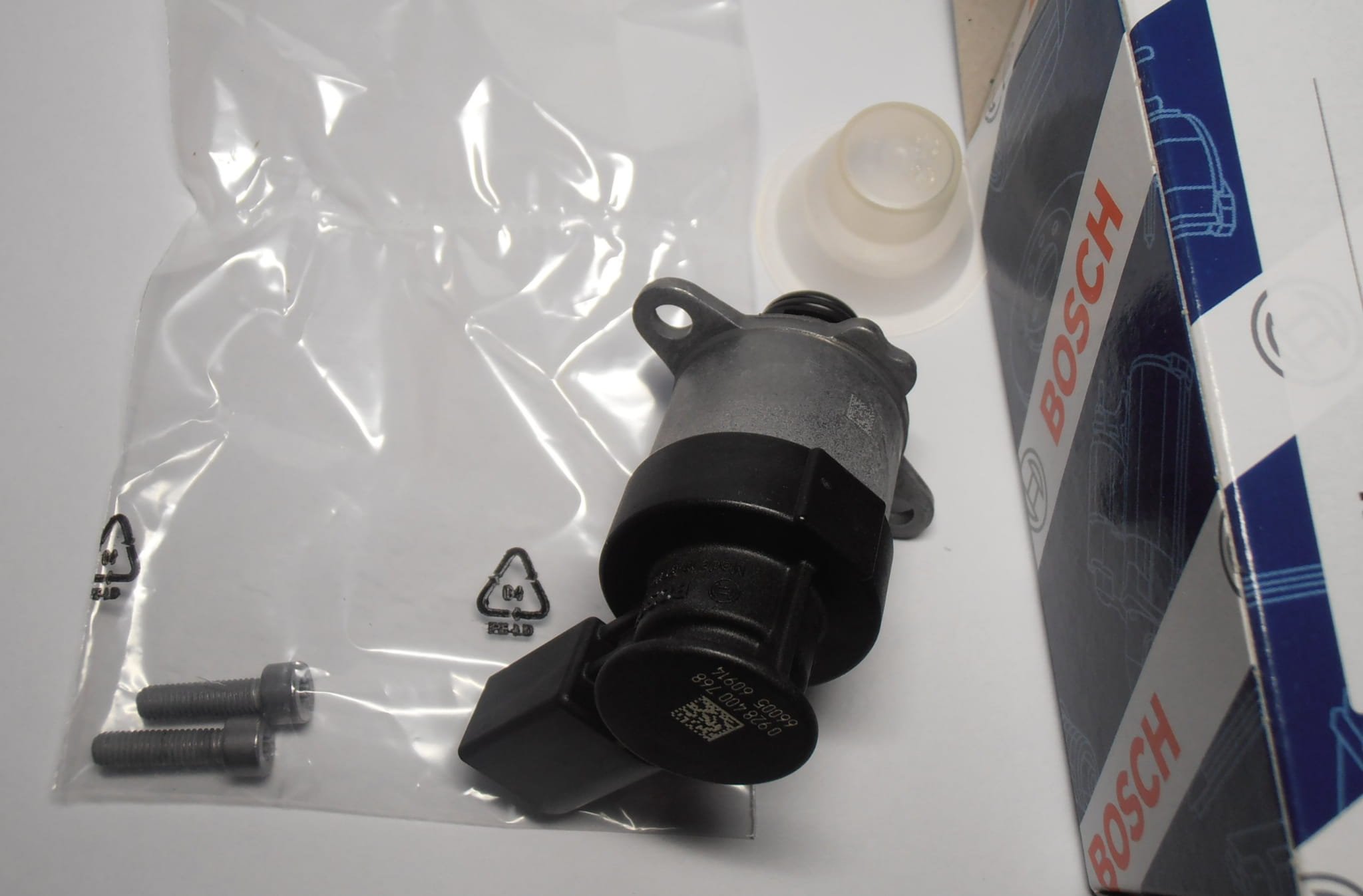

Hi! Did you find solution? I have Skoda Octavia III 2.0 TDI 184 PS, and still have problems with long cranking....One of the users on the other OctaviaRS forum says that you need to replace the fuel pressure valve on the pump (No. 0928400768). The defect of the valve is supposed to be mechanical and therefore does not cause errors ... What do you think?

If possible, check or preferably replace the fuel pressure valve on the CR pump (No. 0928400768 - new no. Bosch 1462C00987 ). The defect of the valve is supposed to be mechanical and therefore does not cause errors...Maybe this will fix the problem
