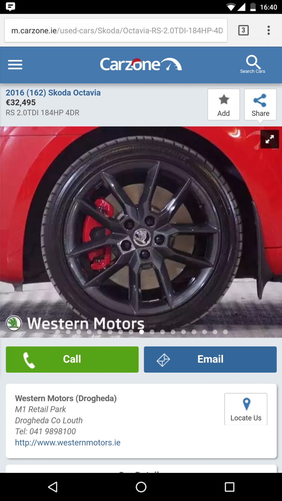

Looking at the 2 pictures you posted the White car looks to be on 19" wheels, ( Extremes ) and the blue car is on 18" wheels. ( Gemini )
The callipers look the same shape/size so i'm guessing they are both the 312 mm Discs
The Callipers on the 340mm discs aren't quite as curved as the ones in the 2 photo's
I'm open to correction but is the carrier not more rounded near the hub on the 19" extremes i.e 312mm yet on the Gemini 18" the carrier pretty much flat?
Here's another diesel RS, registered after July this year once again with the Gemini's 18" the carrier is flat near the hub.

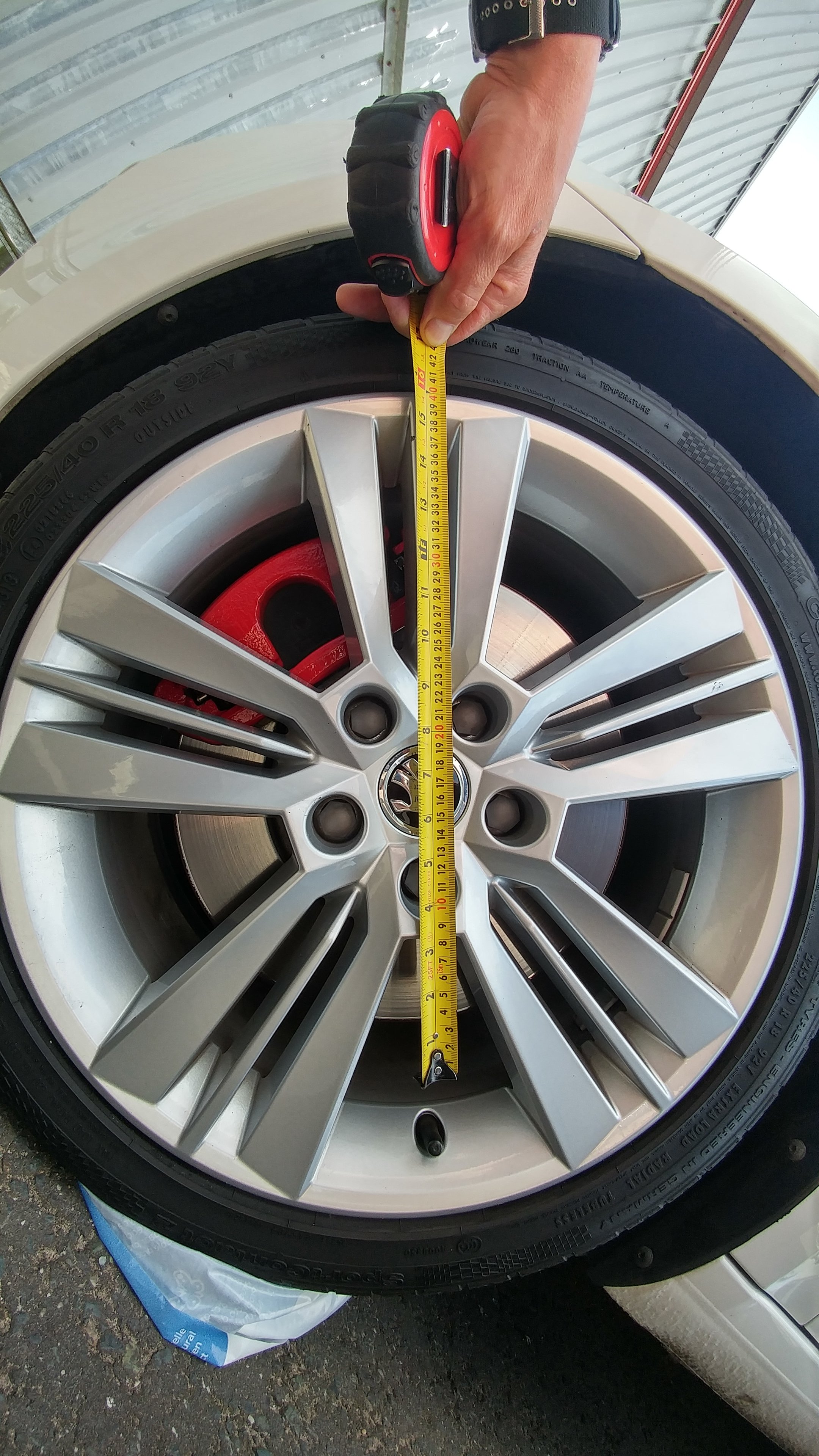

Cheers AG, I'll be checking over my new RS (diesel) tomorrow before it's registered for the road and I'll be taking photos as well as a tape measure to the brakes to see if mine is fitted with either the 340mm or 312mm, so can compare against one another.
So checked my car and it's fitted with the 312mm brakes. I don't mind as they feel very solid. Carrier is curved near the hub on the 312mm brakes.
