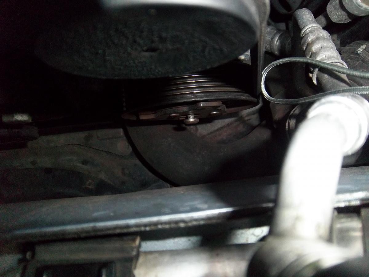

Got the same issue. Mine looks similar to the attached picture. But I cant really get to it...

The problem with a ratchet is that the centre shaft that the bolt screws in to will spin as well.
MATTVRS sorted mine for me with his 3/8" ratchet gun which gives an instant spurt of torque, tightening the bolt before the shaft gets chance to spin...worked for me :thumbup:
You need to remove the o/s/f wheel and wheelarch liner...watching MATTVRS do it, it only took 15 mins to do the whole job :clap:

Ok so I've managed to get some flexi torx extension but as you said the shaft spins with the screw so no joy here... will need someone with a gun as you suggest...thanks for your help.

Just an update. Finally got round to taking wheel and lining off. Bolt just kept spinning with but used a flat driver to leverage the clutch bit and it nipped up nicely. Cold air started immediately. 15 minute job
