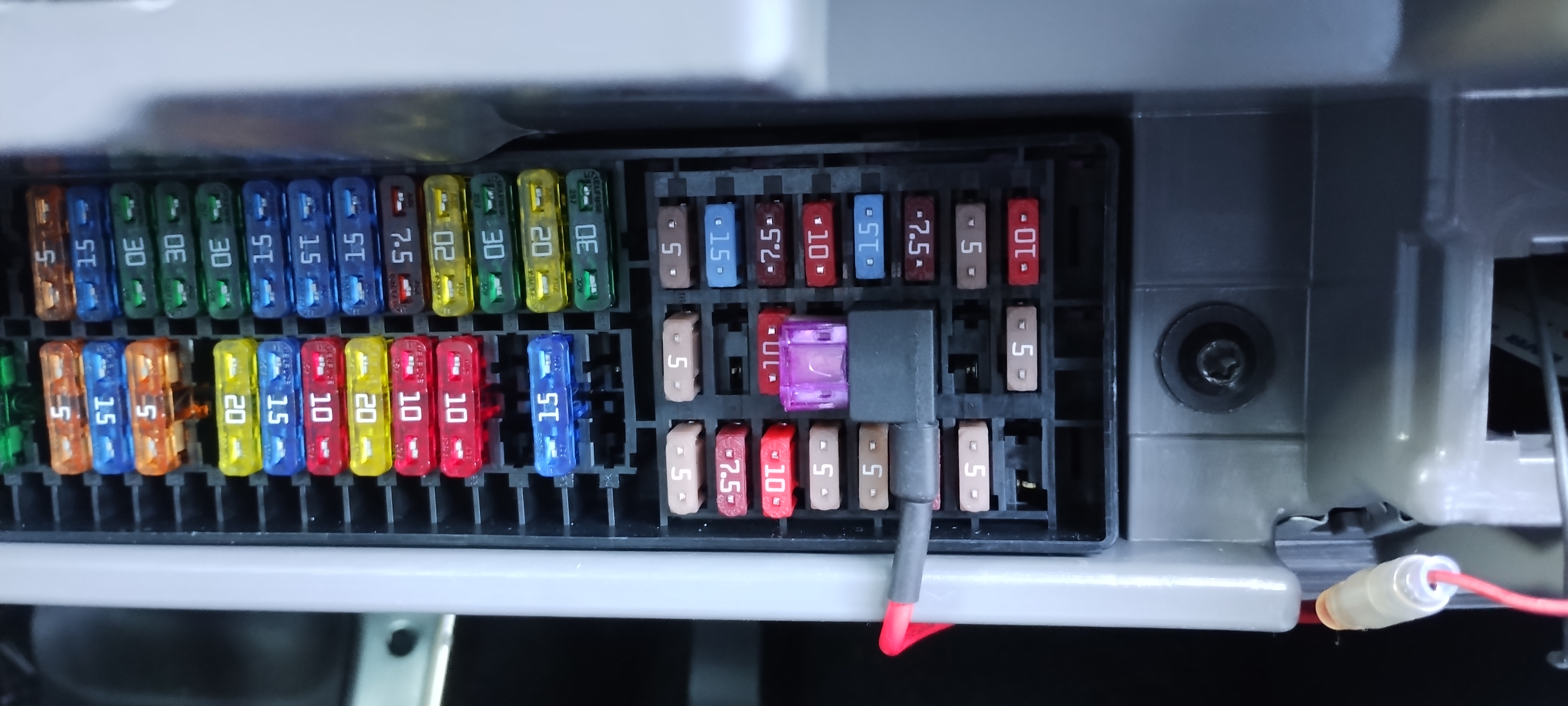

Did anyone have trouble trying to find a fuse that provided power?
I have a 2018 SEAT Toledo Xcellence (nee Rapid saloon) but I cannot for the life of me find a combo that illuminates the power supply on the Nextbase hardwire kit. Plus it has managed to throw a code and my airbag warning light is now on (as I had misread the fuse layout guide and used that fuse). Which I will now have to wait for my mechanic to get in touch for regarding deleting the code and hope the car turns happy once more.
Going to have one last try before I throw an epic paddy!
worst of it is, I spent 2 hours trying to locate a suitable supply on my SEAT, whereas it took all of 5minutes to wire up my wife’s Ford Galaxy, with the same pieces of kit.
I'll find out which fuse point I used and let you know. Got a Toledo too with the Nextbase hardwire kit although mine is the 2014 Toledo, shouldn't be much difference.
I'll find out which fuse point I used and let you know. Got a Toledo too with the Nextbase hardwire kit although mine is the 2014 toledo.
Edit...
Attached pic of position of my dash cam hardwired position. As shown in the pic position 11 remembering now  I used the door mirror control fuse to piggy back to. Perfect on and off with ignition, been installed like this for 3 years.👍
Edit...
Fab, thank you.
I managed it in the end, into the the rear passenger window fuse. There are some similarities between the fuse boxes, but the 2018 version has three different types of fuse / relays.
