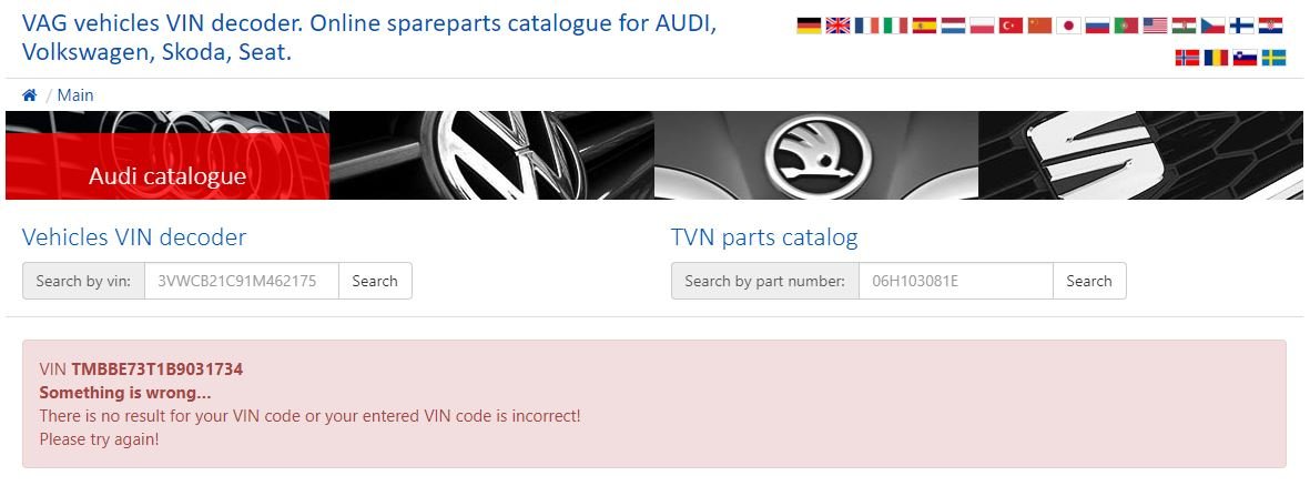

Just tried your link to find the correct front disc size on my CFFB (CR140) Superb, but it doesn't like my VIN (TMBBE73T1B9031734).
Any ideas what I'm doing wrong?
Given the not quite legitimate nature of these online catalogues, it's likely the VIN lookup is broken.
You'll need to know the PR code for your brakes. Easiest way to get it is buy an hour's access to Erwin and download the build list from there. You're looking for the 'Vehicle Specific Information'.

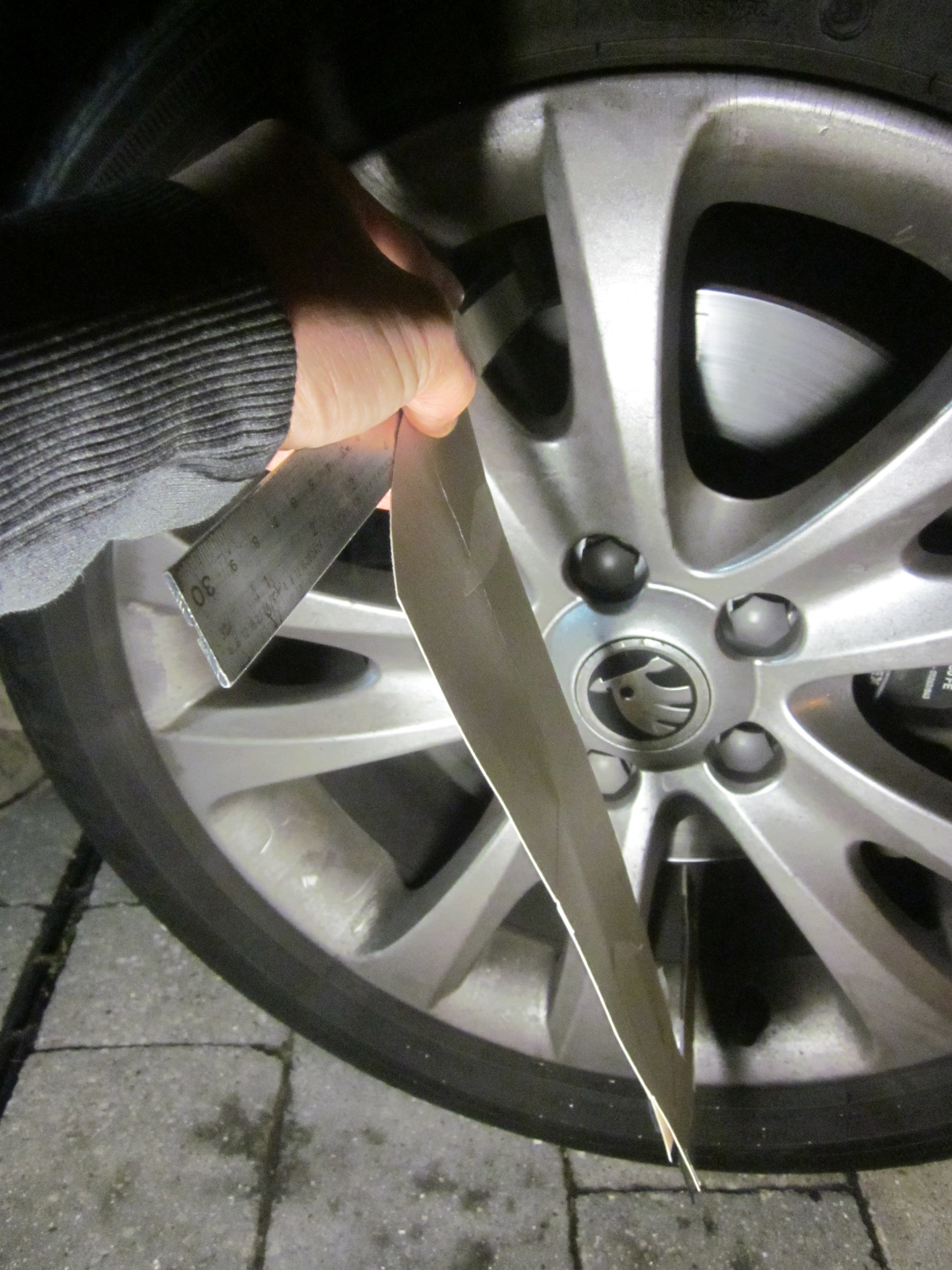

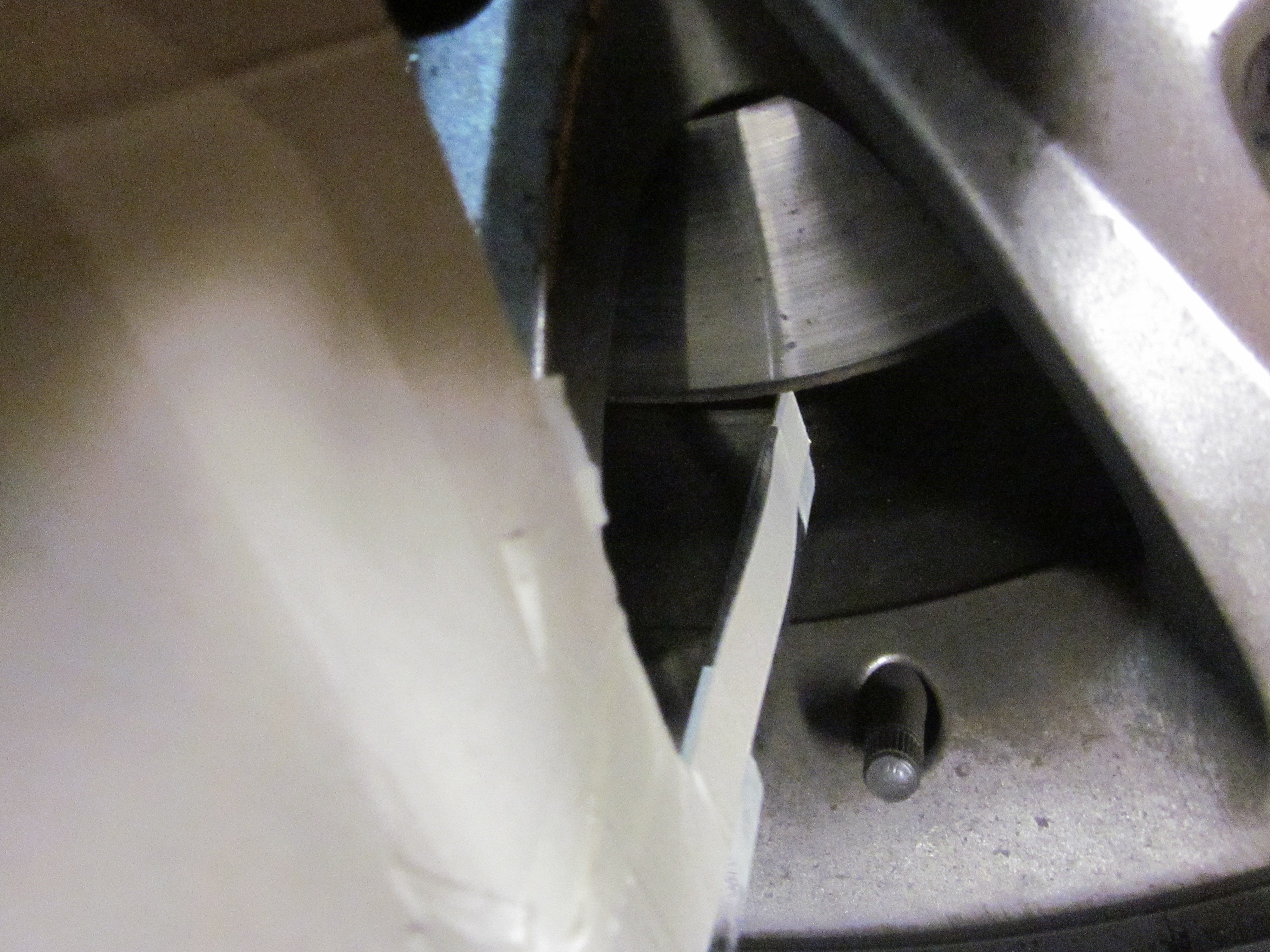

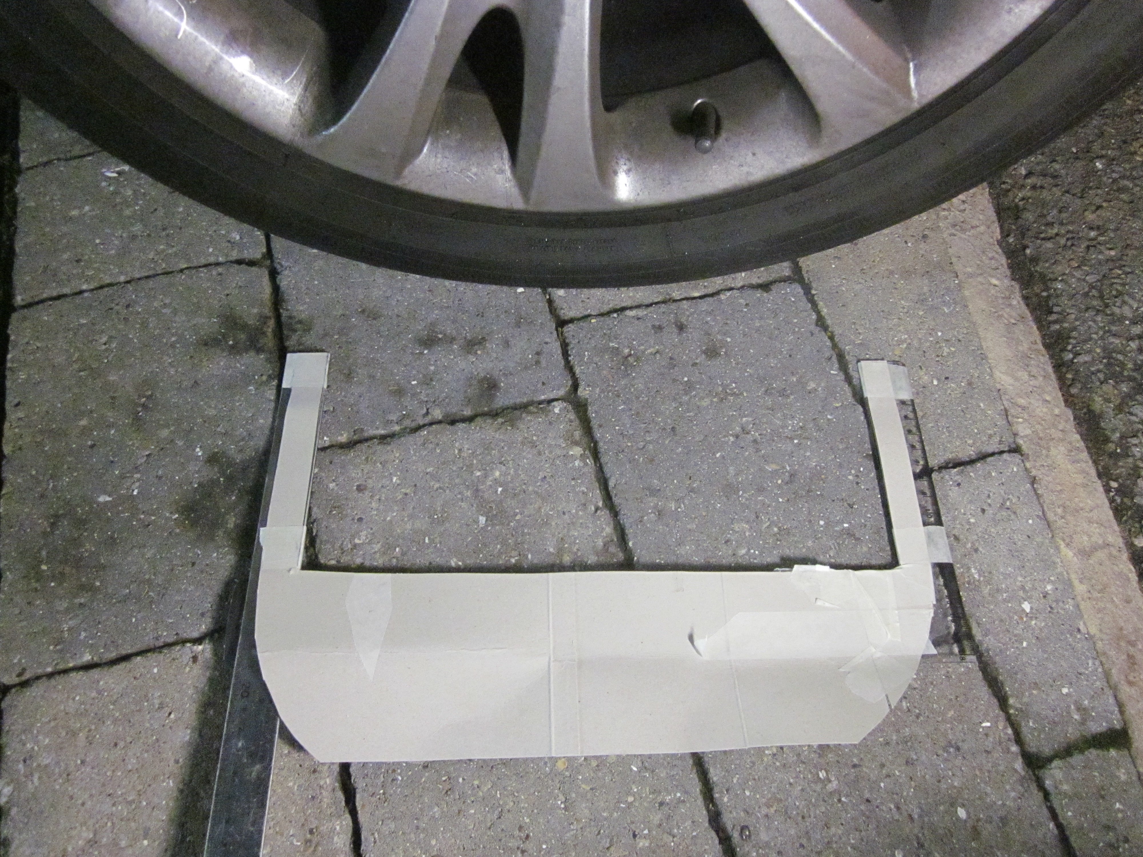

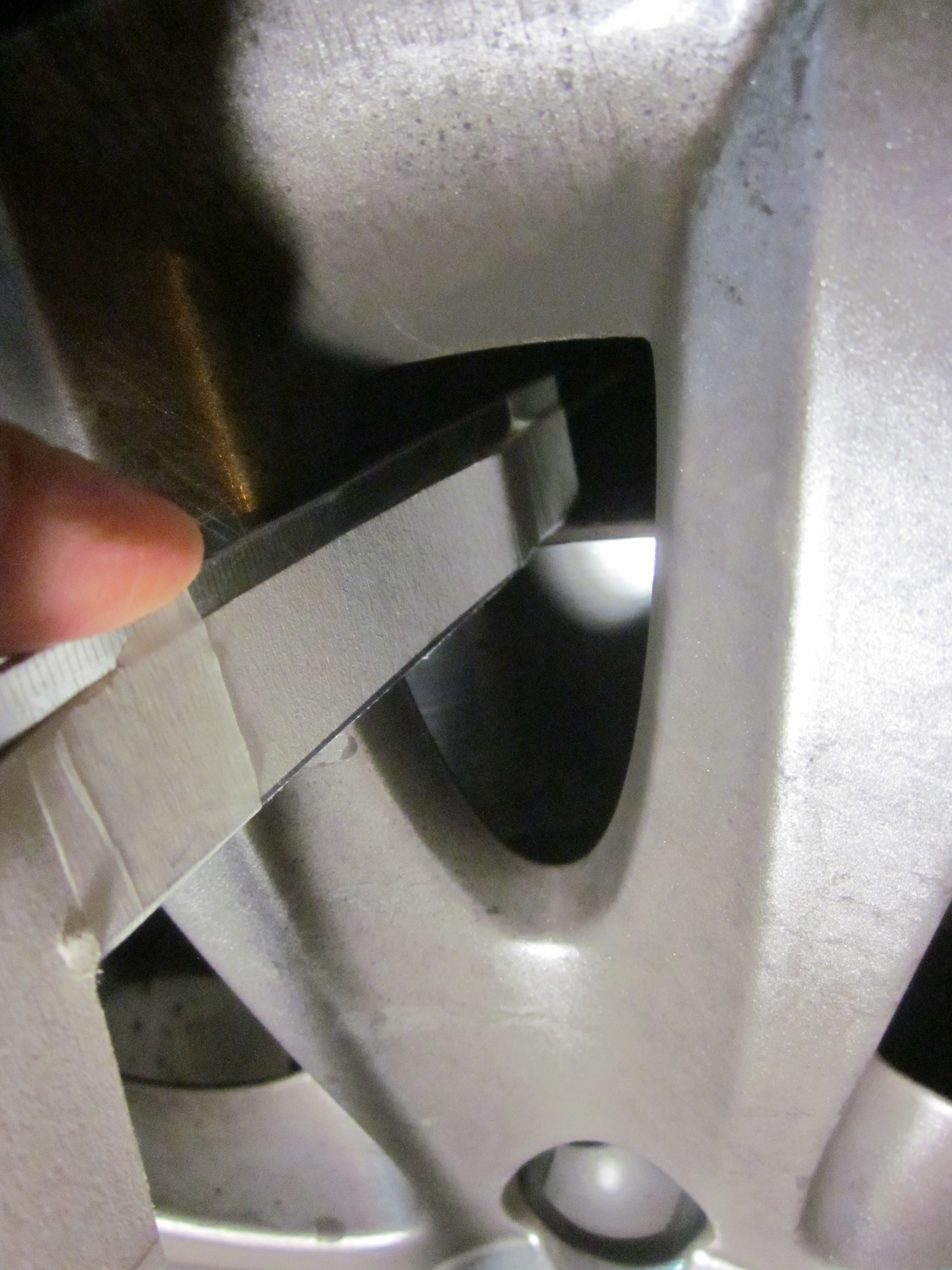

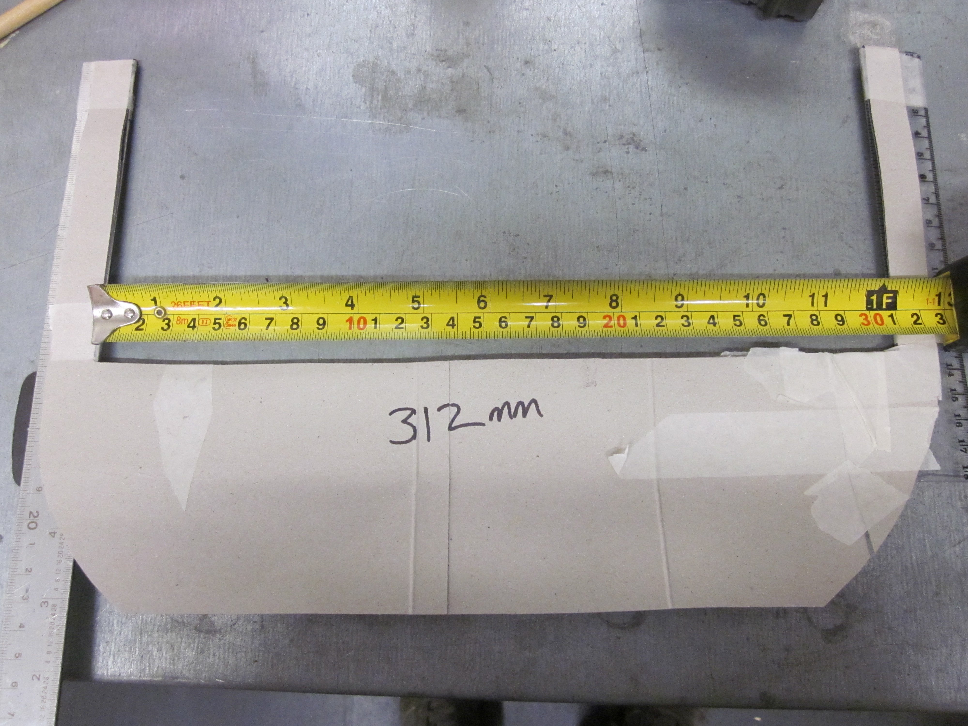

I just nipped outside with a U-shaped piece of cardboard cut to 312mm. Worked a treat :D

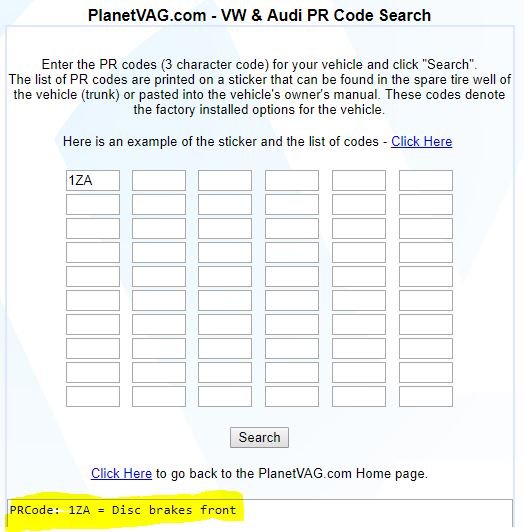

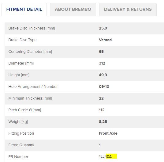

I think you're looking at 1ZA.
This page offers two different part numbers for the caliper carrier, one up to date 24/05/2009  and a different part number from 25/05/2009 onwards. The latter only states for PR number 1ZA. As your car is in this age bracket, I think it must be 1ZA.
https://skoda.7zap.com/en/cz/superb/sup/2011-632/6/615-615030/#15
Nice job Wino, I'd narrowed it down to 1LJ or 1ZA.
1ZA it is!

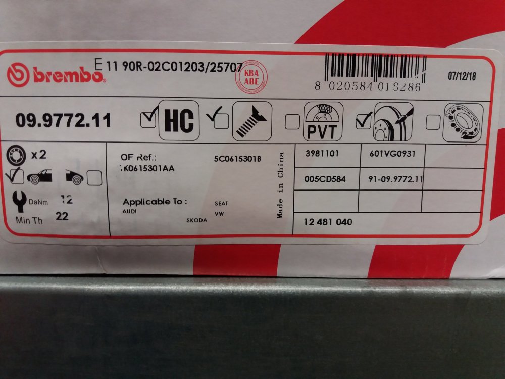

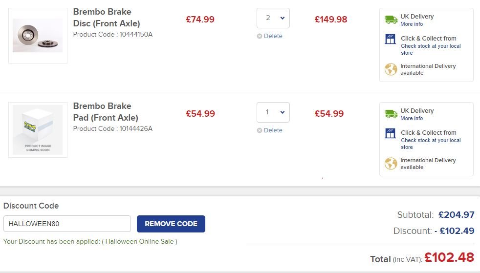

Compared to £102.48 from Brembo's from eurocarparts as shown above.
To go for the Brembo's is the obvious choice, right?

£99 for a pair of Brembo discs and pads. A stint crawling around the car is now in order, just as the weather turns :D

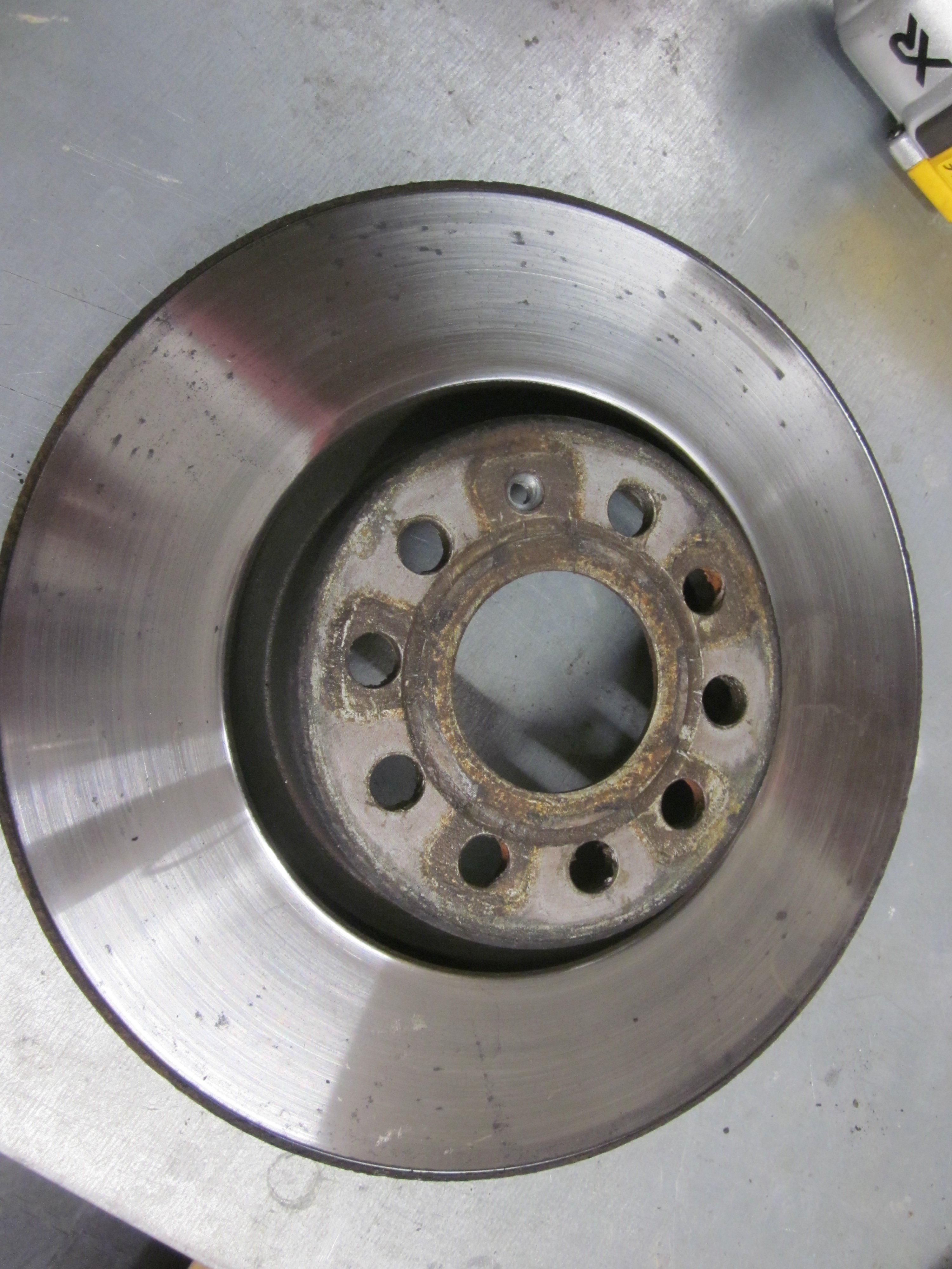

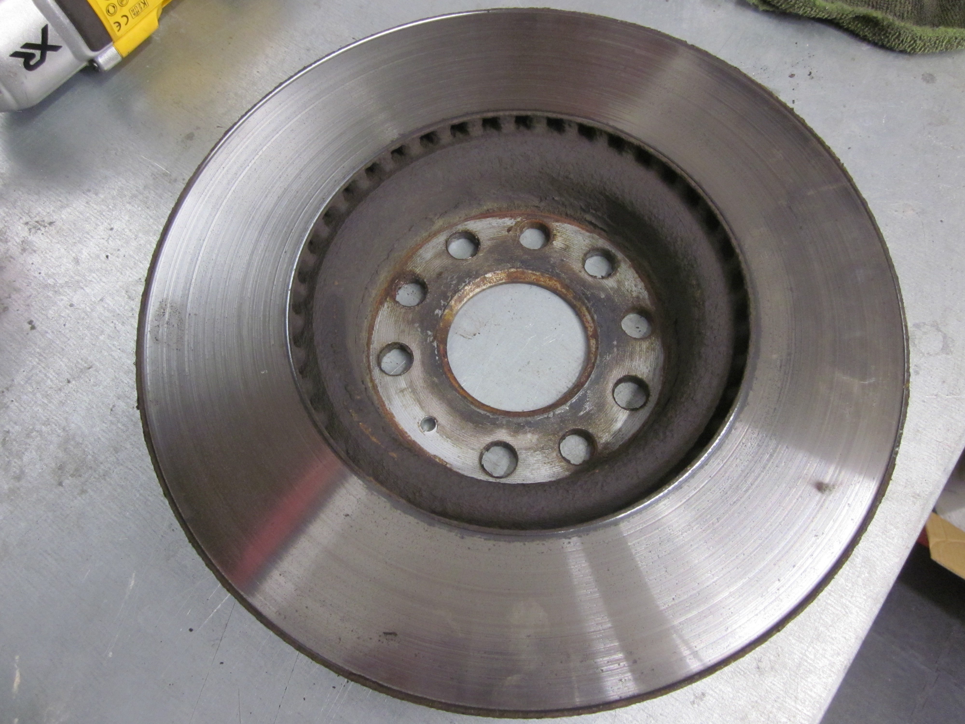

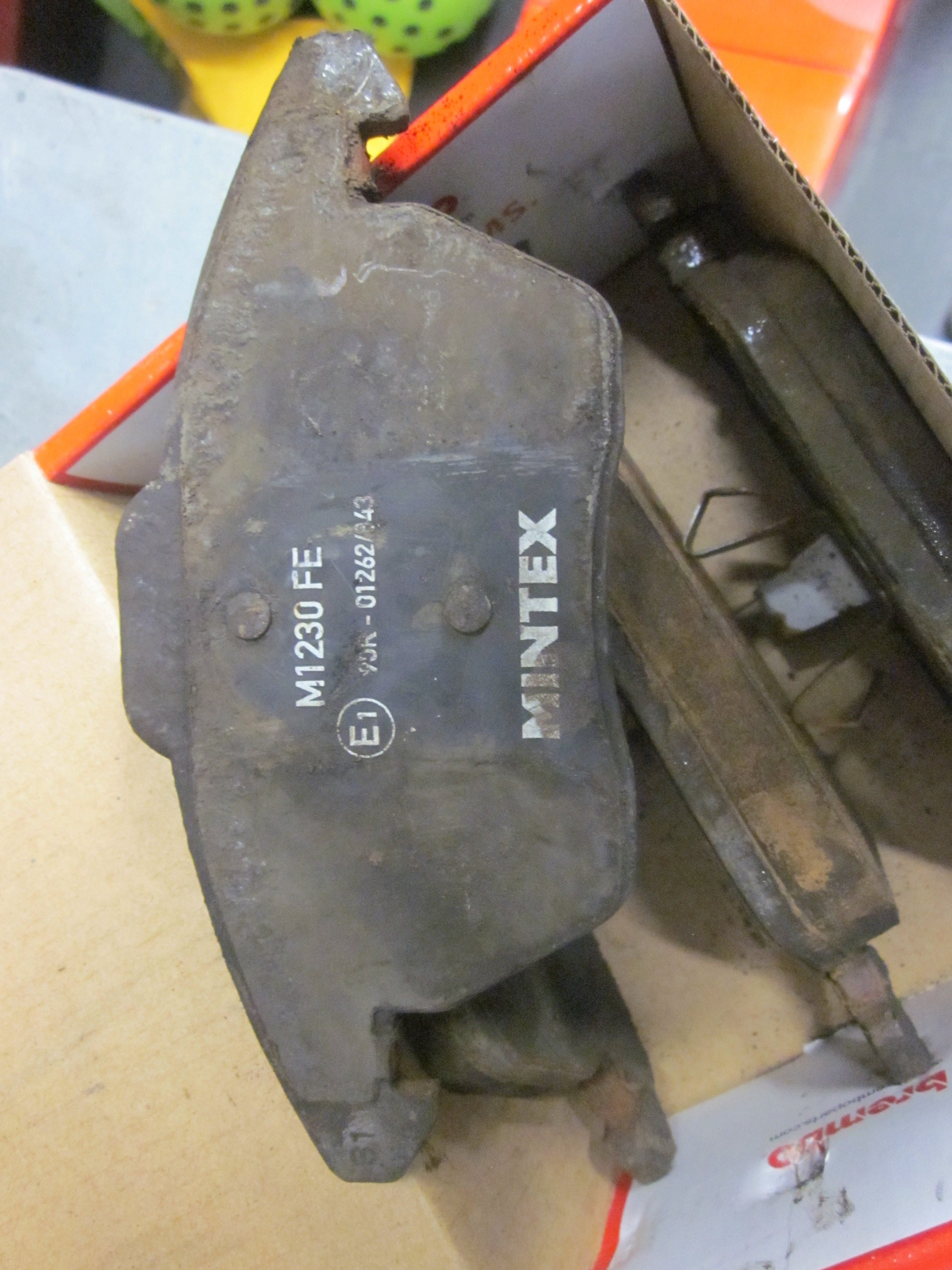

Got them fitted last weekend. Dead easy, although the 21mm bolts holding on the caliper carrier are tight, really tight. An air or battery powered impact wrench is definitely advisable. A piston rewind tool too.

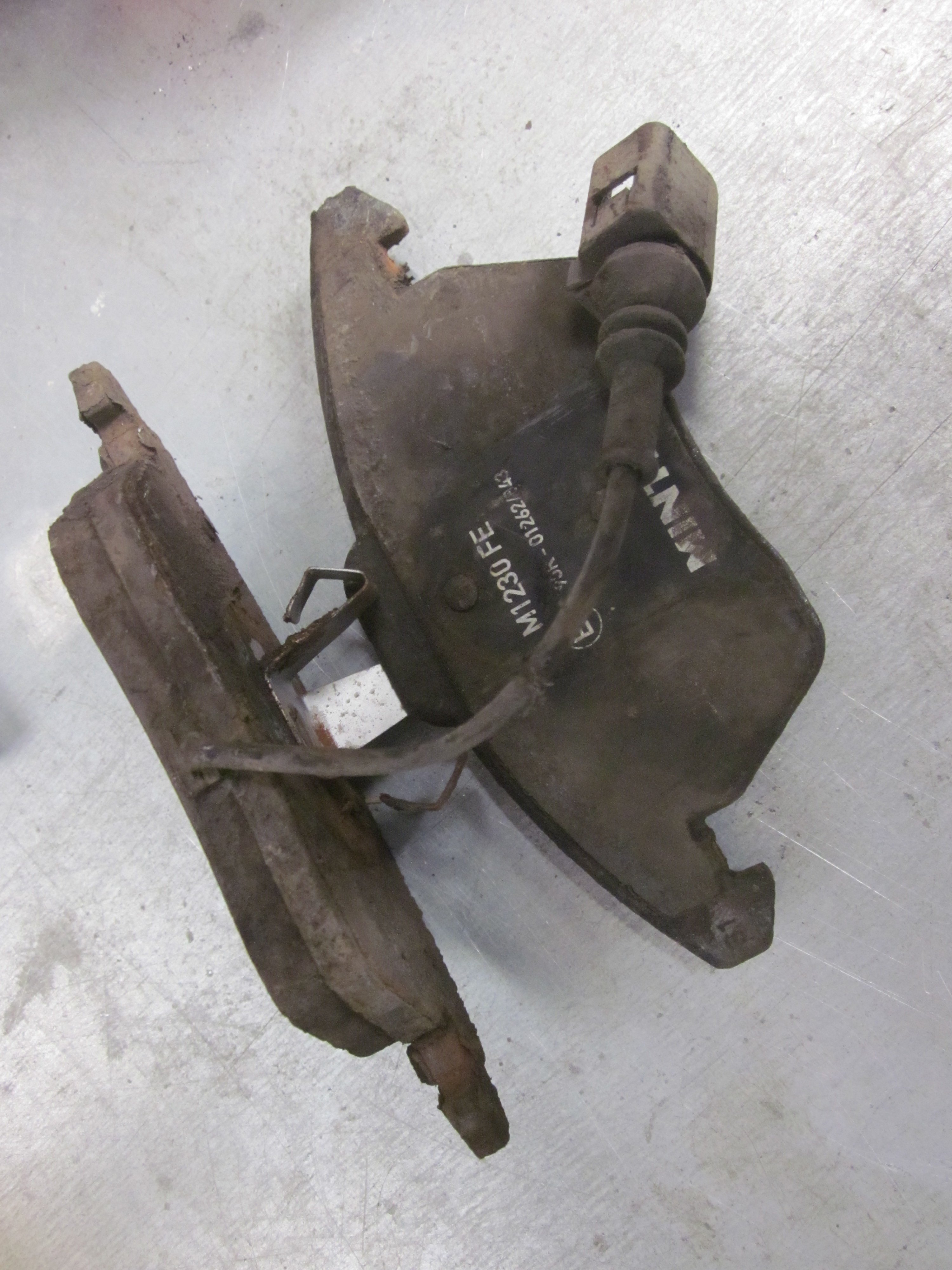

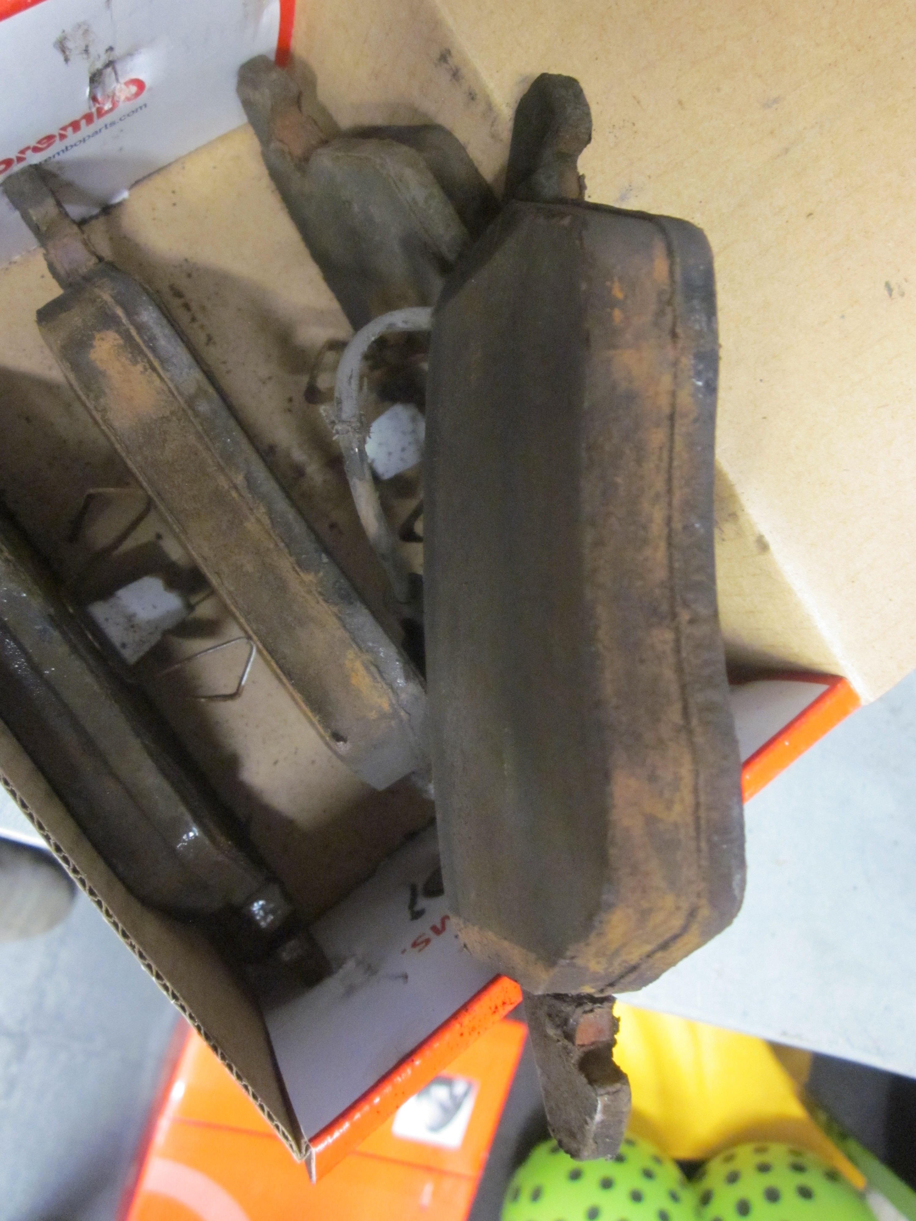

Looking at the old discs and pads, loads of life left in them, a shame really. The wobble through the steering wheel under braking has gone though so I can only assume the discs were warped slightly...

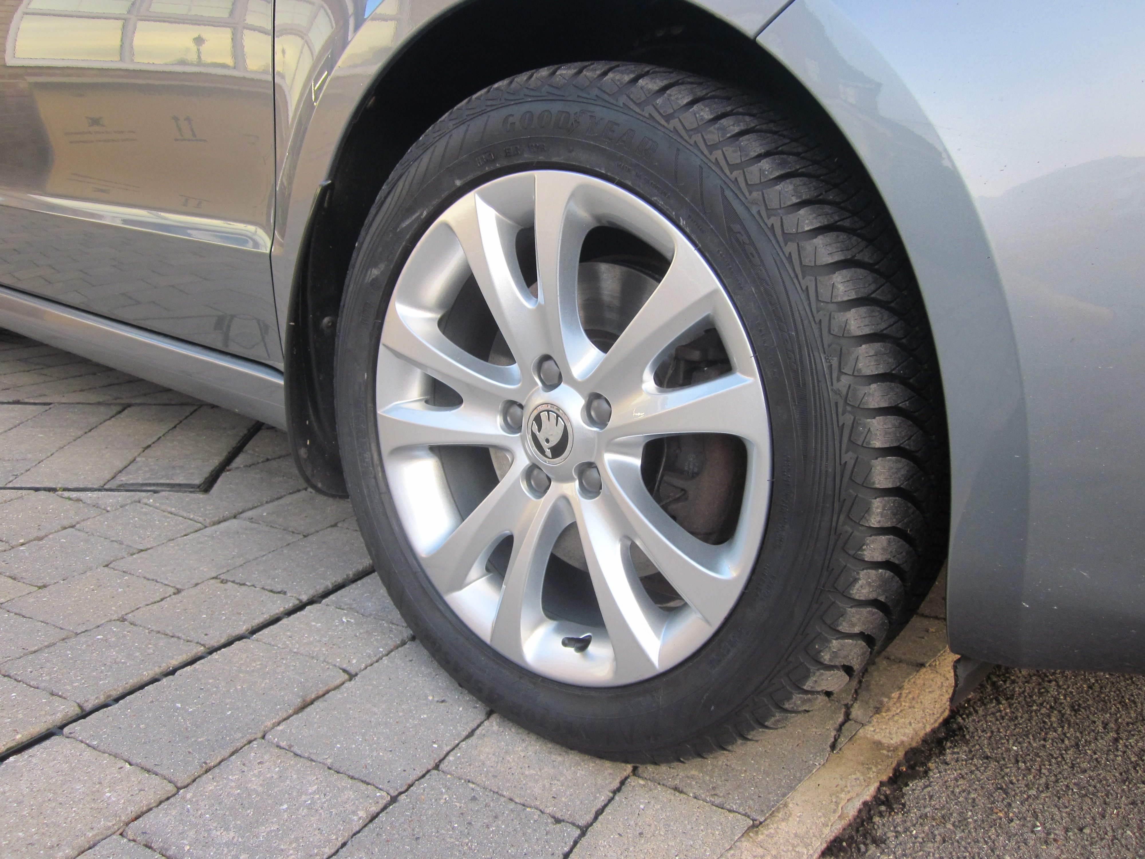

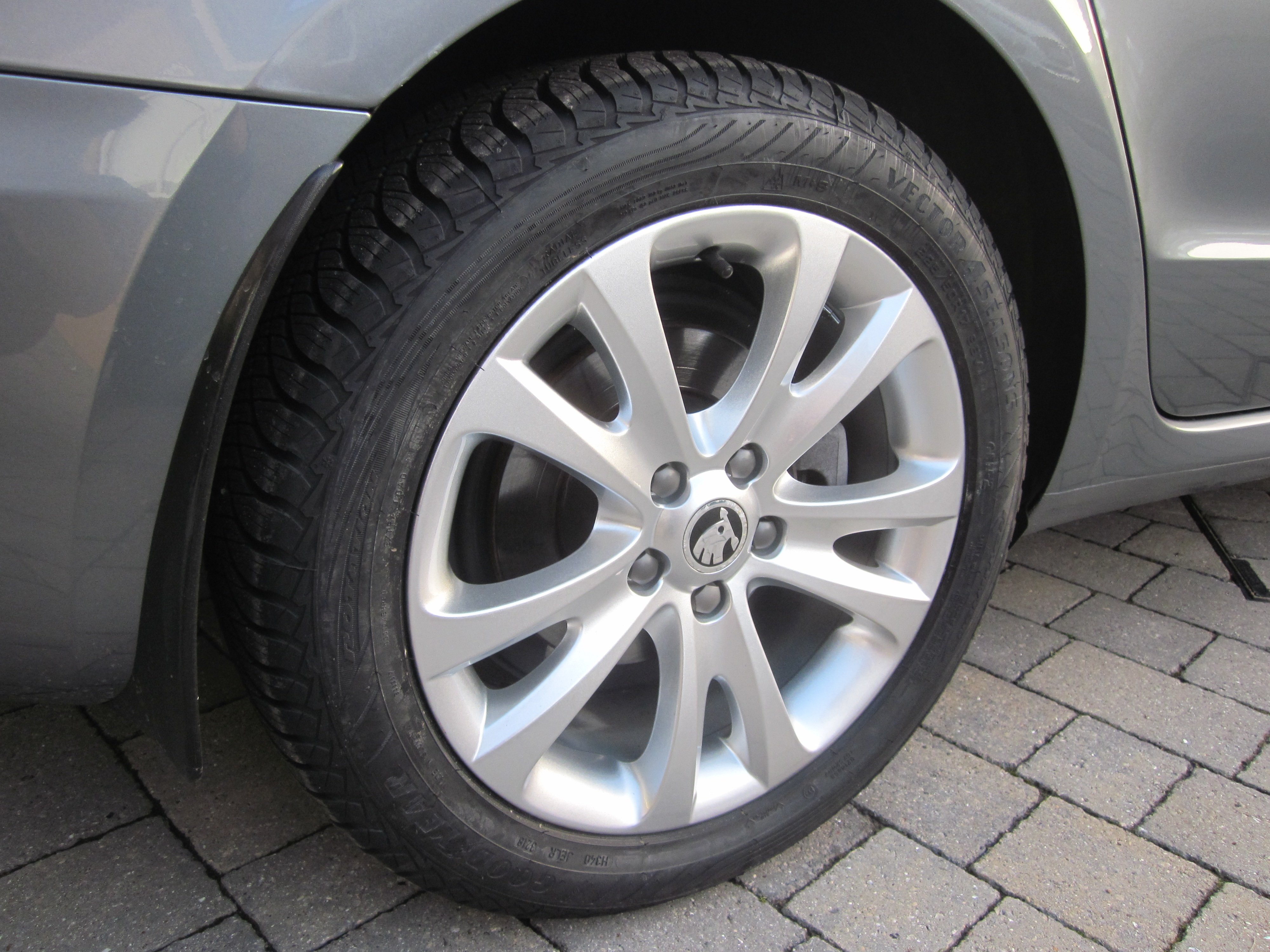

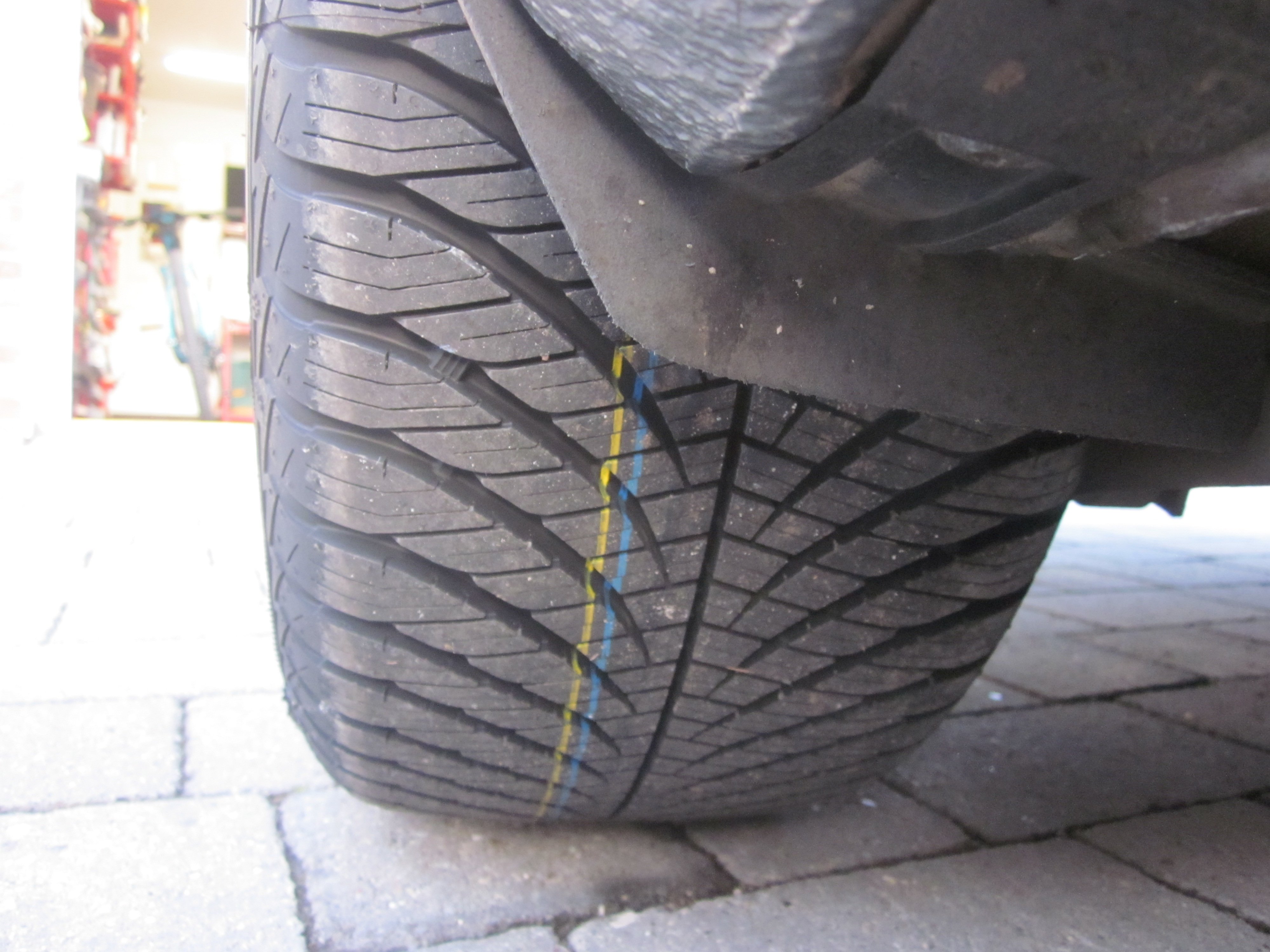

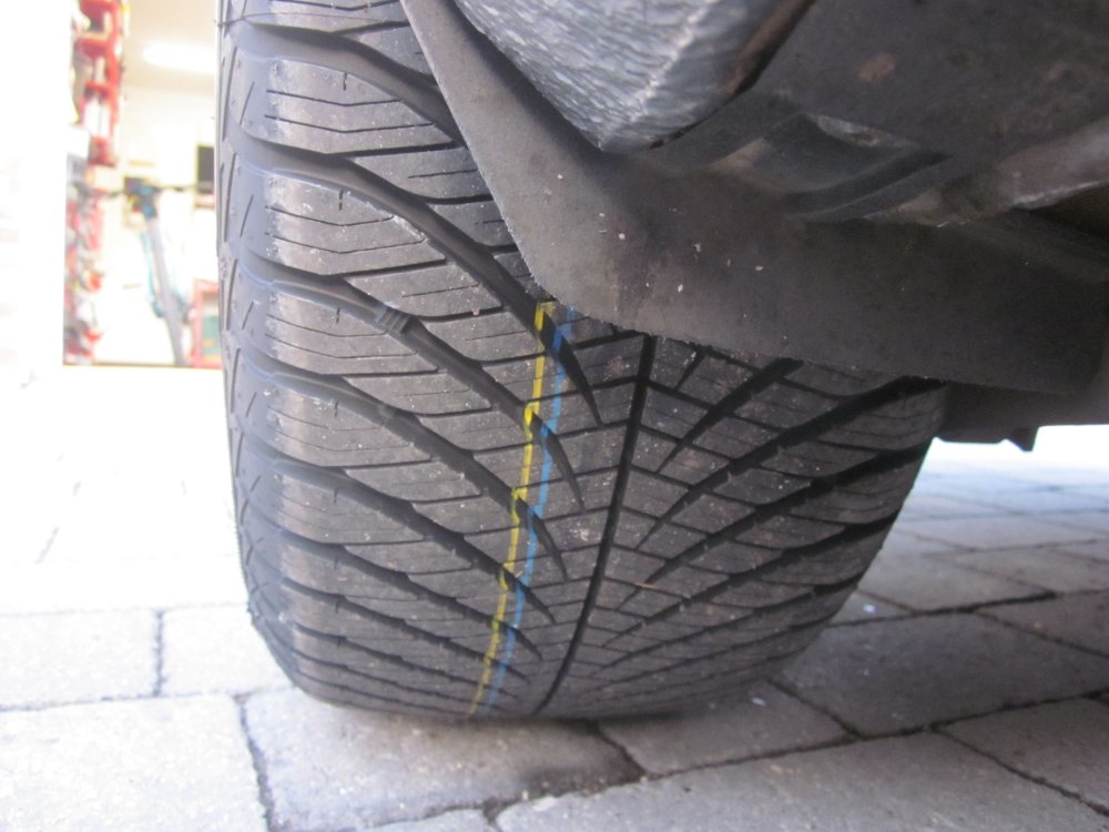

A full set of all seasons fitted today too, should be good for the winter now...
New discs and pads just poking through!
Edited by silver1011
You will certainly be set for the winter with your new brake and tyre set up, looking good!

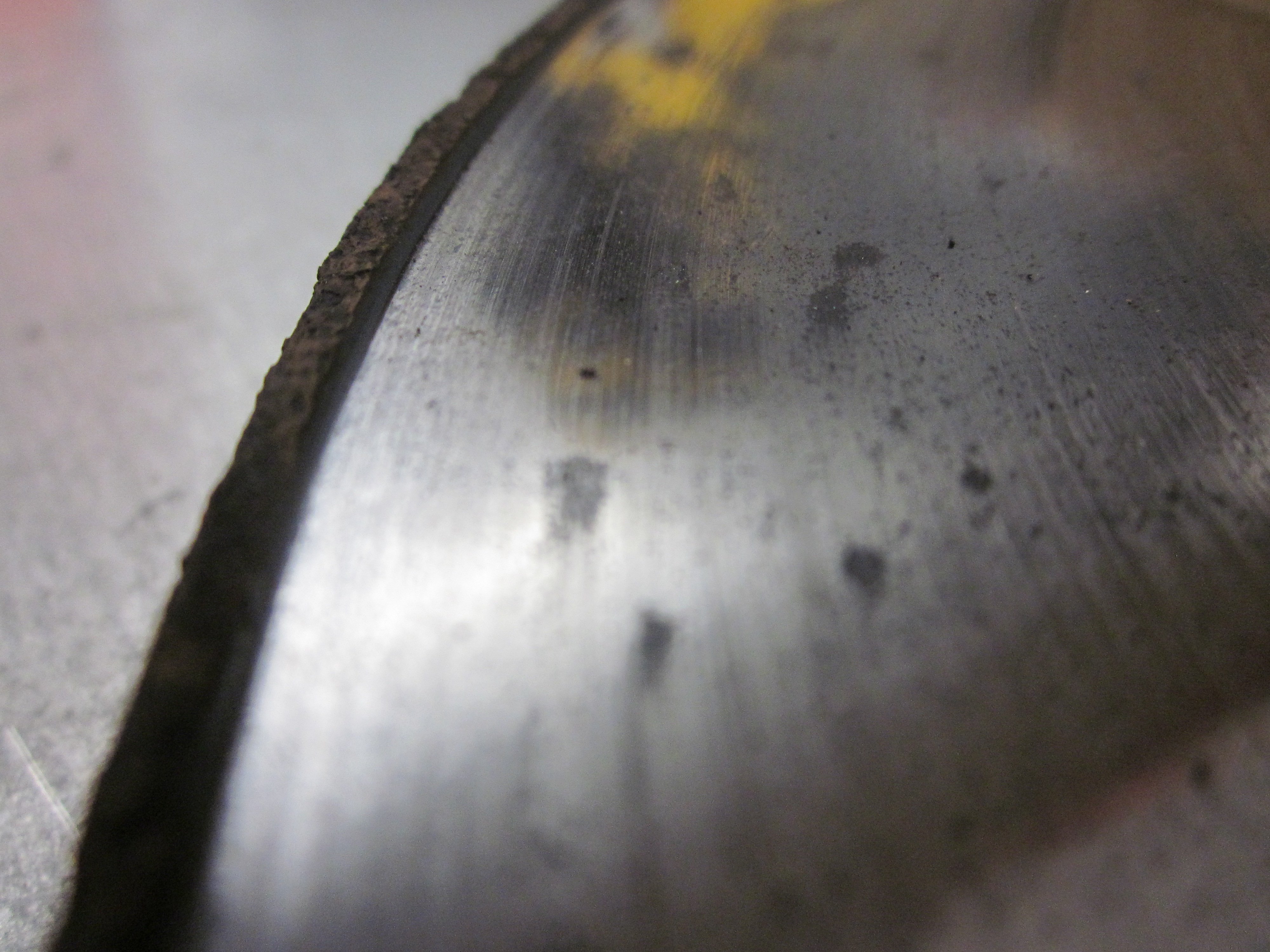

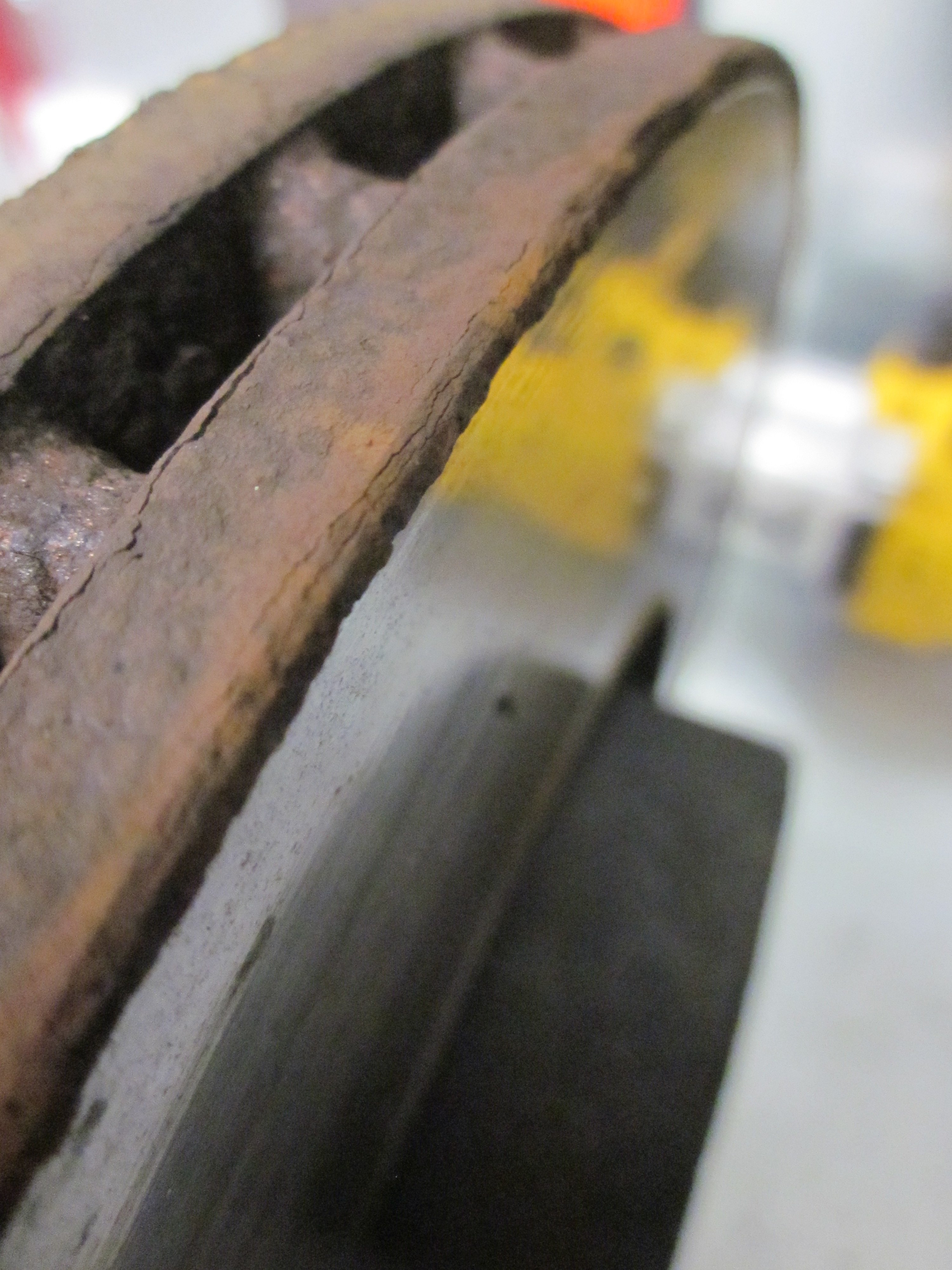

Looks like pad deposits on the discs causing the judder rather than warped discs as you can see the specs of material on the disc, but that's a really good price for high carbon brembo discs and pads.
Interesting observation, I'd not really noticed the dark spotting on the discs until now.
Would this be a sign of something wrong with the discs or pads, or some other external influence?
To be honest the feeling through the steering has been there since within a few months of the discs being fitted, I should have taken them back but never got round to it. The fact it was only noticeable under heavy braking meant it was never much of a bother. It was only recently (2+ years / 50,000 ish miles) that the problem got worse.
Probably combination of poor bedding of the pads when first fitted and may be poor quality brake discs.
