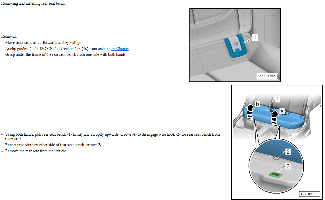

I read that it can't be done easily on the Seat Leon (see attached image).

I've not taken the bench seat out of my Leon. However, the diagram for the front of the bench seat on the Octavia is the same; not visible on the instructions is at the rear left and right hand sides of the chassis there are hooks that retain the back of the bench seat. Once you have released the front of the bench you can slide your hand underneath to feel the locations of the hooks.
