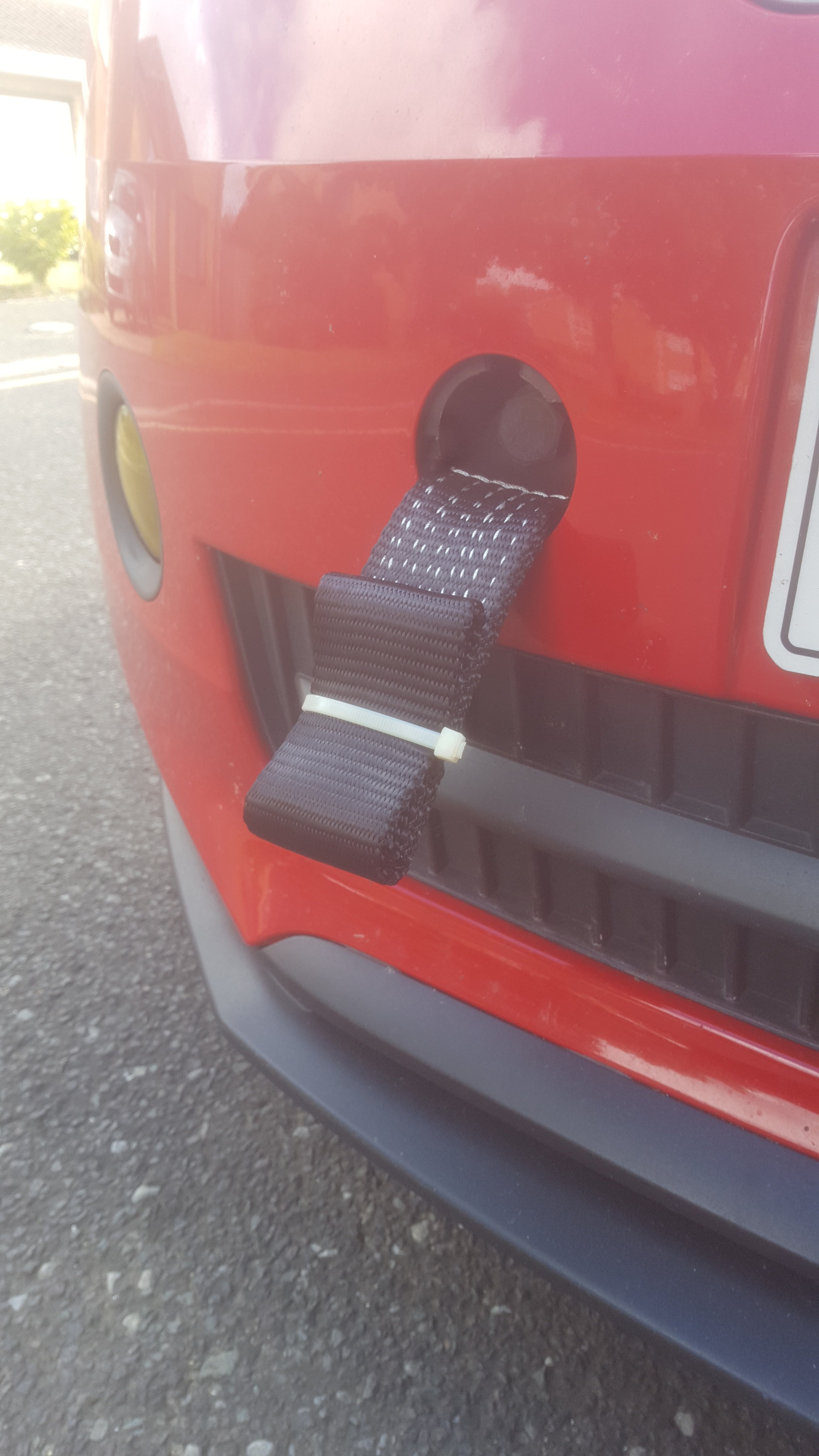

Replaced the tow strap today, had limited options but managed to find a pretty decent one that also stated on the site it was MSA approved, looks pretty solid so if I ever need yanking off track it should do the job. Only downside is the webbing is much longer than the old one, so I can't tuck it out of sight, best I could do was cable tie it over itself, but didn't have any black cable ties.
Edited by Hyphons

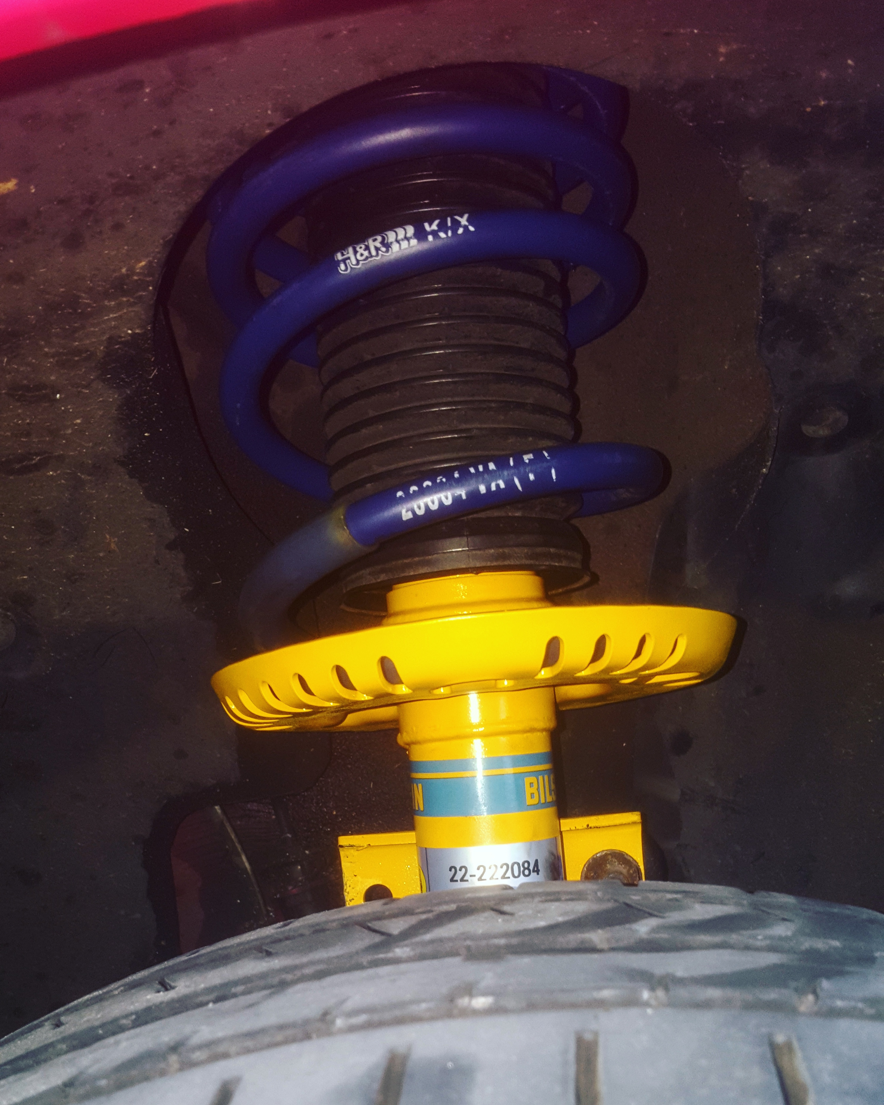

Finally got the suspension sorted with thank to @Updown789
I still have a knock though coming from drivers side and it seems I have some very slight play in the driveshaft so I shall get that booked in, checked and replaced if need be.
I've had another look over the car today, knocks when turning side to side but it can't be steering rack as it doesn't make the same noises off the floor, in fact it makes no noise off the floor at all, only when there's load on the front end, only sign I can see of anything being unnormal is the grease on the inner drivers CV boot, so it's booked in Monday morning for a diagnosis and replacement driveshaft if need be, as may as well replace it all whilst it's off
Looks like the knocking is here to stay, it's being caused by the top mounts, kinda adds up, transitioning left to right changes where the sound comes from, also up in the air with no weight over the front there's no noise either. When you Google about Poly top mount knocking it seems a common thing.

Brand new shocks so shouldn't be knackered already, I would imagine that if it was because something isn't tight it would be pretty obvious? Plenty have mentioned similar problems, top mounts are from a Golf as well and not a Citigo, but they are exactly same, also the only Citigo as far as I am aware that runs poly top mounts, so no other car to compare too. I'll find out what they said it was when I get home.
Topmounts need to be tight tight.
the lock nit on the top can seem tight but if not dont up properly will cause knocking.
Indeed I normally gun them up off the floor then again when under it's own weight to make sure
It's difficult to get a gun on these, you need to hold an Alan key to stop the strut from spinning whilst doing them up, there's 2 nuts, one to hold the spring, one to attach to strut tower at the top, the one holding the spring was gunned @Updown789 did the work, so we can blame him :D
@Updown789, you need to have a word with David's mum about this attitude, he's totally ungrateful and it's time something is done about it!
Absolutely disgraceful behaviour David. Yes they were definitely done up tight.

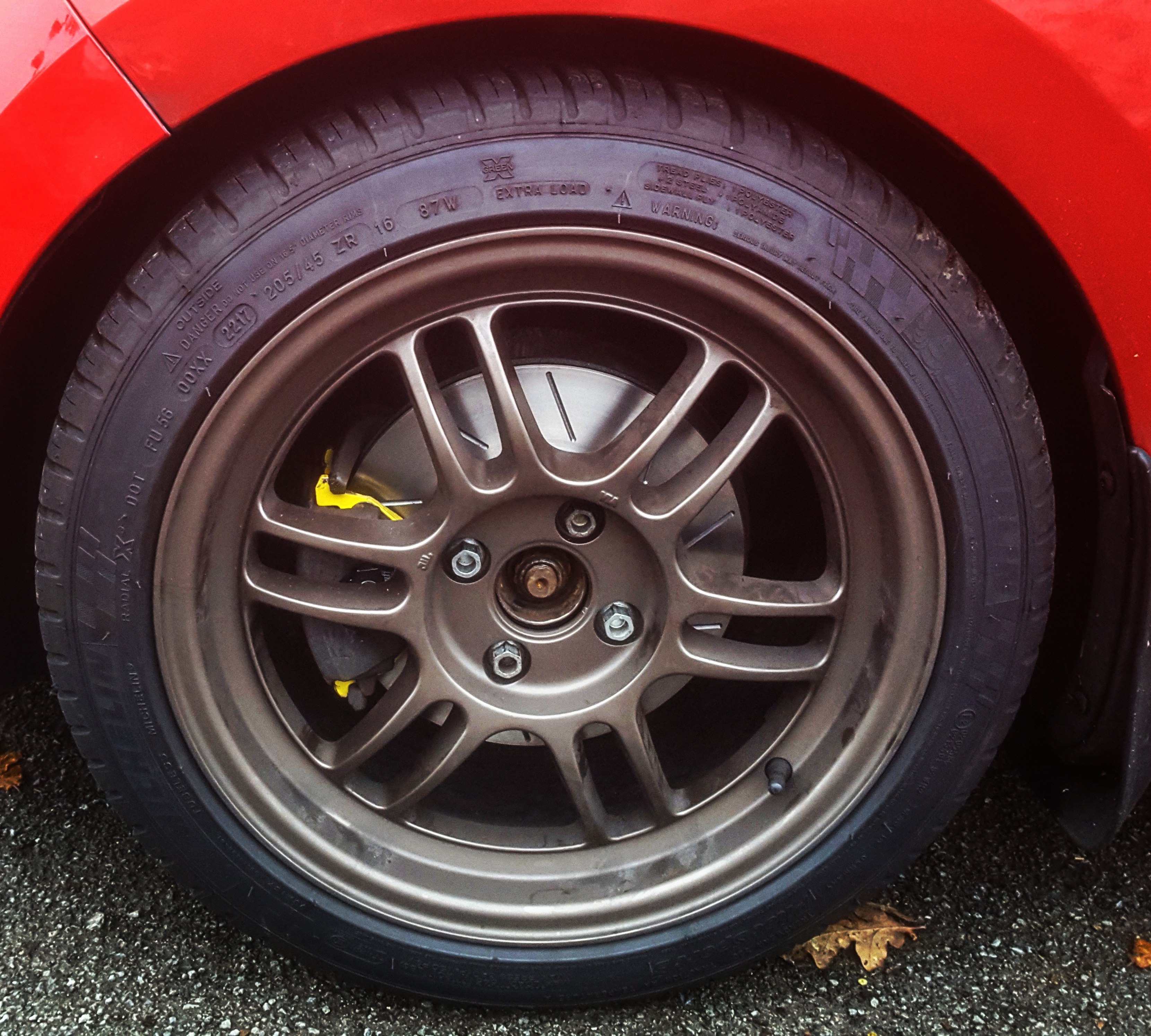

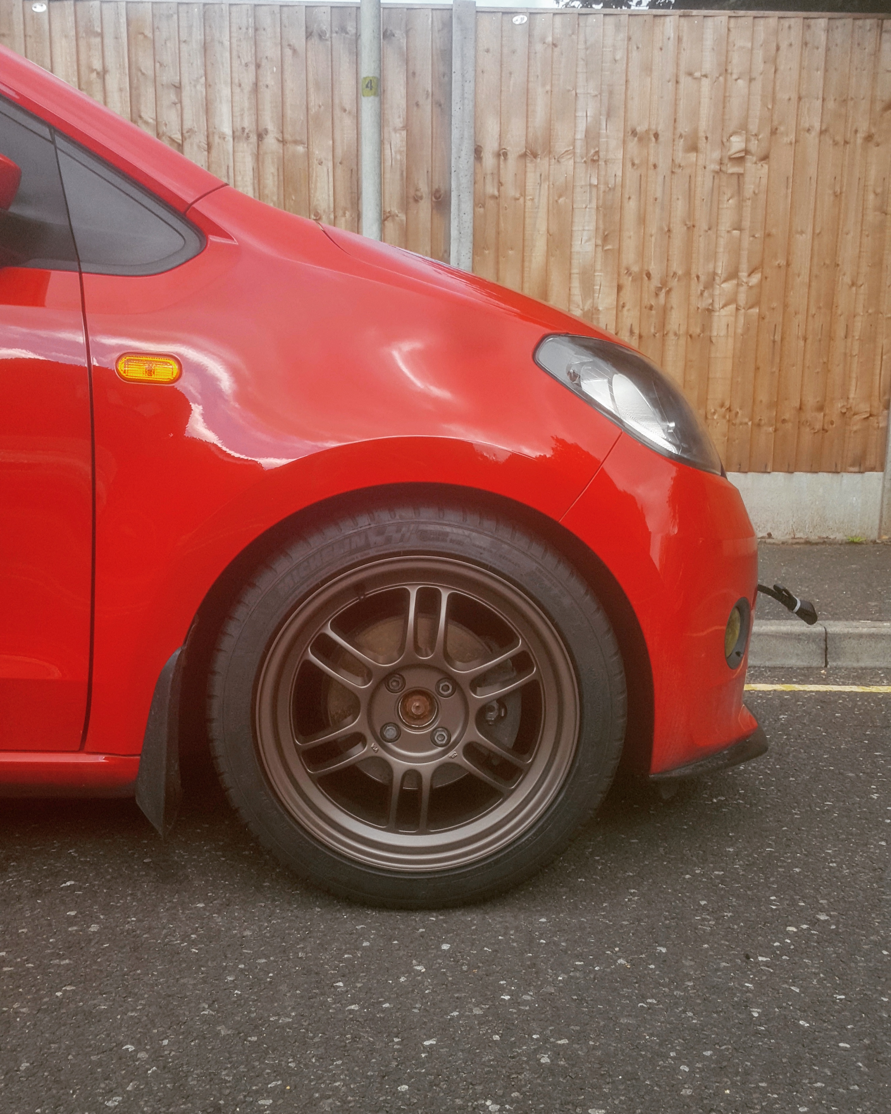

Big update today, wheels changed from the Snowflakes to Ultralite F1 wheels

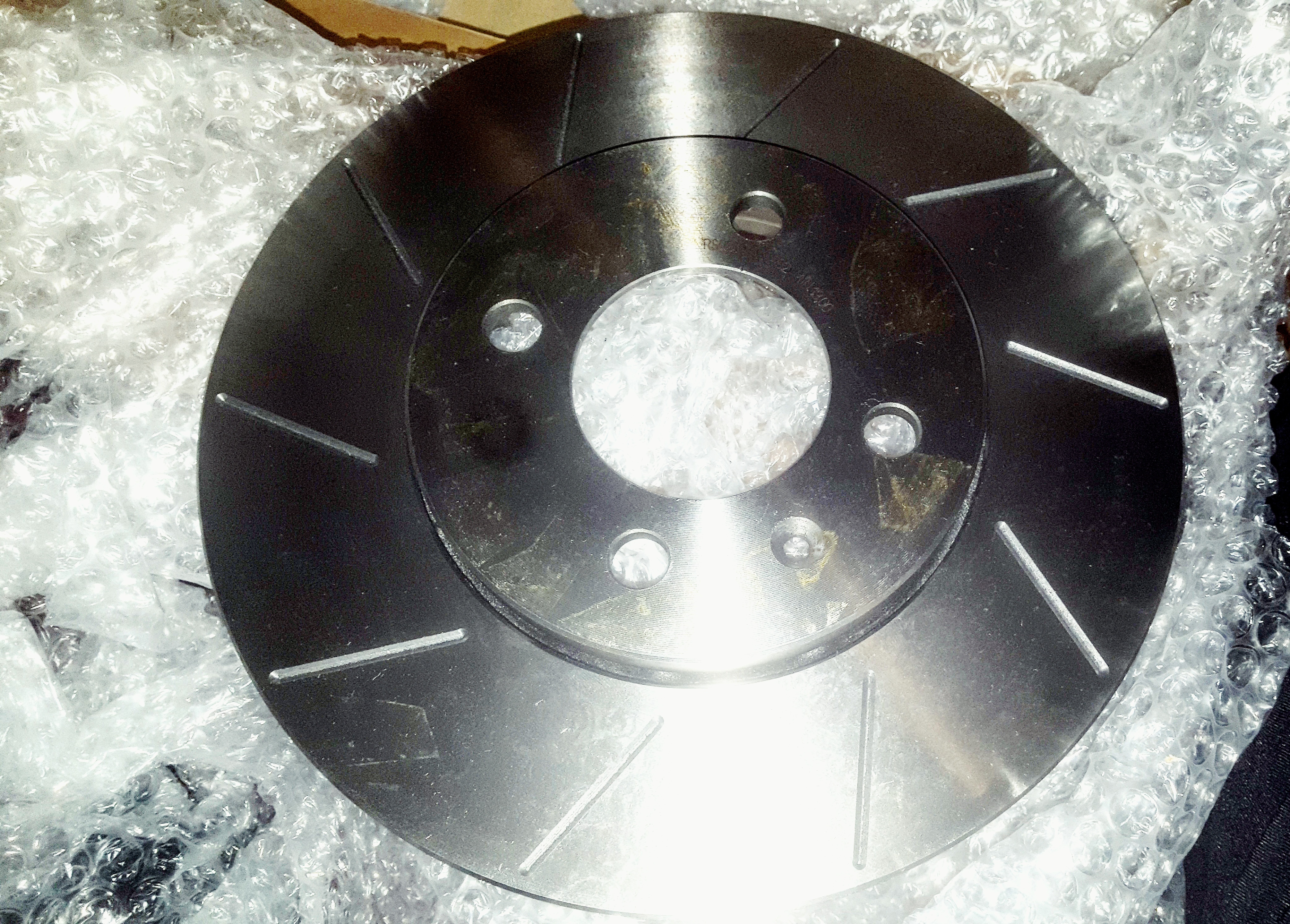

Also had a steady flow of parts arriving for the brakes, including these..

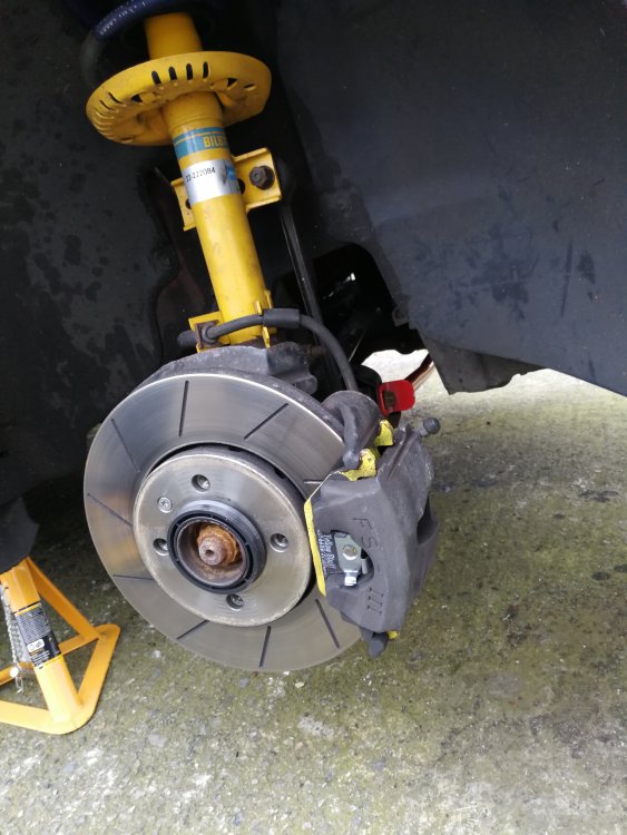

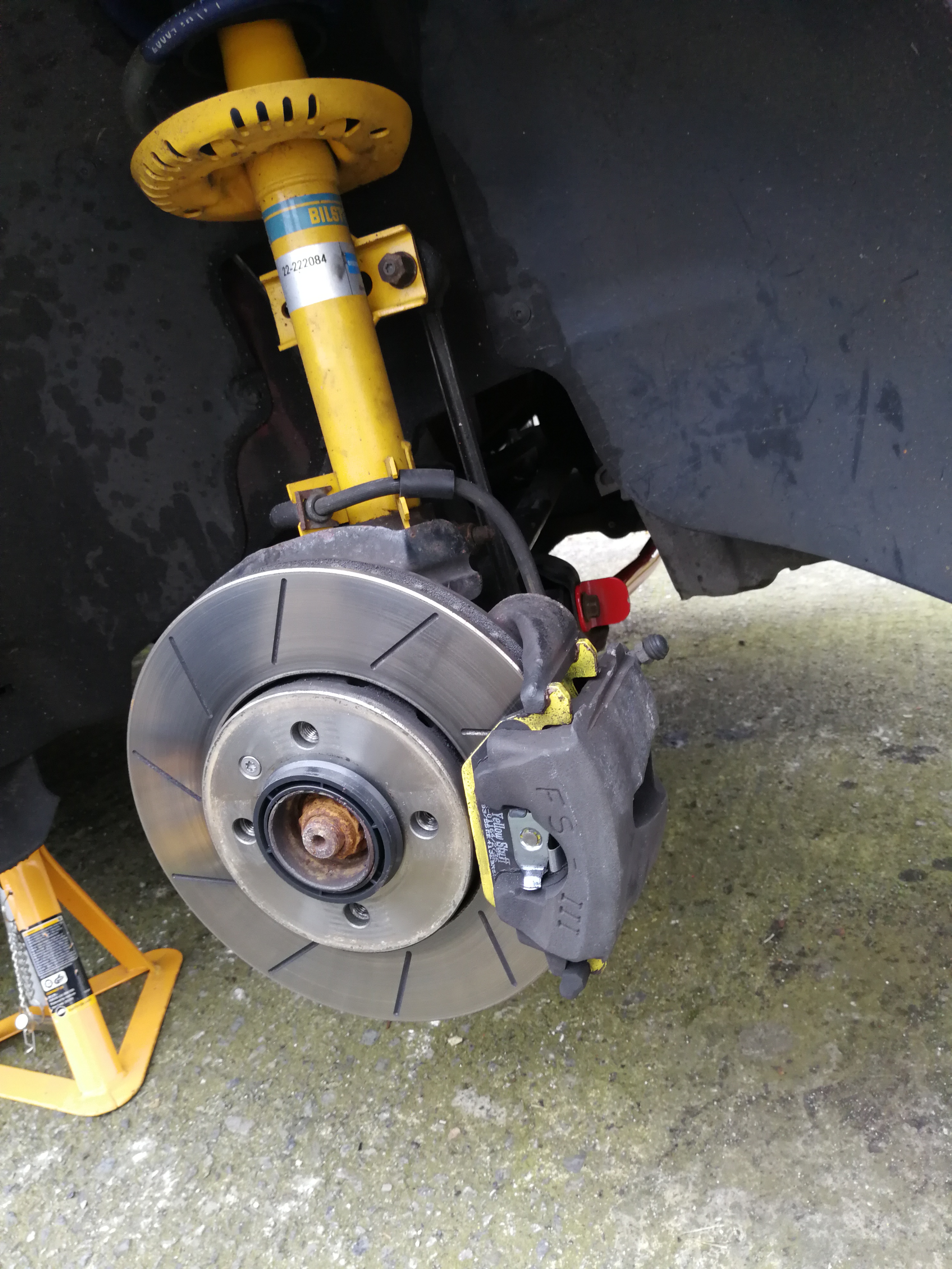

Brake upgrade part 2 thanks to the help of @andsoutham

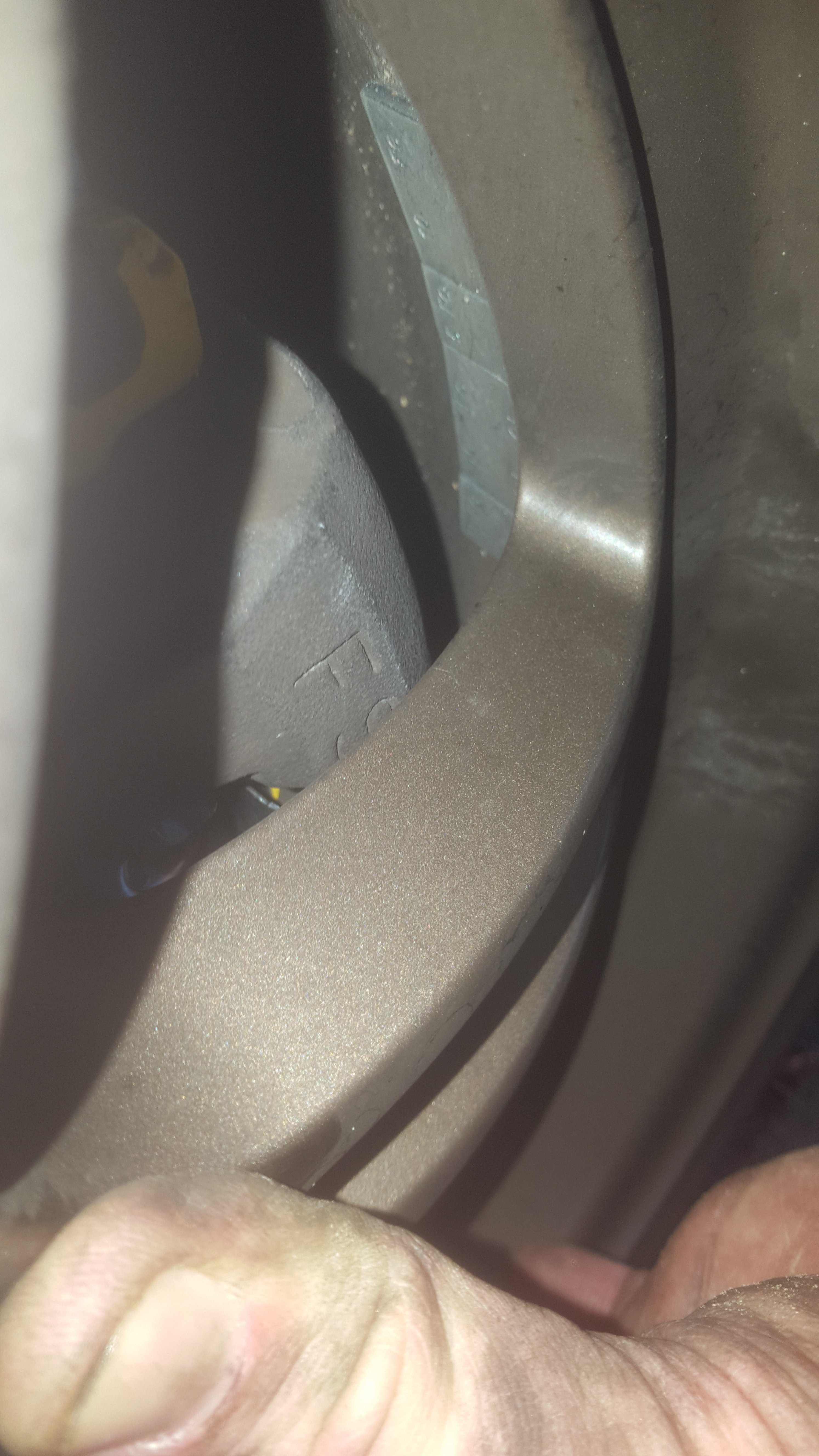

Grooved discs and EBC yellow, along with a brake fluid flush as the brakes had a bit of a moment at Cadwell and it was due in a few thousand miles anyway.
The clearance between the caliper and the wheel is ridiculous, I could get a sheet of paper between the gap and no more..

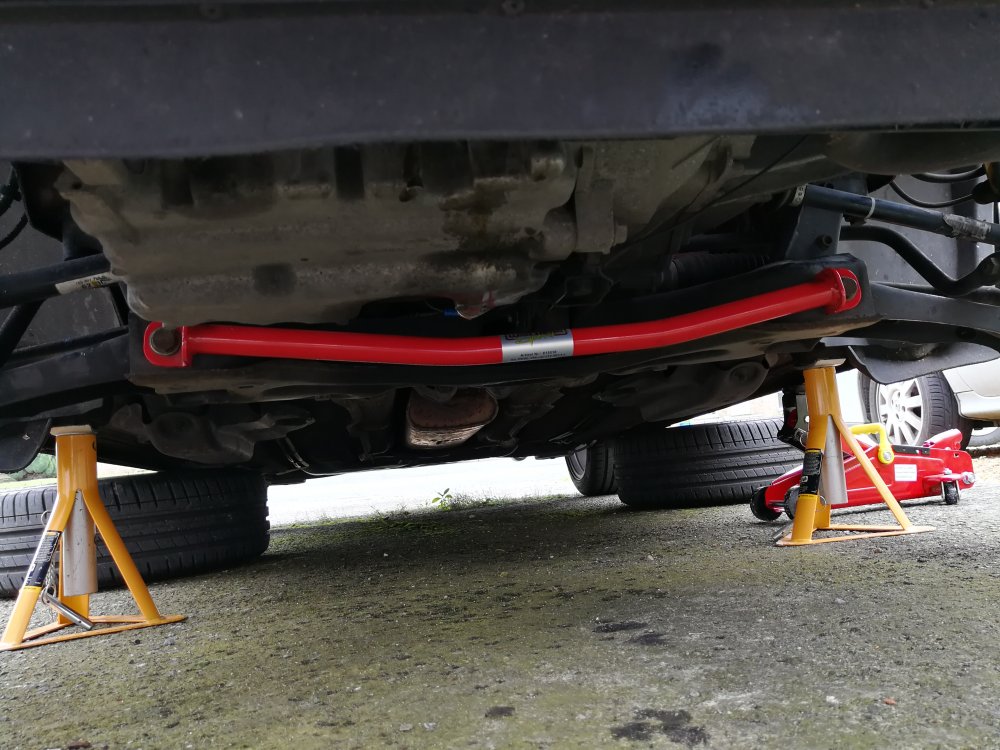

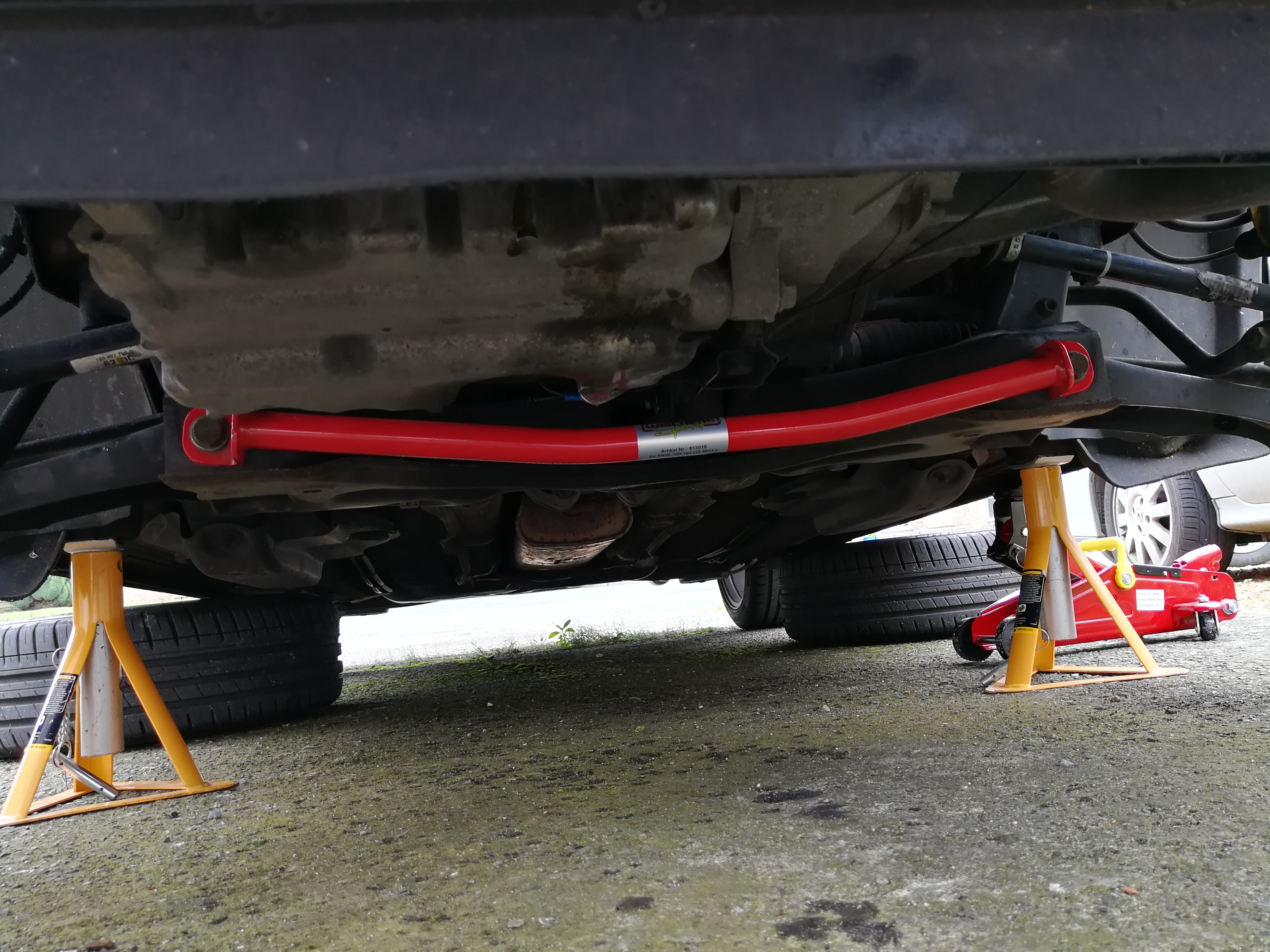

Today's addition, lower front strut brace.
Just about visible from the side
Also put fresh oil and new sparks in the car as well. Thanks again to @Updown789 for his assistance.
Where did you get the lower strut brace from? Looks like an easy fit..... ;)
