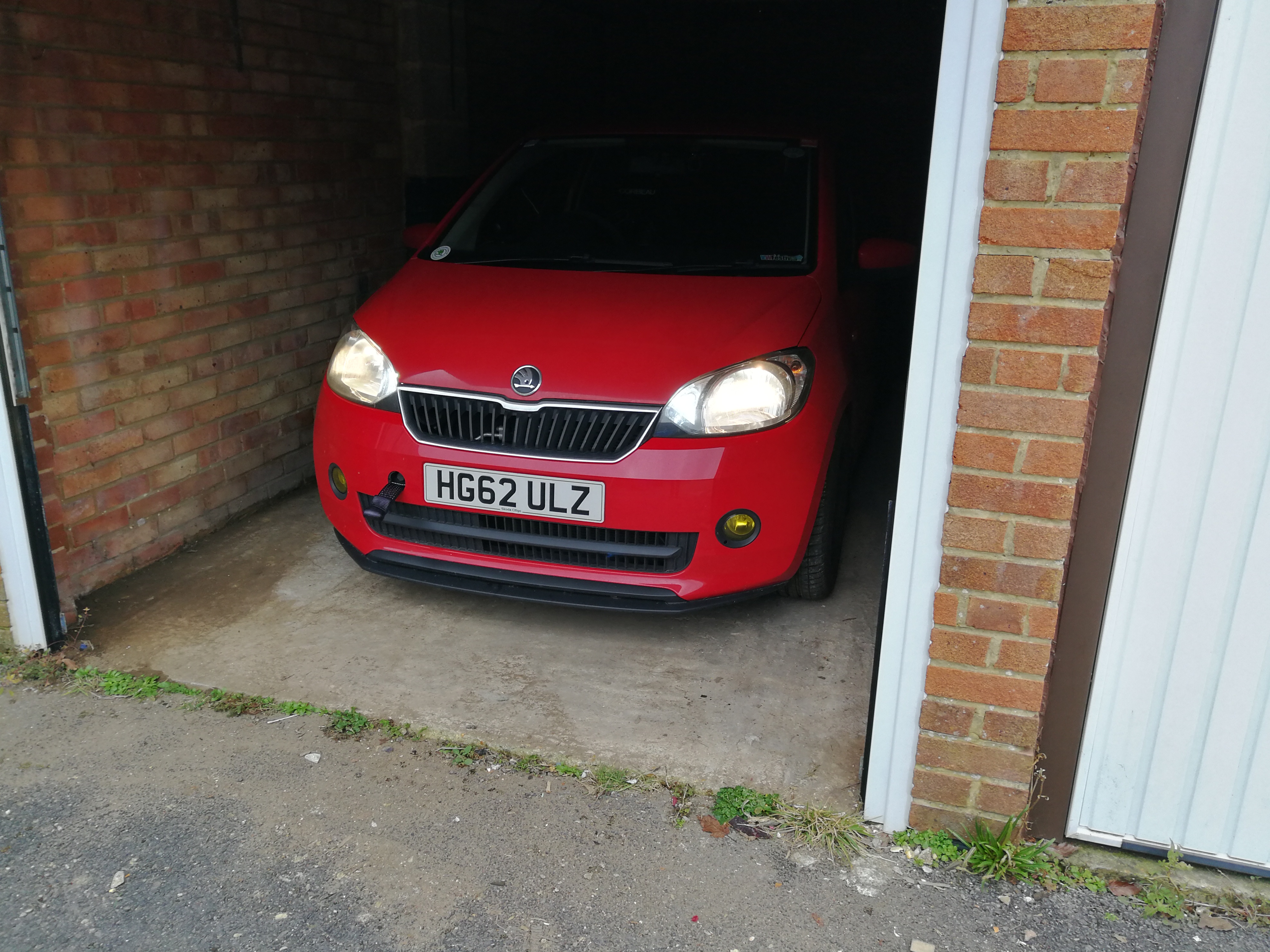

I've also gutted the rear a little more and taken the passenger seat out so I can get the leather seats up for sale, the cars also now in a garage away from home so it can get off the drive.

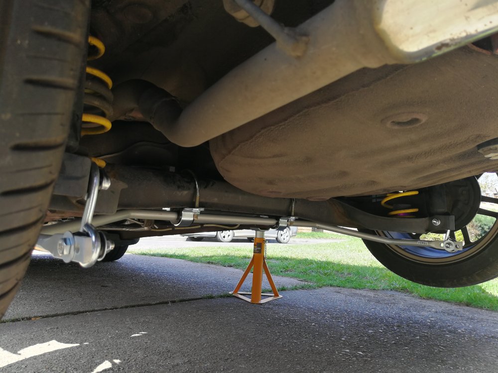

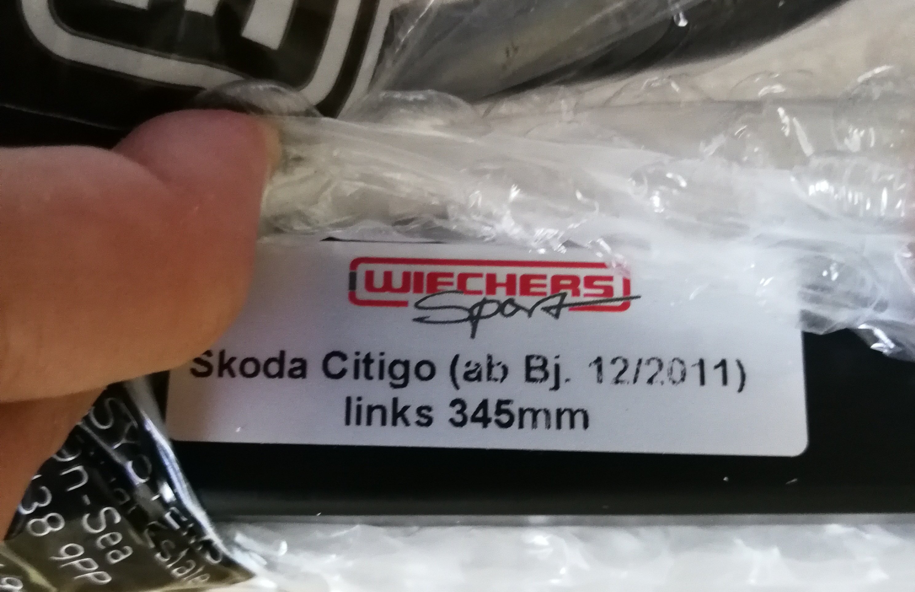

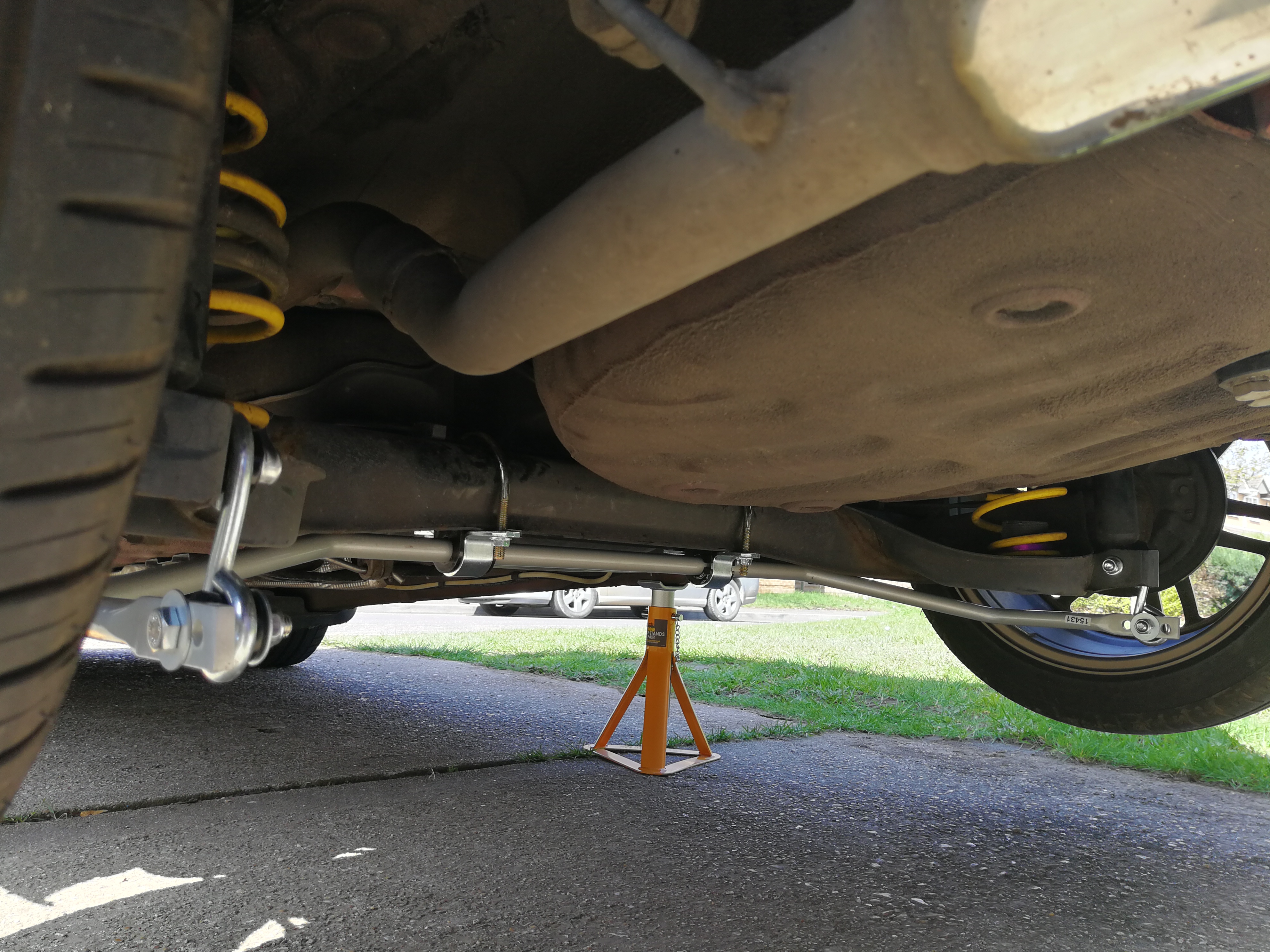

Long time no update, rarb fitted, just, kinda..
Those with a keen eye will spot that it's not all quite spot on, nevertheless, it fits (just) and works brilliantly, it might just be self conscious that it feels much better, but it certainly carries itself round the corners at whatever speed you want to throw it into the corner

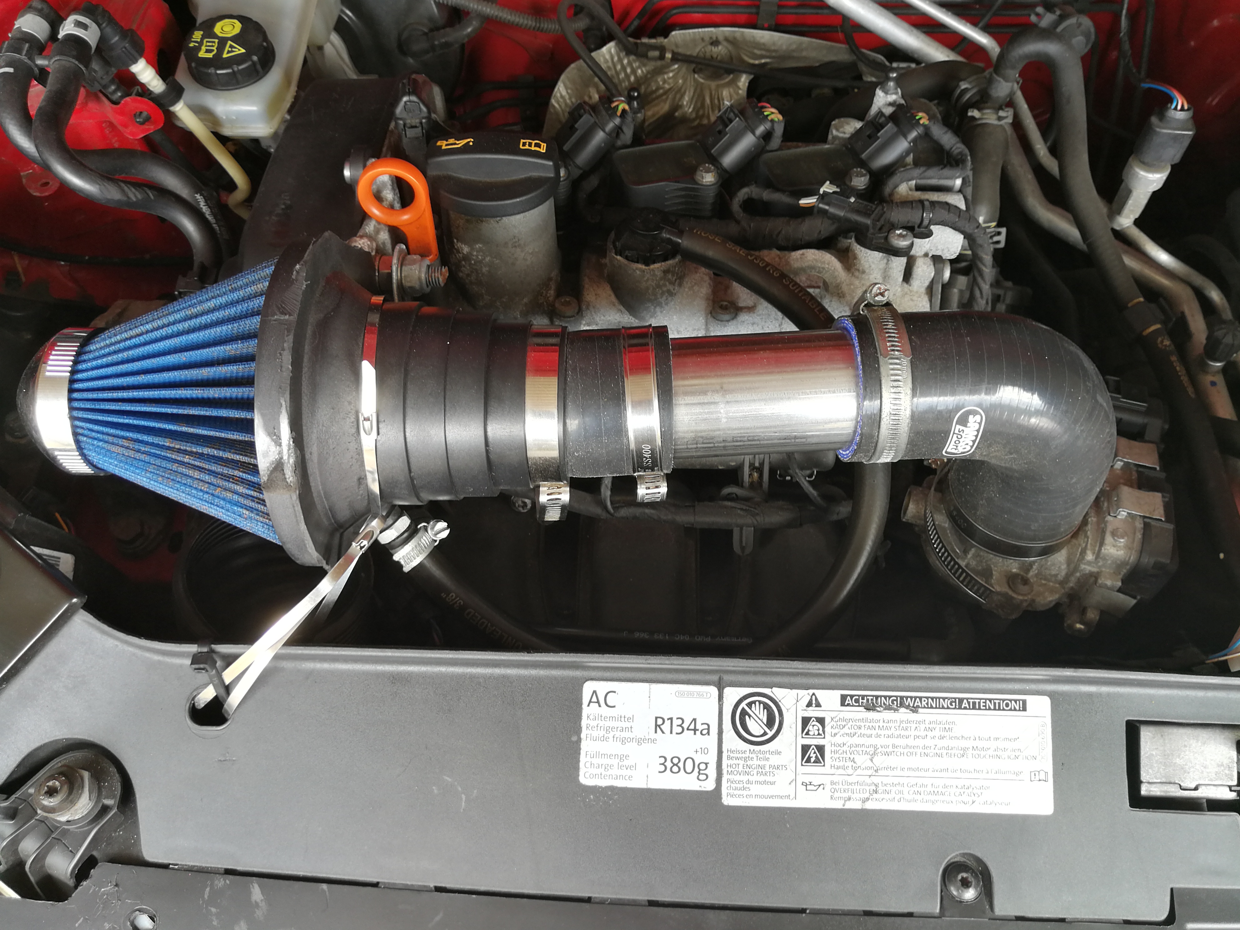

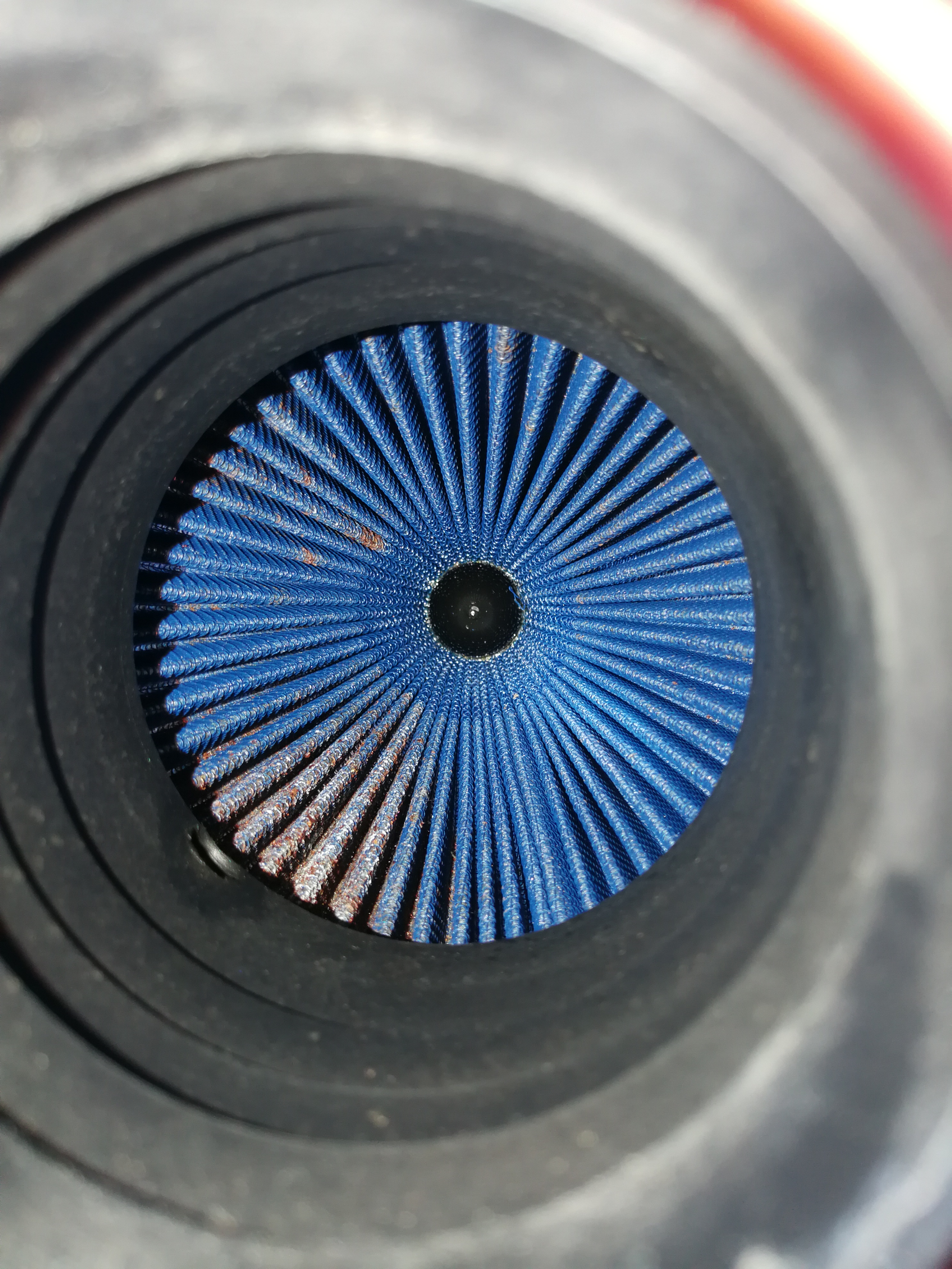

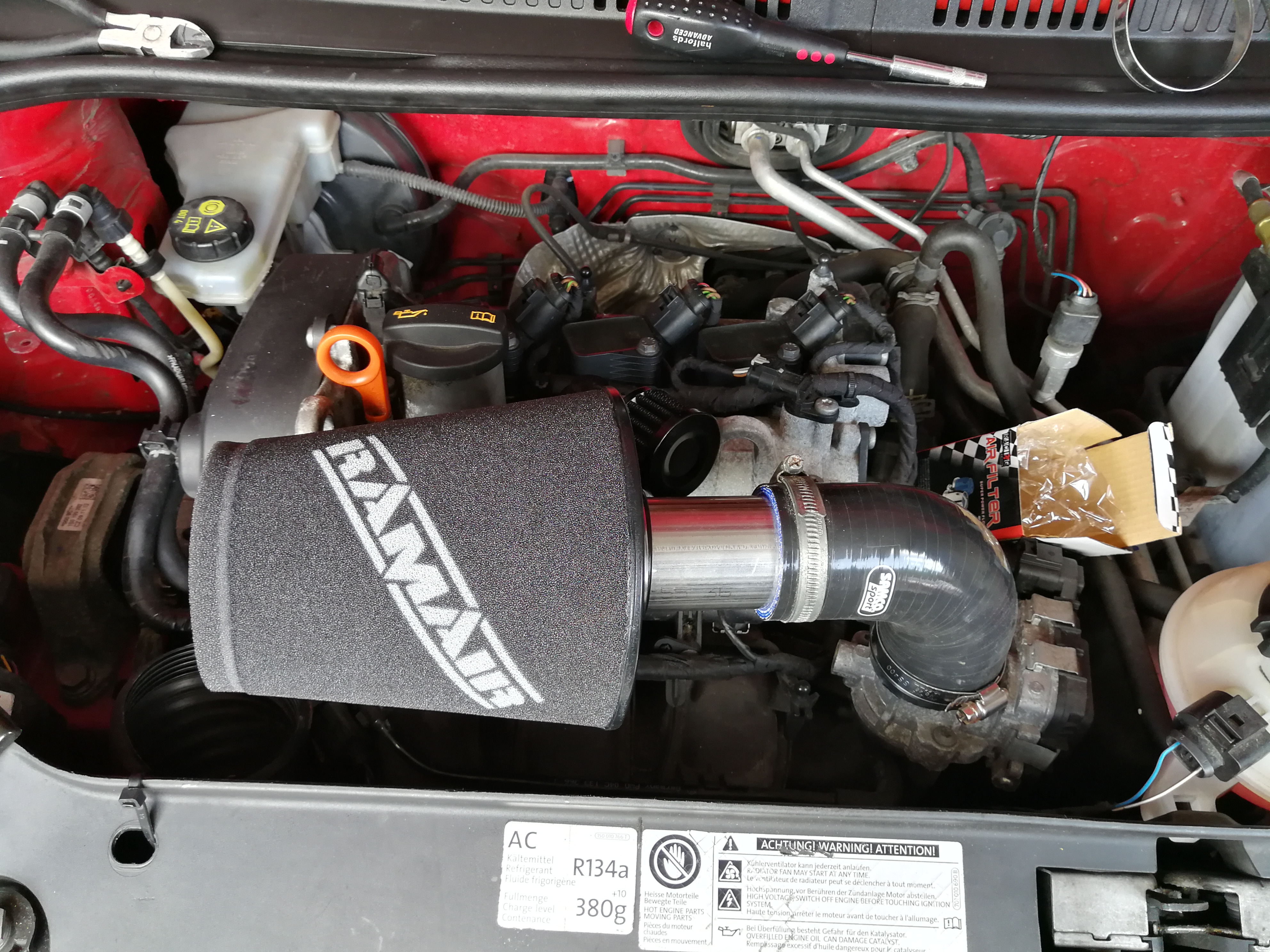

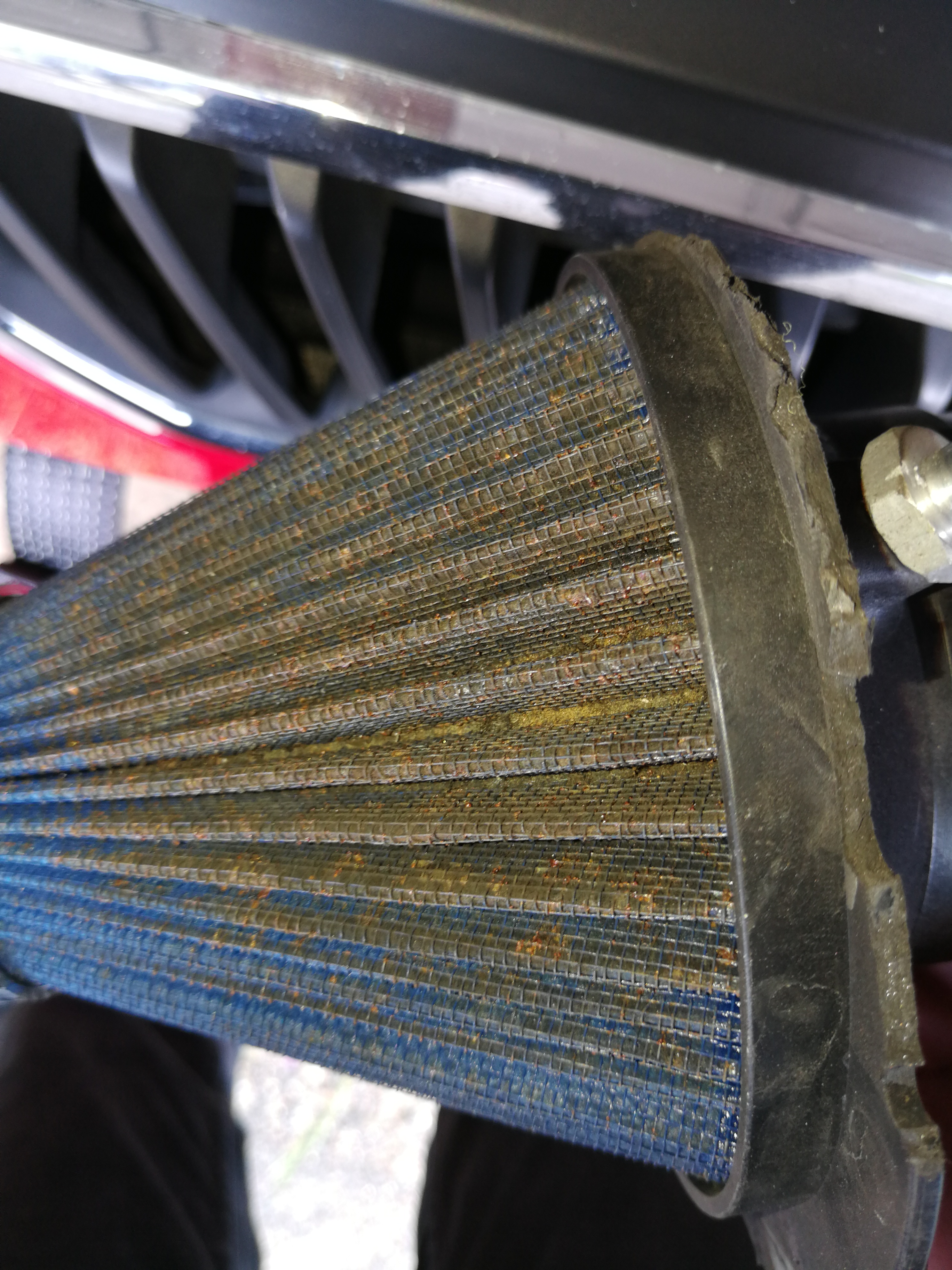

Got round to swapping out the filter today, this was much needed, its current position probably won't be forever, but the old one was in rubbish condition
Out with the old..
Which was in bad shape..
In with the new..
It's a little excessive for the size of the engine, but who am I to complain? :D it sounds a lot happier.
I can also report the rear anti roll bar is superb, it should have been added a long time ago

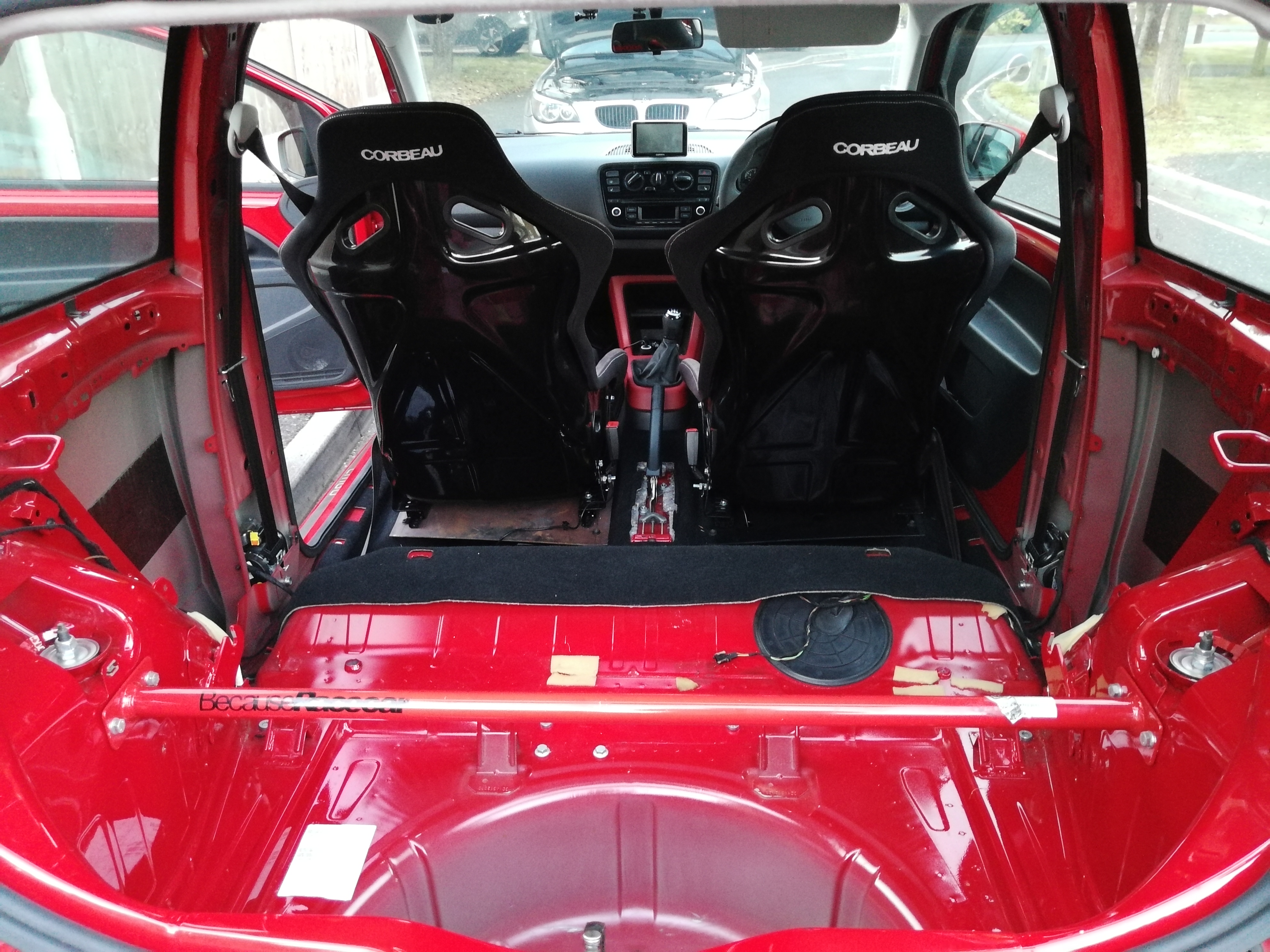

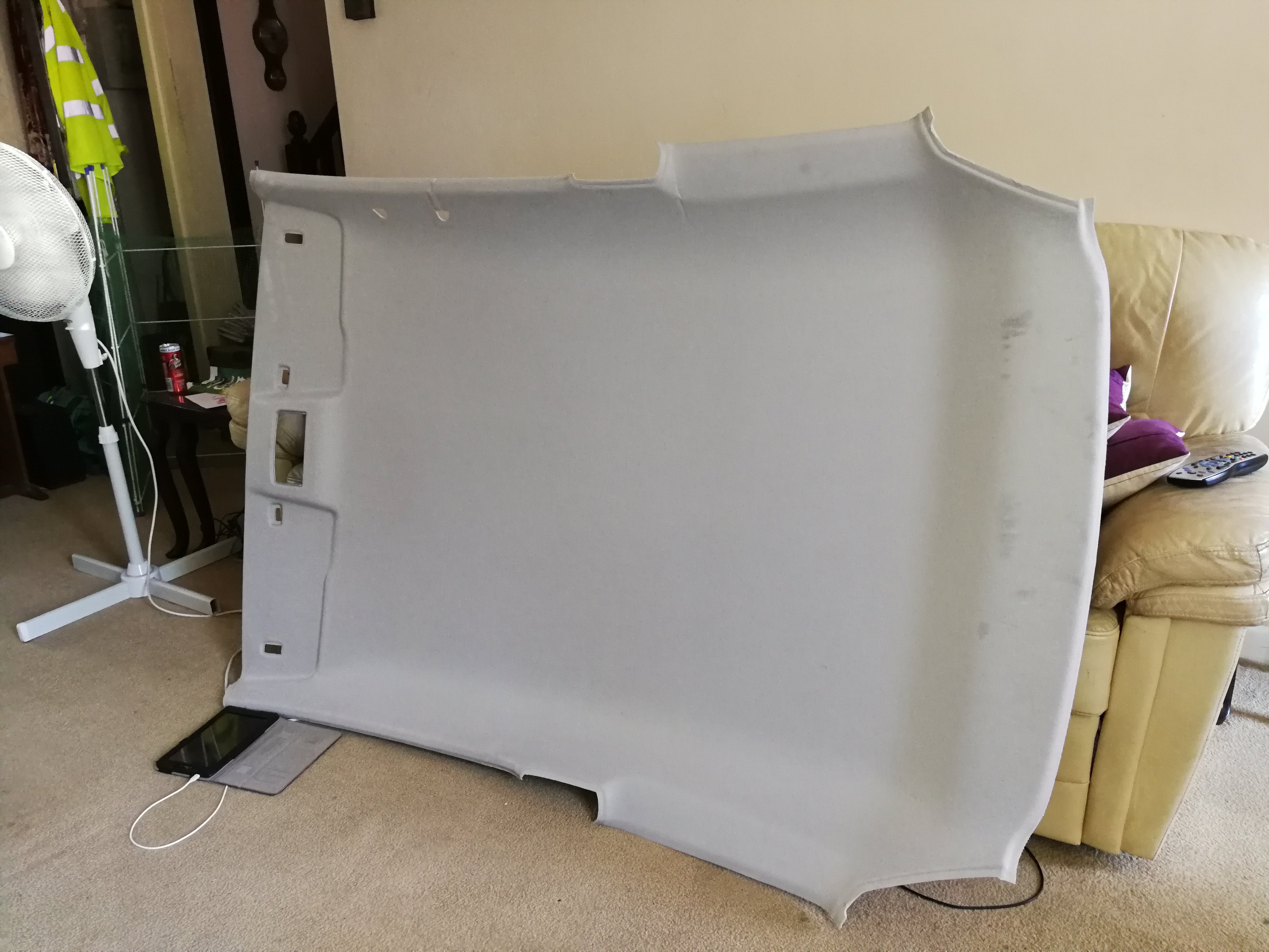

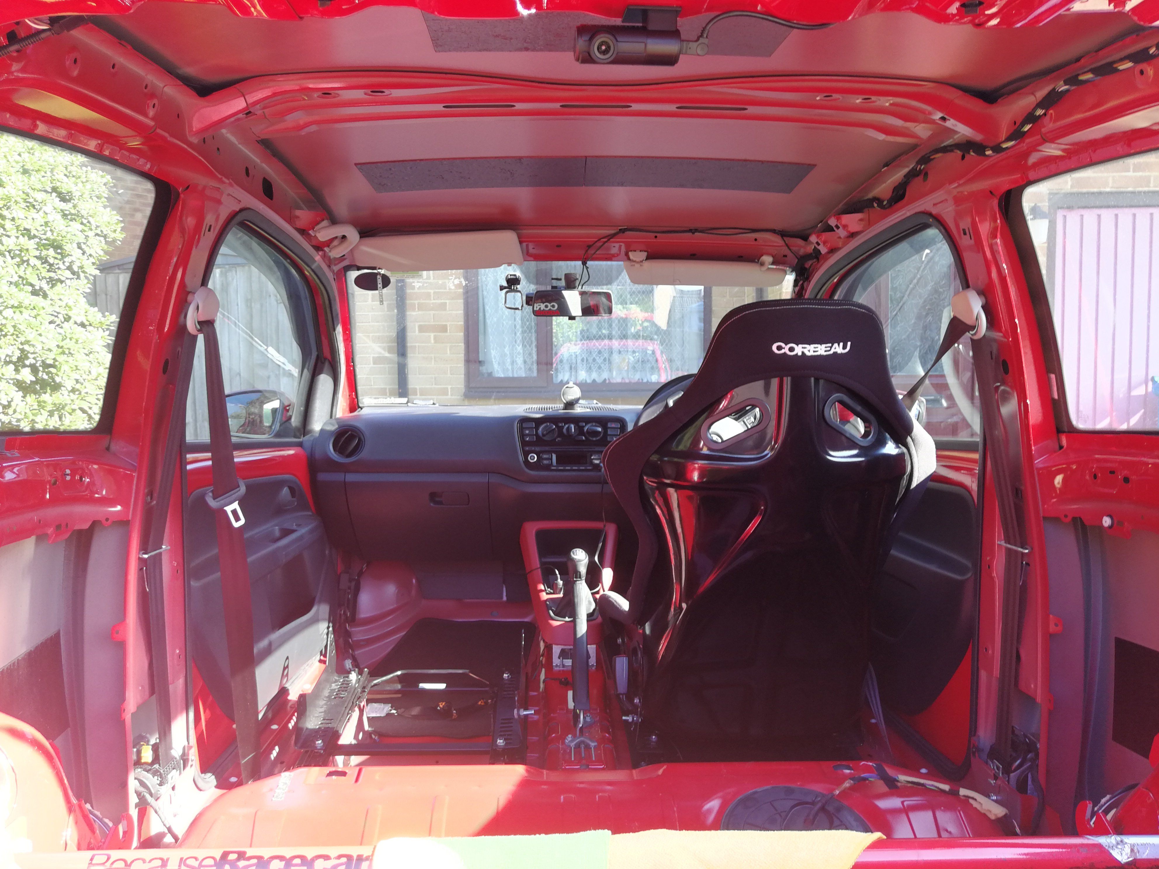

Decided to mess about and gut the interior a bit more :D
You'll also note the gear knobs changed back to the VW Up! one and I've fitted the passenger bucket seat ready for a track Saturday. I've actually ordered proper bases for them at a whopping cost of just over £300, but they haven't arrived yet, I was hoping they would've arrived today!

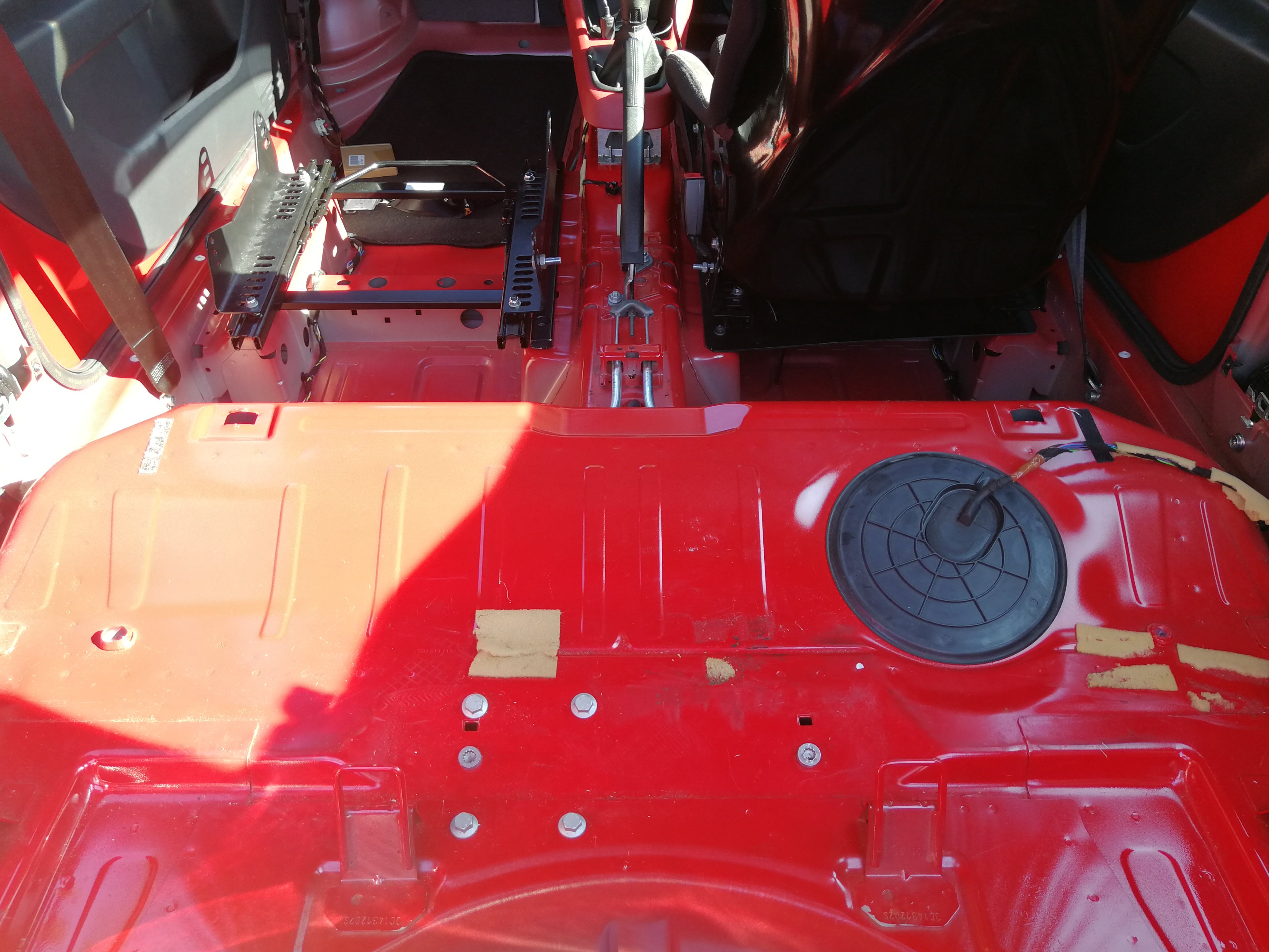

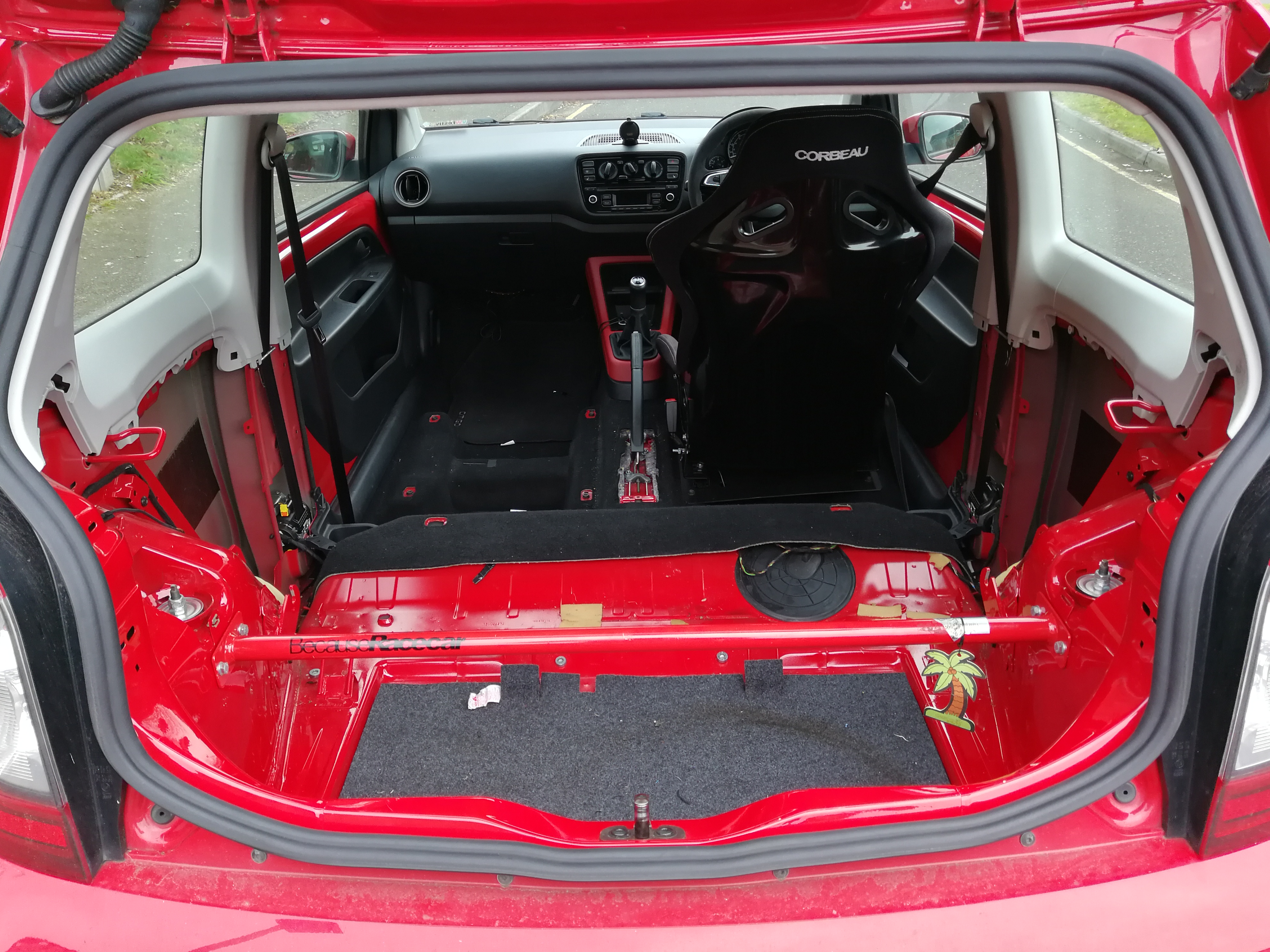

Stripped the car a little more :D
Might add the carpet and sound deadening came out too :)

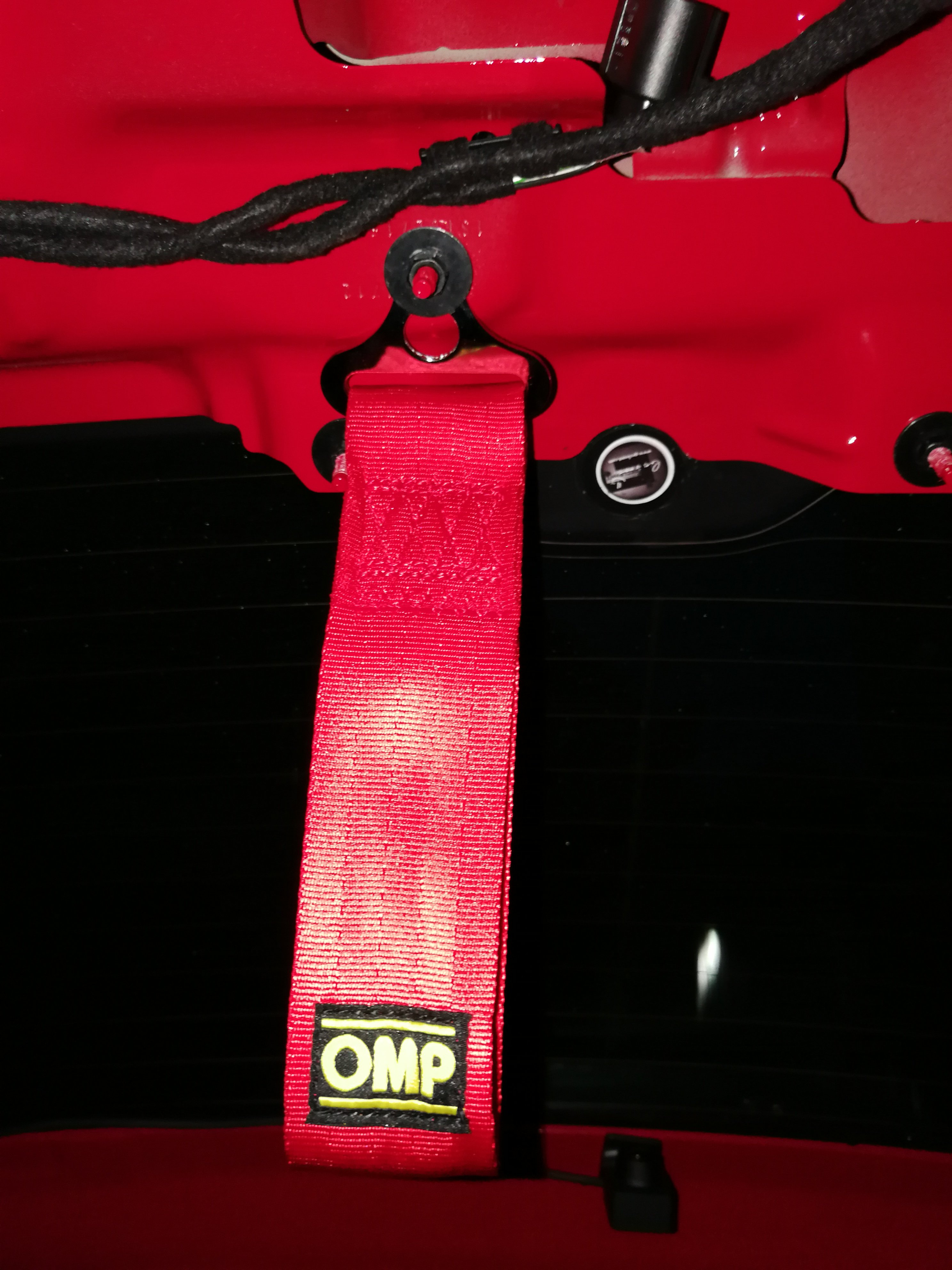

Having removed near enough all the trims in the car, I realised I had a new problem, closing the boot without putting my hands on the outside (I'm one of those people who literally can't stand hand prints all over the boot from where it's been shut :dull:).
Cue 1 spare tow strap and a void nut from where the wiper motor used to sit, what do you get? A new handle to pull the boot shut :D

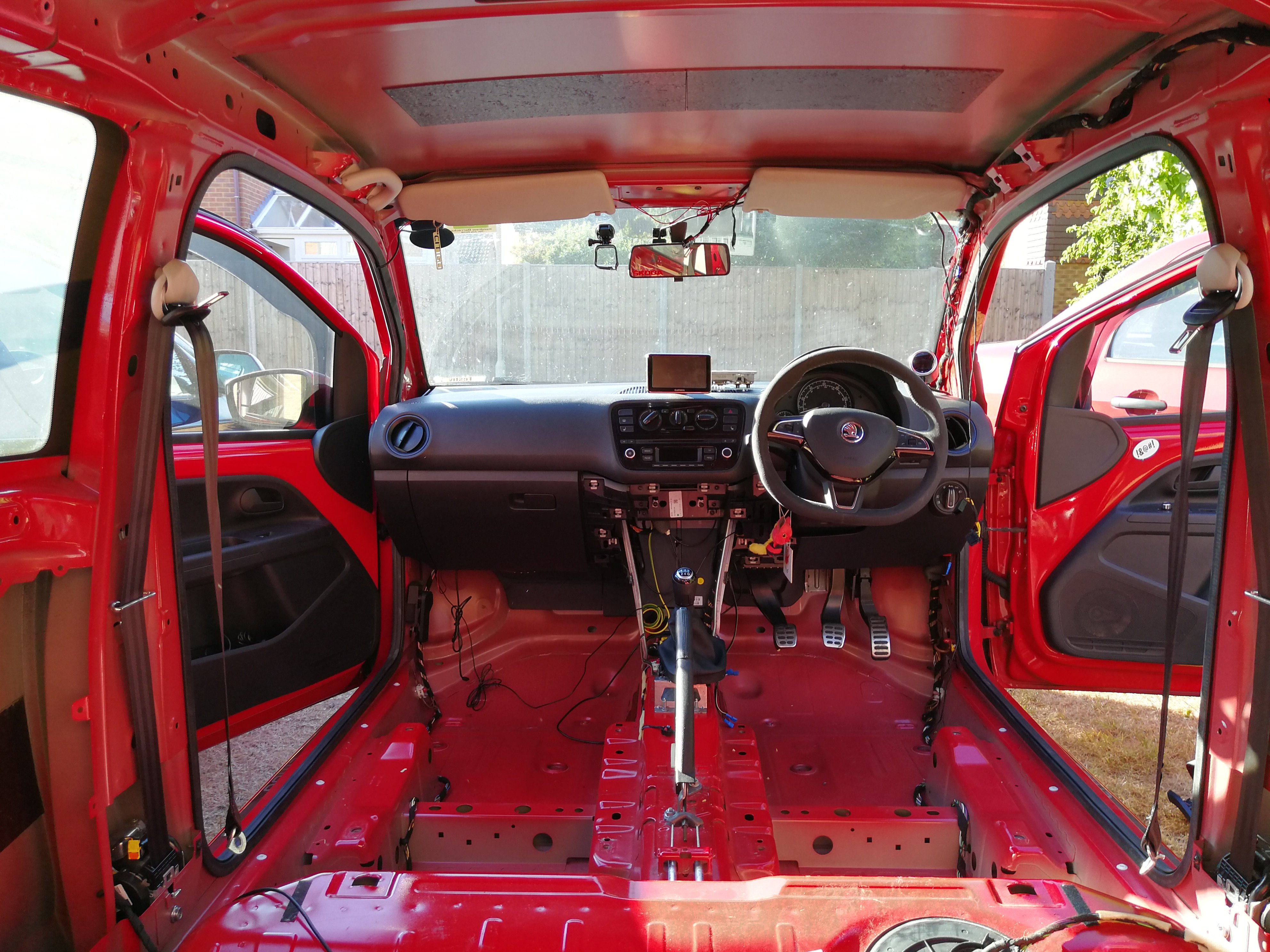

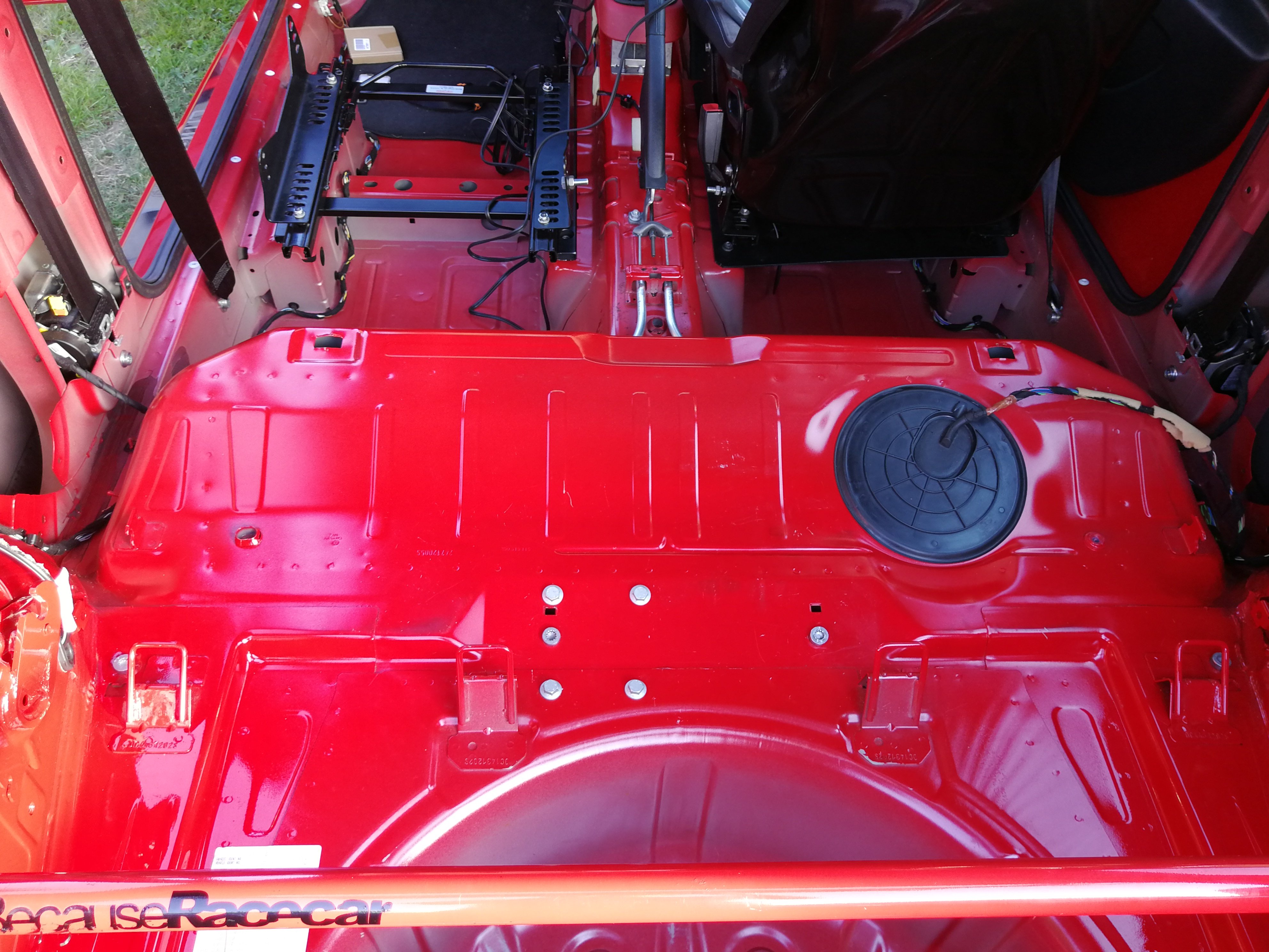

Bit of TLC done over the weekend, you'll remember in this post:
All the wiring dangling about the place, this was for the W8 light and the interior light as well as the dash cam front camera and GPS camera, all that wiring is no more
Used some cheap sticky back wiring clips to tuck the dashcam wiring out the way as a temporary fix, those with a keen eye will see there's a new dashcam, I finally replaced the absolute rubbish Koonlung front and rear camera with a used DOD RC500S, which is the same one I run in the Fabia
There's a bit of foam in the rear that's used to hold the rear seatbelt wiring in place, I finally got rid of this and took the no going back route of chopping back the rear seat belt wiring itself, this'll eventually be taken back as far as possible.
Before:
After:
You can also see the new seat mount on the passenger side that's fitted, I need custom side mounts made up as there an inch shorter than I need them to be.
Last photo for you, you'll spot the stupid and useless tow hook that I added ages ago has finally gone, this'll be replaced with either a strap or a tow eye, probably drilled straight into the rear crash bar, the rear bumper will need to come off for that
Looking tidy
Hey buddy, absolutely loving the build and where it’s going ! Great job
just curious as to where you got the rarb from ?
Thanks
