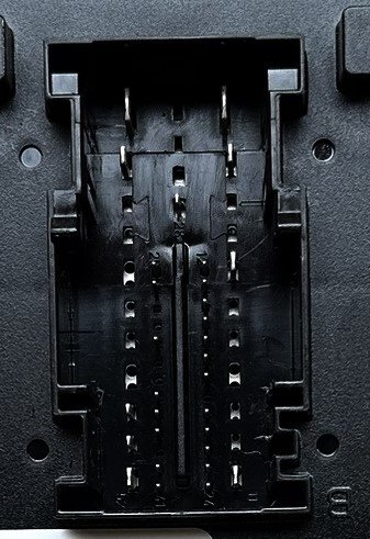

I know this is an old post. I have fitted all four lamps, connected the negative wires. Bought a pin 000979150E from eBay, I hope it's the correct one because he told me this will fit to PIN 50, which is a bigger metal pin. I have VCDS ready to activate but.......
I looked and I could not find number 50 on the plastic.
I took a picture to show, if you know which pin?

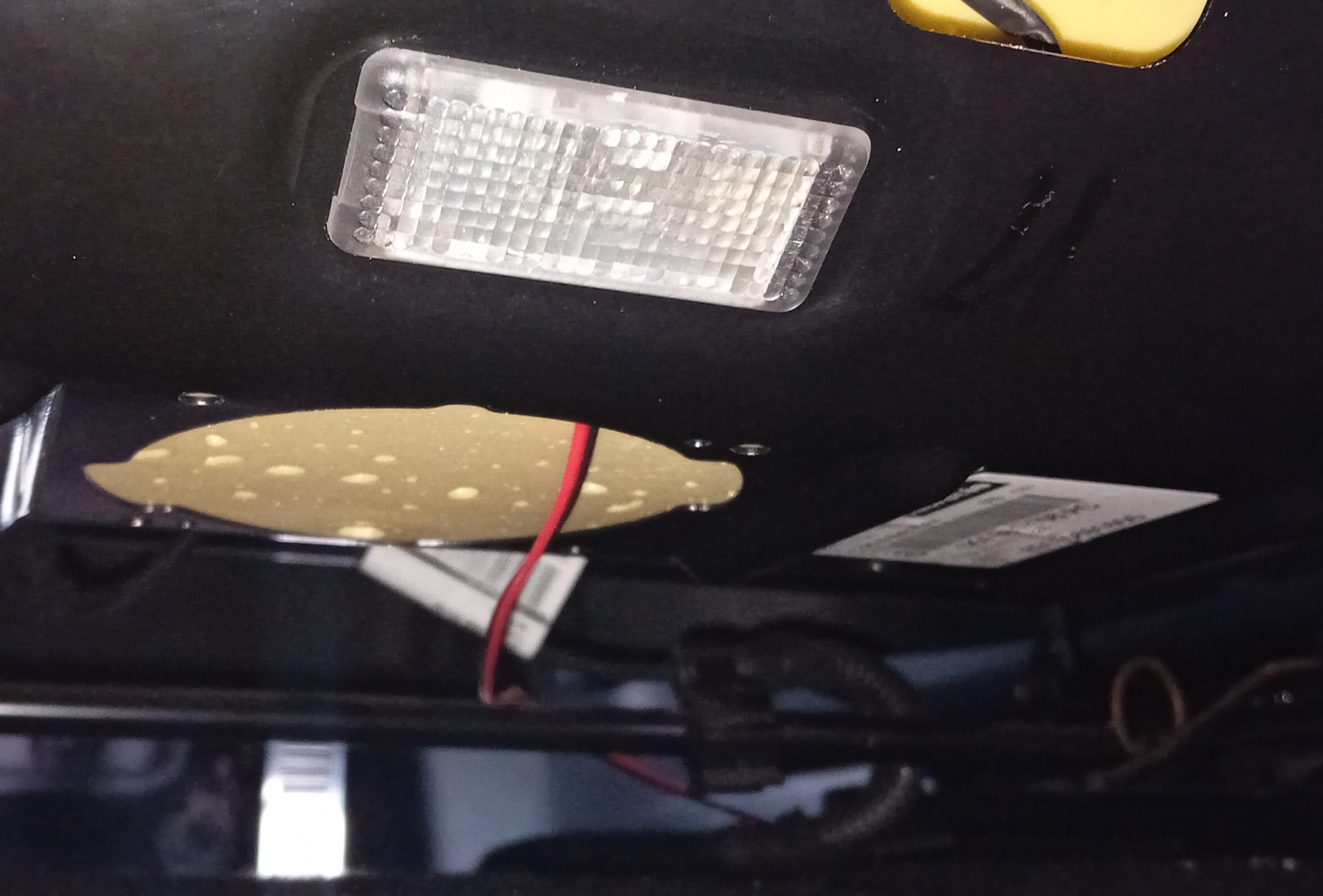

Where have you mounted the rear lamps? Could you please post a image?
Pin 50. From what I can tell from your picture, at the bottom of each row of pins there is a number and reading from right to left (I'm guessing a bit so check) 52, 41, 24, 11. These numbers relate to the last pin number in each row. So pin 50 in your picture is the row furthest to the right and the third pin counting up or to rephrase pin 52 is bottom right, pin 51 is one up above that and pin 50 is above that.

Here is a picture of the area under my seat.
Try do over the weekend.
Thanks. I have found the slot. I have the L&K with heated seats so there might be a plug in there somewhere.
Where have you mounted the front ones? Did you cut holes or is there an existing slot?
Kev.
I cut the holes under the far right on the driver's and far left on the passenger side, I saw this a few months ago.
