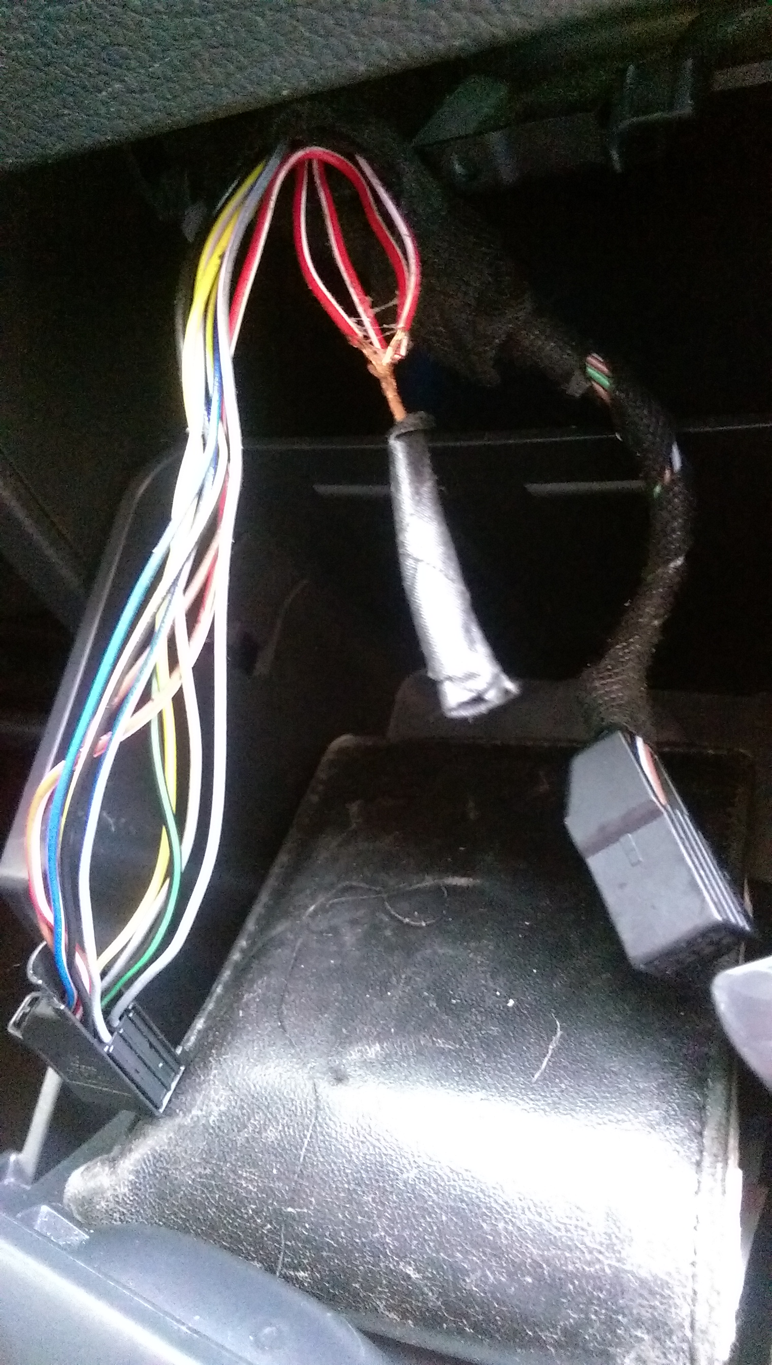

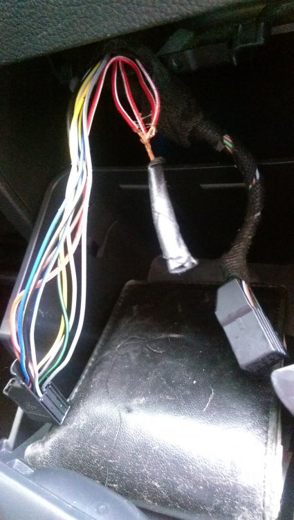

Myself trying to sort my auto lights...have all what its need(incl.a.switch) but just now reakise that i need to have a 10wires in my plug
 So my plug have nine wires...
What I should do next now?
Have the vcds as well.thanks for any info.
though there is like some hiden wire ...but i recon this red one is a power?IMAG0044.jpg
Edited by szamoT1984

As for those red wires, has a pervious owner added something? Might be worth tidying that up or at least covering the exposed wiring.

 Well all the wires myself opened from black tape.,though there is a some cabel (missing 10th wire) under that iso. tape..anyway all looked like fabric covering of wires. i don't think last driver did anything.
at the moment Im takin off the trims..then will tray do the wire...i 've few parts left from A4 parts what i did some mods as well..have some plugs switches...bluethot. hope find proper contector

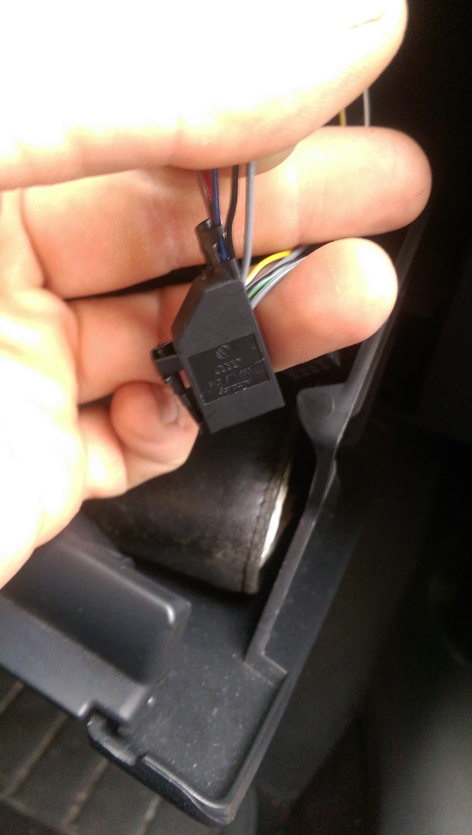

I have to get the wire.wonder if the two ends of that wire have same lookin end/pin??
Lookin at the light switch plug the pin nr2 looks smaler then the pin52 in BCM plug..?
Yup, I believe they have identical connectors on both ends :)
