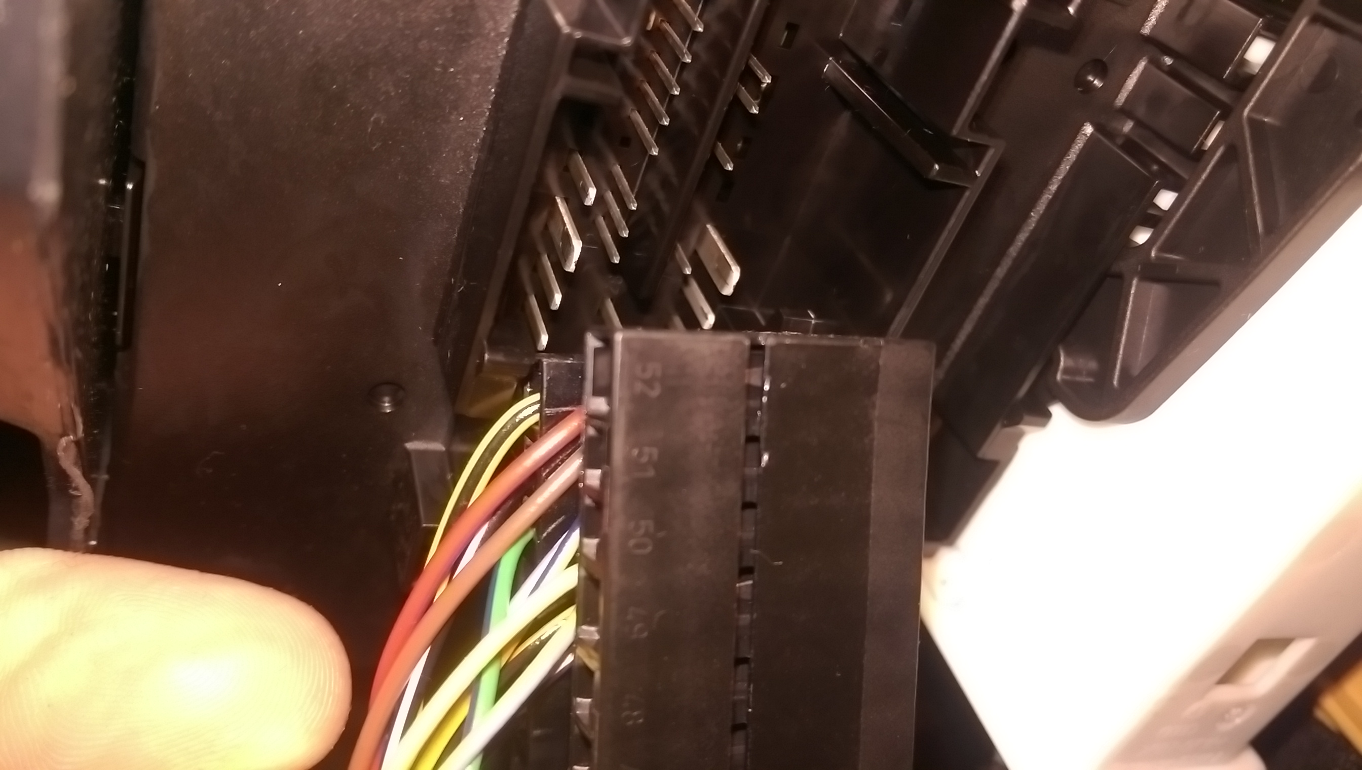

 Ok....when i take of the black plug (female) from BCM i cant see any male pin in the BCM on position for 52pin
Any ideas lads?
Edited by szamoT1984
Any ideas lads?
Try pin 20?
T52aa/20 means connector t52aa, pin 20 :-)

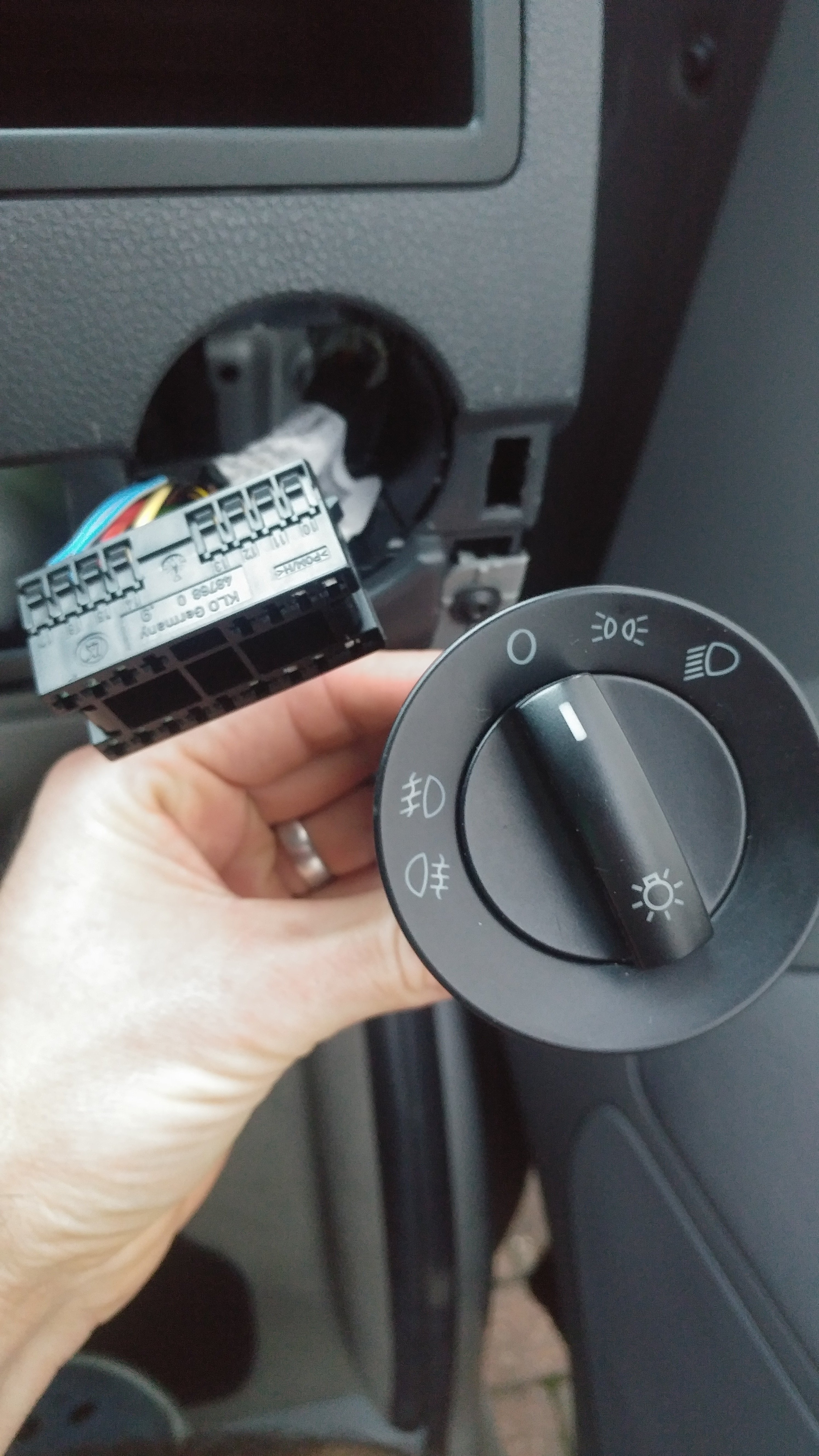

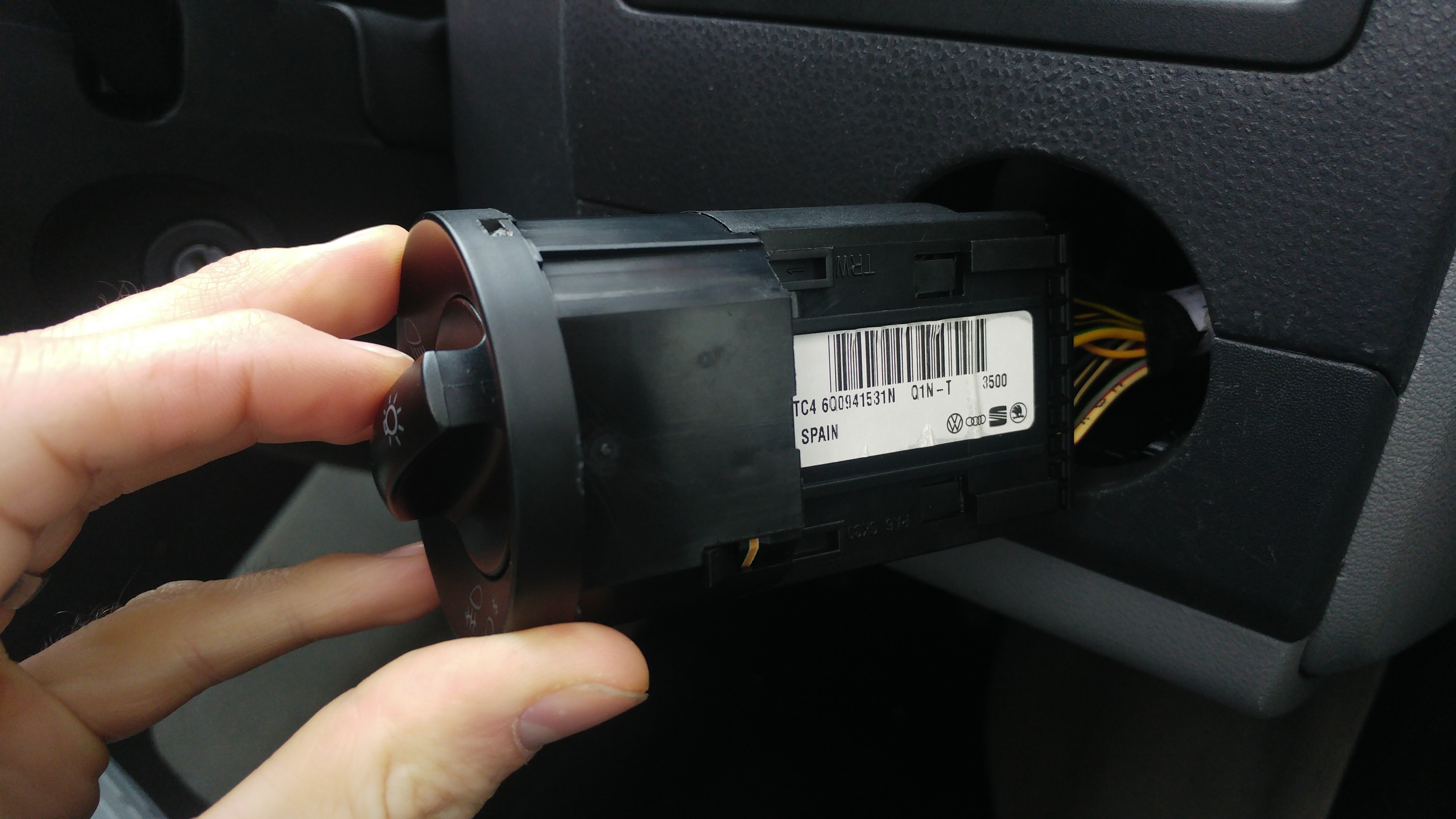

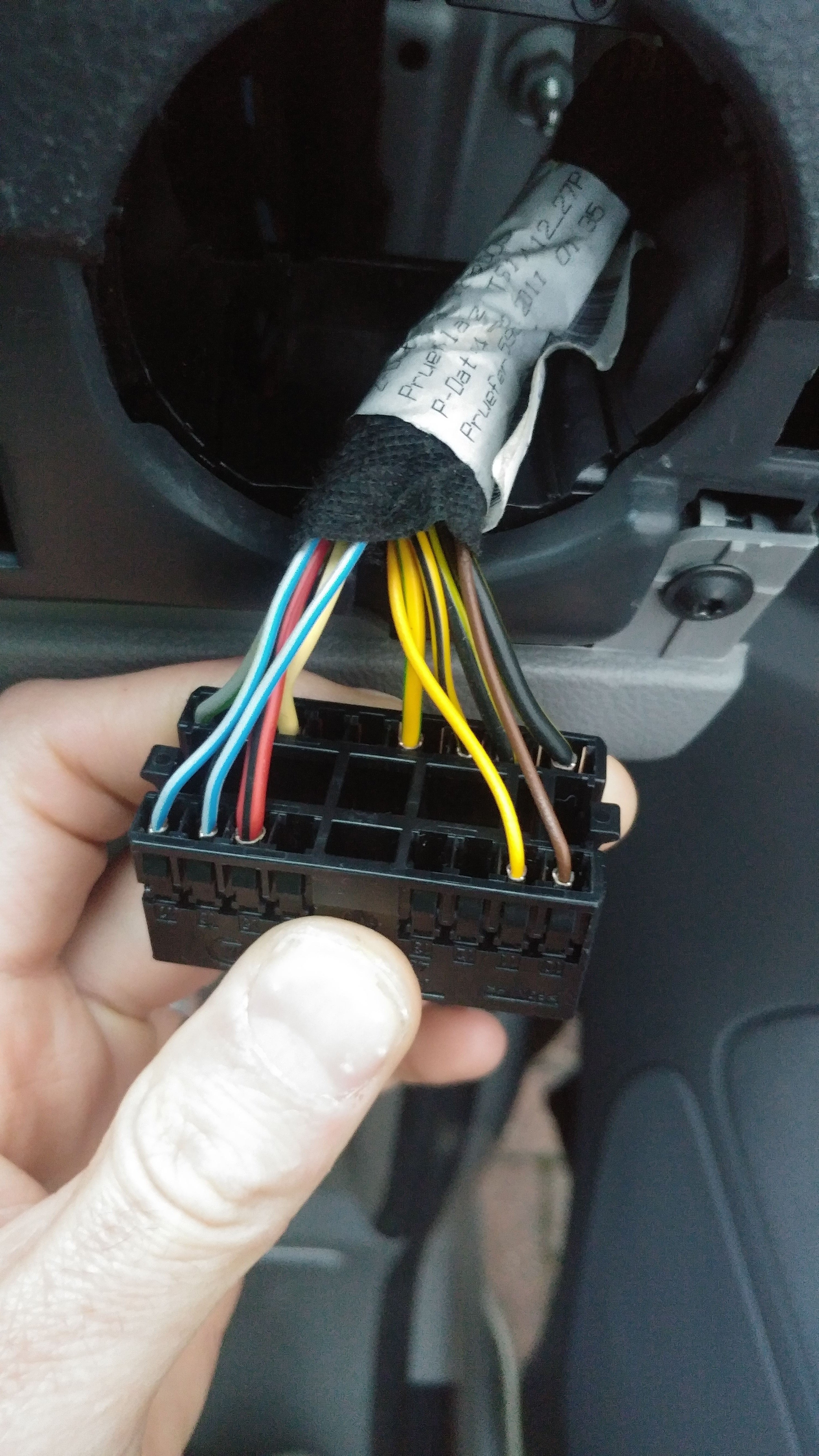

Sorry to jump the thread. I'm looking at changing the headlight switch to gain auto headlights as I already have auto wipers and dimming mirror.
I have a 17-pin switch though, and so far I haven't been able to find an auto replacement yet.
@langers2k, are you able to help me identify whether I need an extra wire between the switch and BCM? Also, if you have access to ETKA, is there an auto version of the switch available for my vehicle...
Catch is it's a 2011 VW Caravelle (T5.1) 😜
(The T5 guys aren't nearly as helpful as you lovely Briskodians!)
I've attached some useful pics. Thanks
Not sure an auto 17-pin auto switch even exists 🤔
I was trying to do it OEM using the factory fitted sensor. Will this be compatible so I don't have to use the seperate sensor?
Looking at the pictures it includes a separate sensor
@mrhappy - I don't think there is a 17 pin light switch that supports auto lighting, I certainly can't find any obvious reference to one, nor does the wiring diagram give any clues. It's also suggested the sensor may only be a rain sensor?
I think the aftermarket kit is probably the best plan if you want auto lights :)
I didn't know if it was just a rain sensor, but a friend suggested it might be both as the mirror is auto-dimming.
I think you might be right about the switch though so looks like I'll have to go aftermarket. Thanks for looking into it for me 😀
