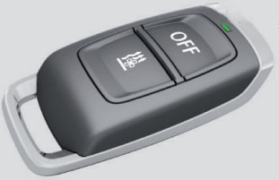

From the manual, page 107:
"The auxiliary heating heats the vehicle interior as well as the engine. For heating, fuel is consumed from the fuel tank.
The auxiliary ventilation enables fresh air to flow into the vehicle interior with the engine switched off,
whereby the interior temperature is effectively decreased (e.g. with the vehicle parked in the sun)."
If you have auxiliary heating, you should have a button for it in Climatronic and a remote controller.
I think the supplementary heating is a electrical heating element (PTC) as mentioned earlier.
