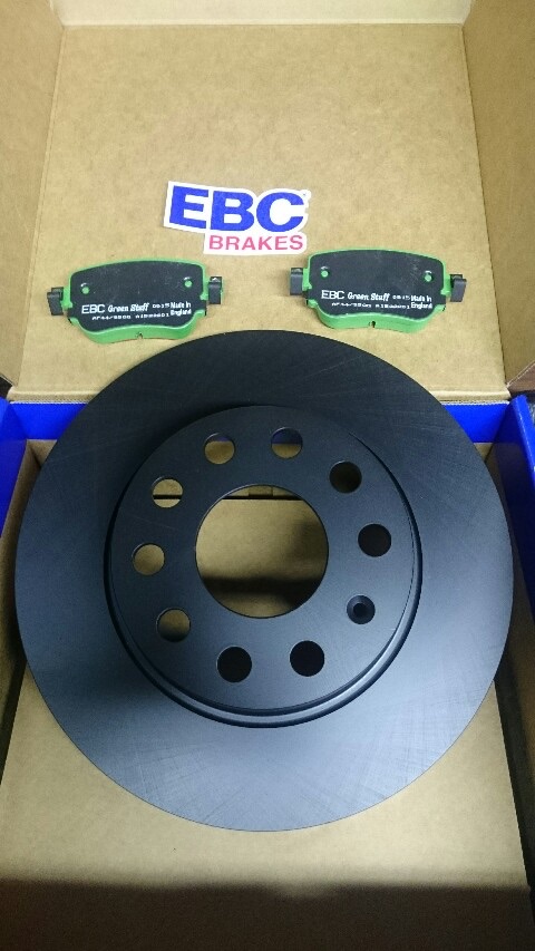

I've just replaced the discs and pads all round on my 2.5yr / 40K mile VRS. In truth only needed to replace the front pads, but when doing it myself it was considerably cheaper than the main dealer.
Whilst replacing the rear pads they were seized in place. The pads were approx 50% worn, but the discs were heavily corroded. This has been a common trait across all of the VAG cars that I have owned (Golfs, Leons, Octavias). Unfortunately if the pads seize they become a lot less effective, and thus corrosion on the rear disc surface is a lot more prevalent. This problem is amplified if using a jet wash / alloy wheel cleaner which strips the lubrication away in this area, and/or you then leave the car parked up for several days at a time or do not brake hard enough to activate the rear brakes. I note that your dealer is in Aberdeen - assuming that due to the climate the roads are heavily salted in winter / live near to the coast this will also have an environmental impact in corroding discs.
In terms of have you been done, the brakes were not working as effectively as they should - whilst a strip and clean would probably have sufficed to pass the MOT test, you now have the peace of mind that should you need them, the brakes will function as they should. The ESP / post collision braking systems require all wheels to have sound braking efficiency to function properly.
