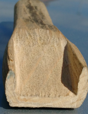

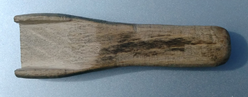

I have a Fabia III with the 4 H7 bulbs and the LED DLR/side light bulbs.
When I changed all mine to Osram Nightbreaker's I tried this.
I made a spanner/lever out of a wooden wire brush handle and cut it out to suit to back of the bulb holder.
The main beam/inner bulbs are a little easier to remove than the dipped beam /outer ones.
Tighty righty and loosey lefty but from behind.
I took out a Main beam bulb holder first to use as a guide and then cut the in to the wooden handle at about 30 degrees away from the handle length.
This was because you can not put it in side on as the headlamp housing is in the way.
The hole/slot/cut in the handle is about 20mm wide and 20mm long.
Before refitting them I also put a very small amount of grease on the two lugs that attach to the bulb holder to the headlamp housing.
This will make it easier next time I need to change them.
I also found that the headlight aim, when set to zero inside, was as low as it could be on a MOT headlamp aim tester.
They have now been adjusted to as high as they can be on a MOT headlamp aim tester.
This improved the lights a lot.

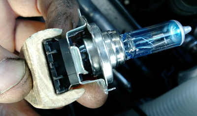

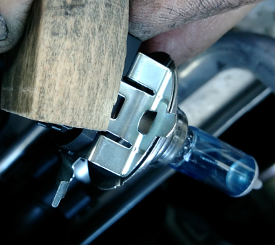

Hope this works, Here are some photos of my tool:-
Note how the slot is deep enough to touch the metal parts of the bulb holder.

AG Falco.
 Thanks for the photos.
 Appears much nicer than the effort I tried in metal..
Well done,  hope others will find your tool to be the answer to .a  difficult problem.
