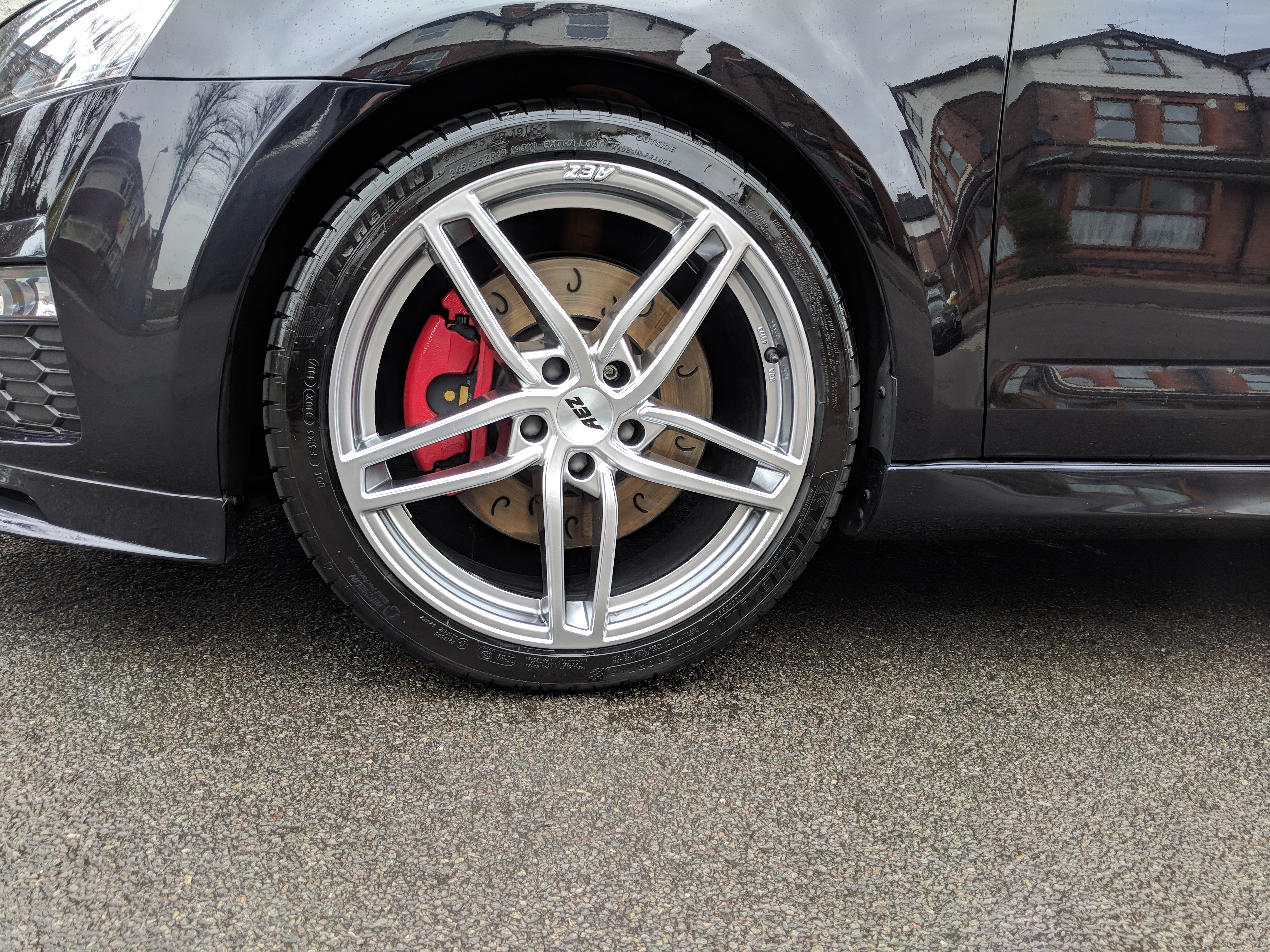

Liking the new Xtreme wheels you've fitted

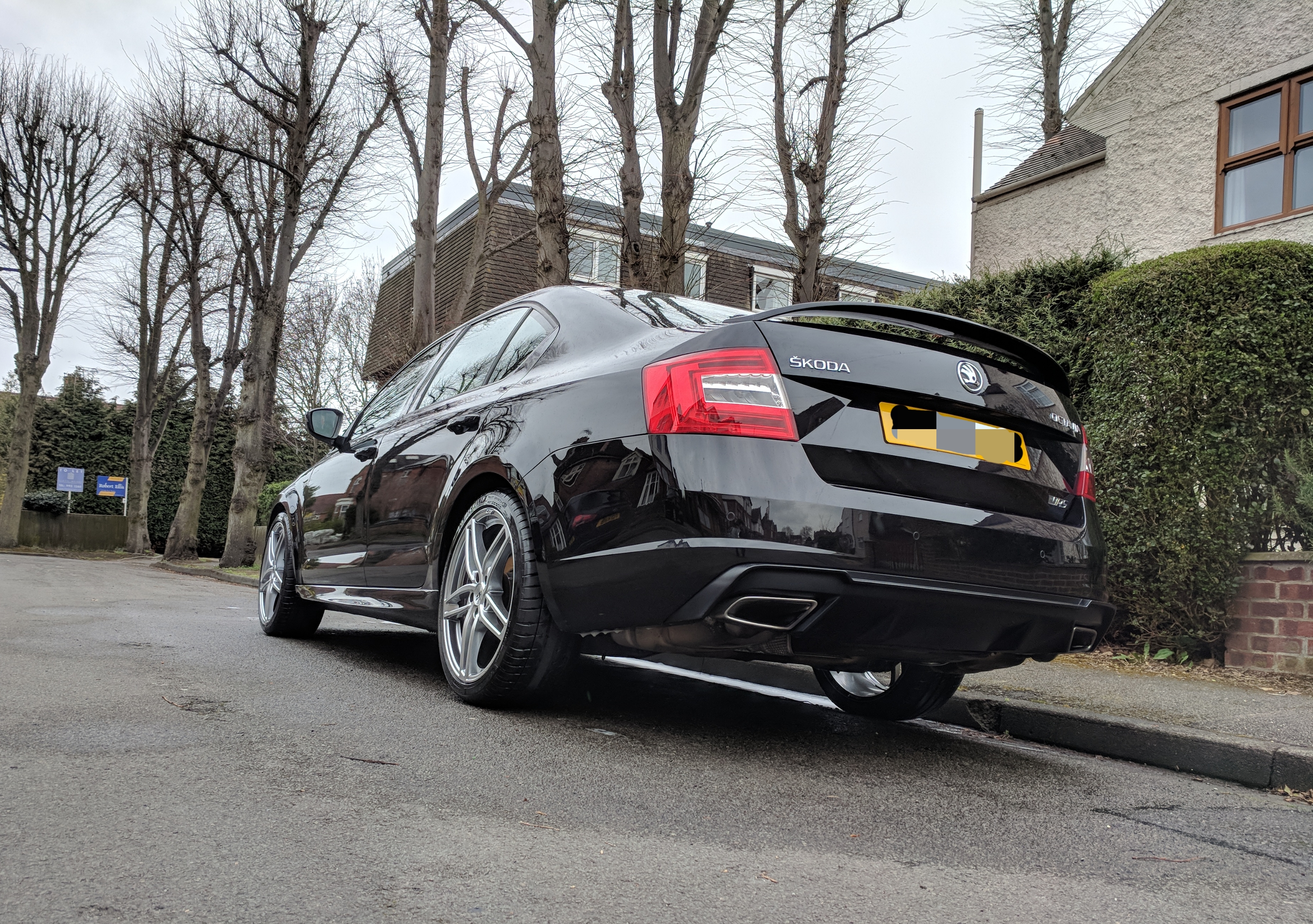

    Rims and hight look spot on with set of the right spacers to bring the rims out to fill the arches would realy make it pop especially on the rear..
Yeah they're quite nice looking, but unfortunately not wide enough, so I'll be selling them over the winter period.
I want to buy a wider rim with a smaller offset, so that I can increase tire width and push the wheel out for a better look without needing to go for spacers.

Been a while since ive made a post and several things changed
1. Side skirts finally fitted (Rieger Tuning)
2. Forge carbon intake
3. And picked up new wheels for the spring!
Edited by Magget
This looks spot on. Nice and tasteful mods!

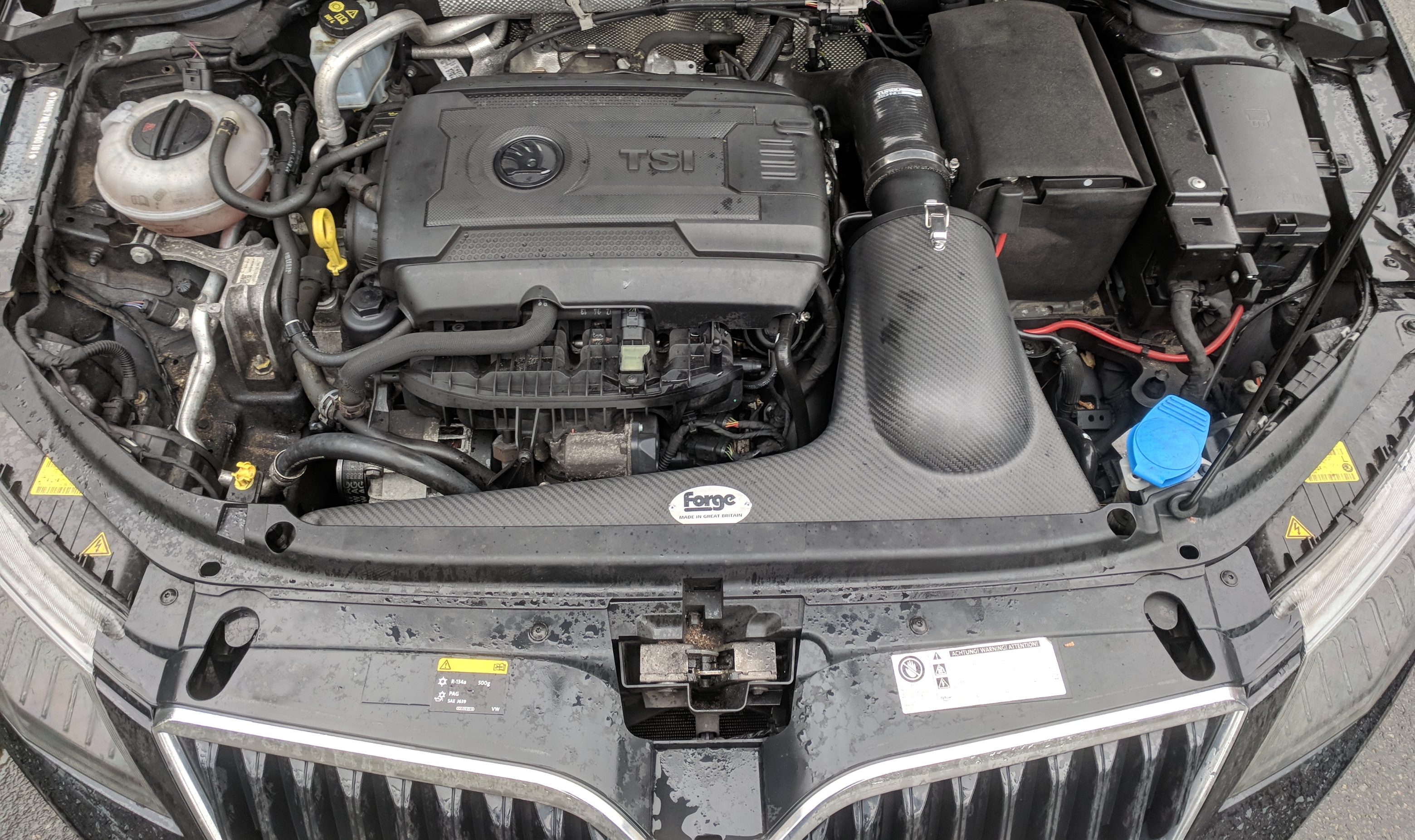

Any plans for dyno with forge intake? What does it sound like compared to standard airbox and can you feel any difference?
I'm waiting on a Shark or VRS Northampton Dyno day if I'm honest. Don't plan to do it before that.
If I'd say I can feel any hp increase I'd be lying, as we're talking a few hp difference, if any at all. But the main difference is the sound as turbo flutter is quite loud. Enough for me to hear it in first 3 and occasionally 4th gear as well when coming on or off boost, and that was the main reason I wanted to buy one. I live in a quiet street and leave really early every morning, so an exhaust wasn't really an option.
The car also revs a bit more freely, so there's less hesitation when stepping on the accelerator, which makes the car a lot more dynamic and fun.
So I'm really happy with the purchase.
@Magget how are you finding the BMC panel filter and what made you go for it over Ramair, K&N, etc?
Am I right in thinking there's no MAF sensor on the newer EA888 engines so oiled filters aren't so much of a worry now?
Hm long story actually. I've been a big BMC fan for years. I've had their CDA intake on last 4 cars and a BMC OTA one on 2 more, and I never had any issues with any of their products. So once you're happy with a brand there's no real desire of need to test other ones. Also living close to Italy made BMC a lot more accessible than k&n or ramair. I've also had and wanted an enclosed system fed by outside air directly, so open cone options, even with heat, shields were never something I looked at. Just a personal preference really.
I've tried the CDA on this car as well (early posts here) but the dimensions of the thing prevented me from doing a proper install as I had no room for inlet piping and it had to rest under the OEM inlet scoop and it didn't have a vacuum line attachment which is on the OEM box, so it wasn't great.
After that I've started reading up on the ea888 and found out the box is not a bottleneck as it's designed quite well (at least until you go past stage1). The biggest problem with our engine is the turbo inlet (has a narrow neck) and the pipe connecting the inlet and the filter box.
After some research I took the TurboTechnics inlet pipe, which replaces both parts. Most other brands required a 2 part install (inlet + pipe), so I went with that.
And as the filter box wasn't a real issue, I kept it and replaced the panel filter, and removed the snow guard from the box to free it up a bit. Again not dynoed just the panel filter, but it's definitely less restrictive then OEM paper one. It's been great. Had it for 2 service intervals, meaning I cleaned and oiled it twice, and had 0 issues.
I wanted to buy wwr one since my BMC CDA days but it was waaaaaay to expensive, so I never went with it. But I got a good deal on the forge one, so I couldn't pass the opportunity and went with it for the sound.
About MAF sensor... BMC comes pre-oiled and I couldn't find any reported problems on ea888. And as long as you follow the BMC cleaning and oiling procedure, and not absolutely soak it in their oil, it will be fine.
Btw I still have my panel filter and cleaning kit if you want it or want to try it.

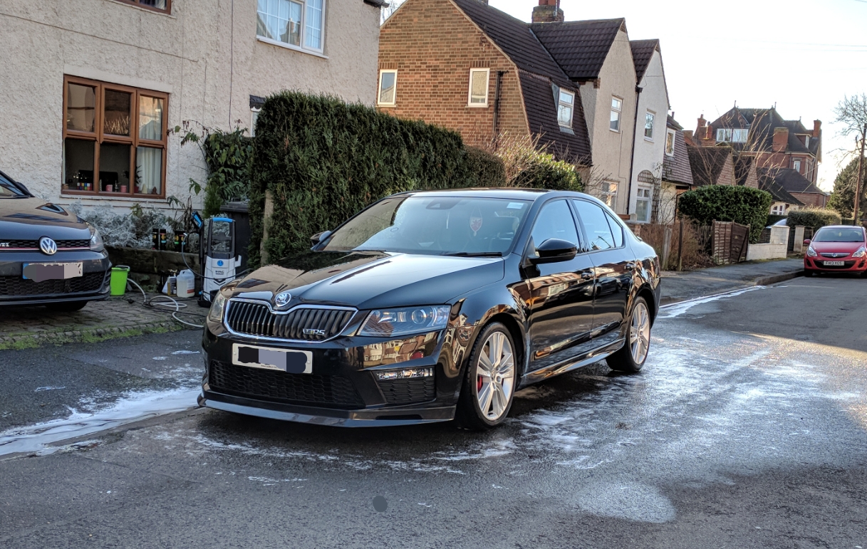

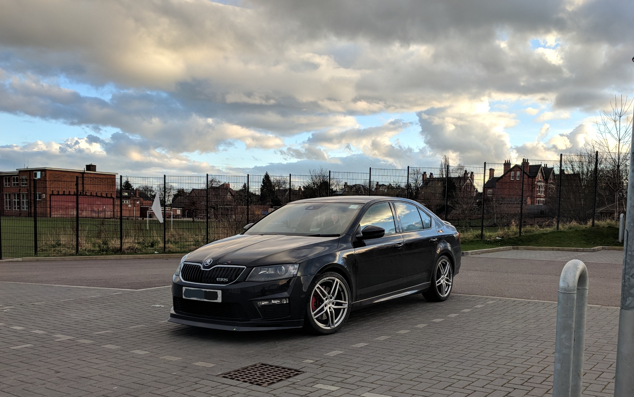

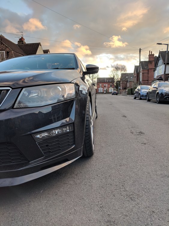

Summer shoes on. Better pictures to follow after the first good wash, but for now, these should do.
Finally washed the car after several weekends of rain, and tested also how the gtechniq C5 works. It's amazing I didn't need to use the wheel cleaner but just spray on snowfoam and brushes.
