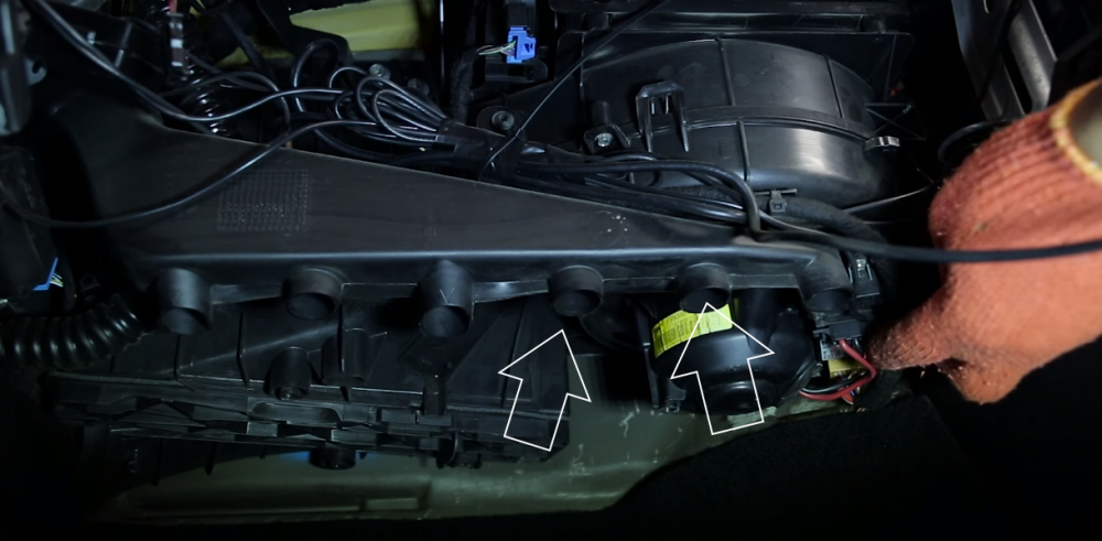

  • Didnt have to remove a thing other than the fabric stuff held up by 2 stud things.   pressing the heater pipe forward really helped, put fingers in where arrows are in photo and pull lightly

The replacement of the blower was straight forward.
Took off the sound proofing fabric and twisted the blower and with a little bit of wiggling it came out.
It helped by pressing the passenger air feed pipe (for heating and cooling) behind the glove box towards the glovebox by 5-6mm.
pressing the heater pipe forward really helped, put fingers in where arrows are in photo and pull lightly forward 5-6mm while dropping the blower out.

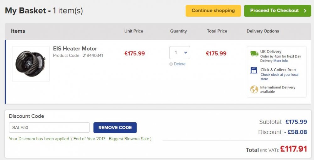

ECP had the part above in stock and I got the usual £60 discount using that days special code, and fitted the new fan in the car park outside in 5 mins. Refitting was slightly fiddlier as it requires a little finesse to get the fan properly seated, but it was a no-tools quick swap.
Dealer wanted £75 just to inspect the fault and also told me a 5 week wait before it could be booked in! Entire thing fixed in under 1 hr including drive time to the local ECP, and £110. If I'd been more patient and not had a 300 mile drive in this cold weather the next few days, then I could have sourced a used one off eBay for £50
