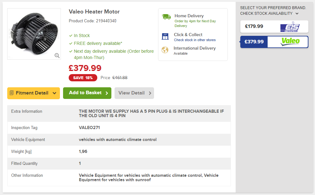

As silver1011 says, yes - that's a good price for the Valeo - especially as its the automatic climate control one (seen a few people get caught out by cheaper options that turned out to work only on manual aircon cars). The cheapest I'd seen that one previously was circa £250. On a good day the Valeo is north of €300 if bought here in Ireland. If I wanted the Valeo blower, I'd pull the trigger on the one you have found.

3 hours ago, silver1011 said:
That's a good price for the Valeo.
This is Euro Car Part's non-discounted price, but its significantly more expensive...
https://www.eurocarparts.com/heater-motor
Maybe thats the same item as Skoda would have supplied?  I snapped up the one I found and it was cheaper by the time I ordered it by another 4% discounted winner winner, chicken dinner.
