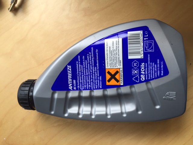

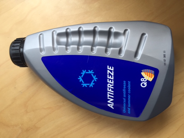

I'm not sure what happened next but I believe I topped it up with water and then later on I potentially added about 300mls of antifreeze from a bottle of blue BS 6580 Antifreeze. Although I can't remember if I did this I recently found a bottle of the antifreeze stuff in my car and I can see i've used some of it?!?
I then had a Major service in January 2015 at Halfords which I believe involves replacing the engine coolant.
Now back to the present: last week I was looking under my car bonnet by chance and I have noticed the red coolant level is below the minimum line again.
And I have a few questions if that's ok:
1) Can I top up the engine coolant with my bottle of blue BS 6580 Antifreeze even though my coolant is red at the moment? And do i need to add water to adjust the concentration?
