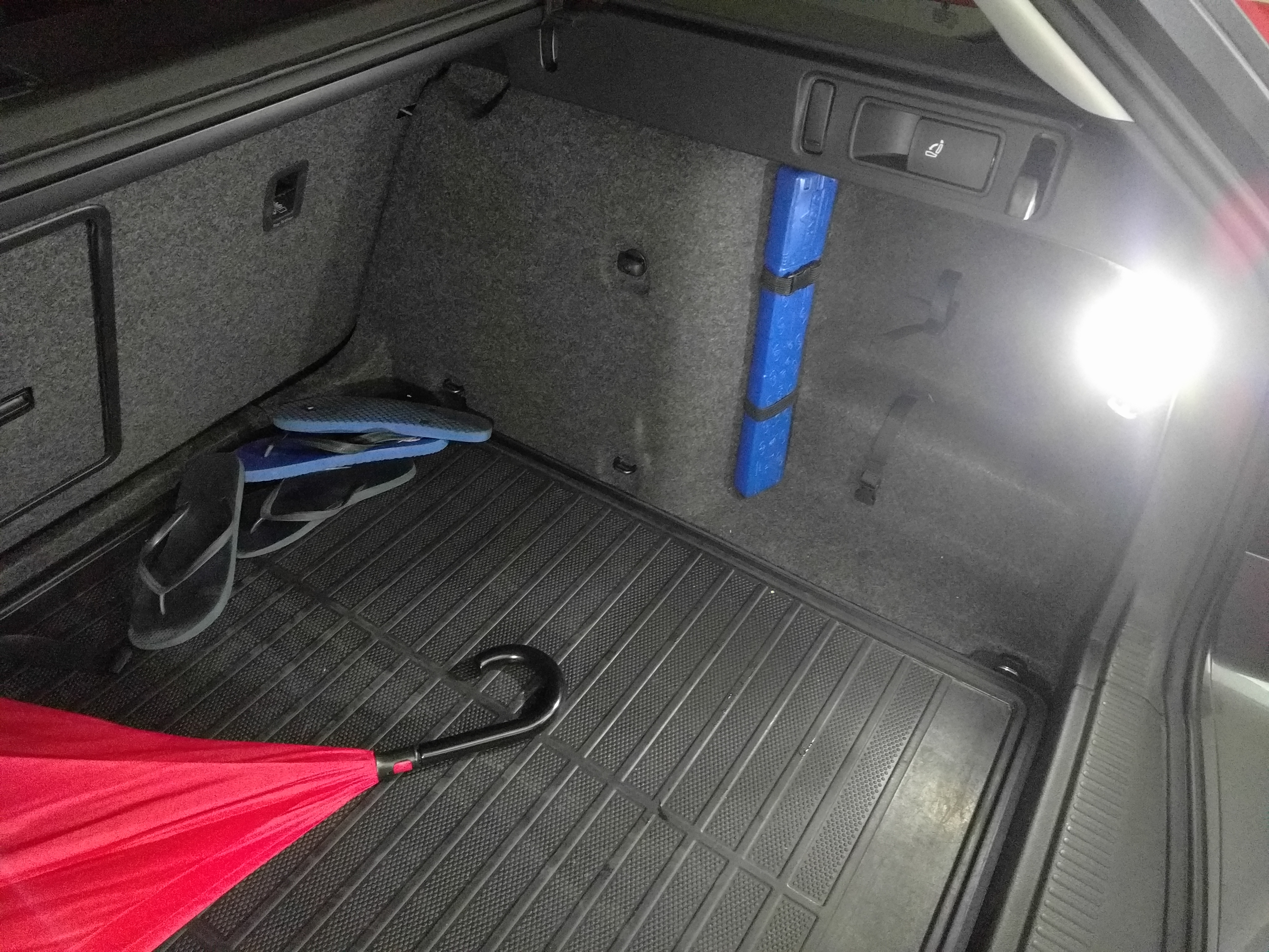

  • I have those - they are damn bright How to put it... When I open the trunk, it seems like a game in a stadium is about to take place
  • Checked (by me) and they fit. And you don't need the additional heatshrink tube as the LED electronics can't get in contact with the bulb holder. Also fitting is much easier than in the boot lights a
  • I also have the Superskoda lights, they are fantastic and plug and play fitment.
Superskoda lights here. BRIGHT!!

Superskoda ones installed. Bright :-)post-147116-0-23649600-1479026883_thumb.jpg
