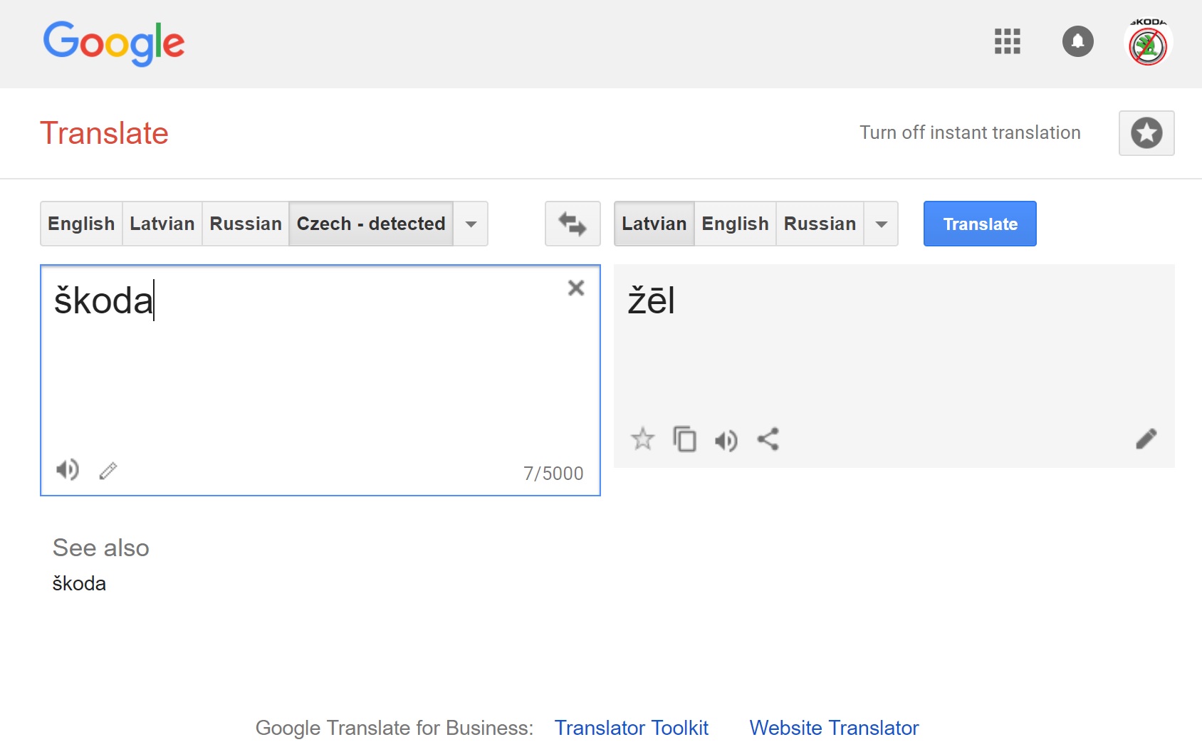

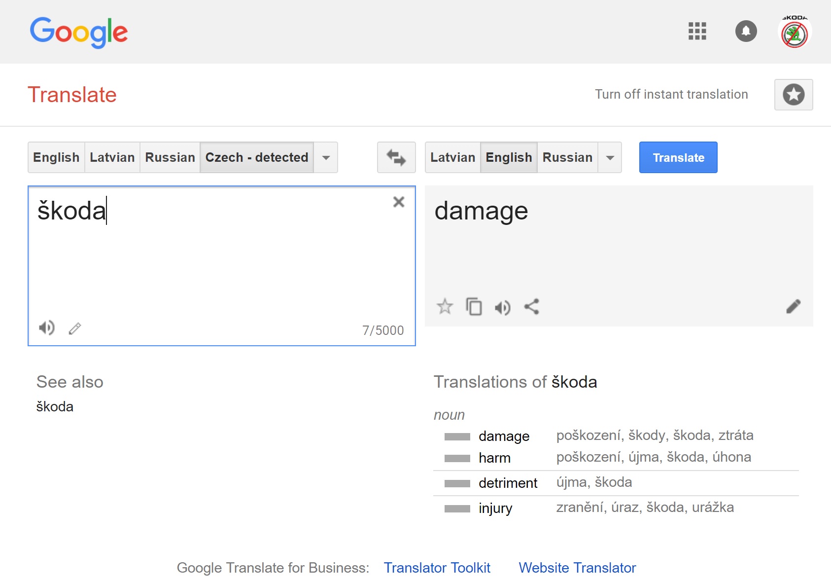

Google Translate gave me answer where are the problems coming from :)
in Latvian 'sorry' :)

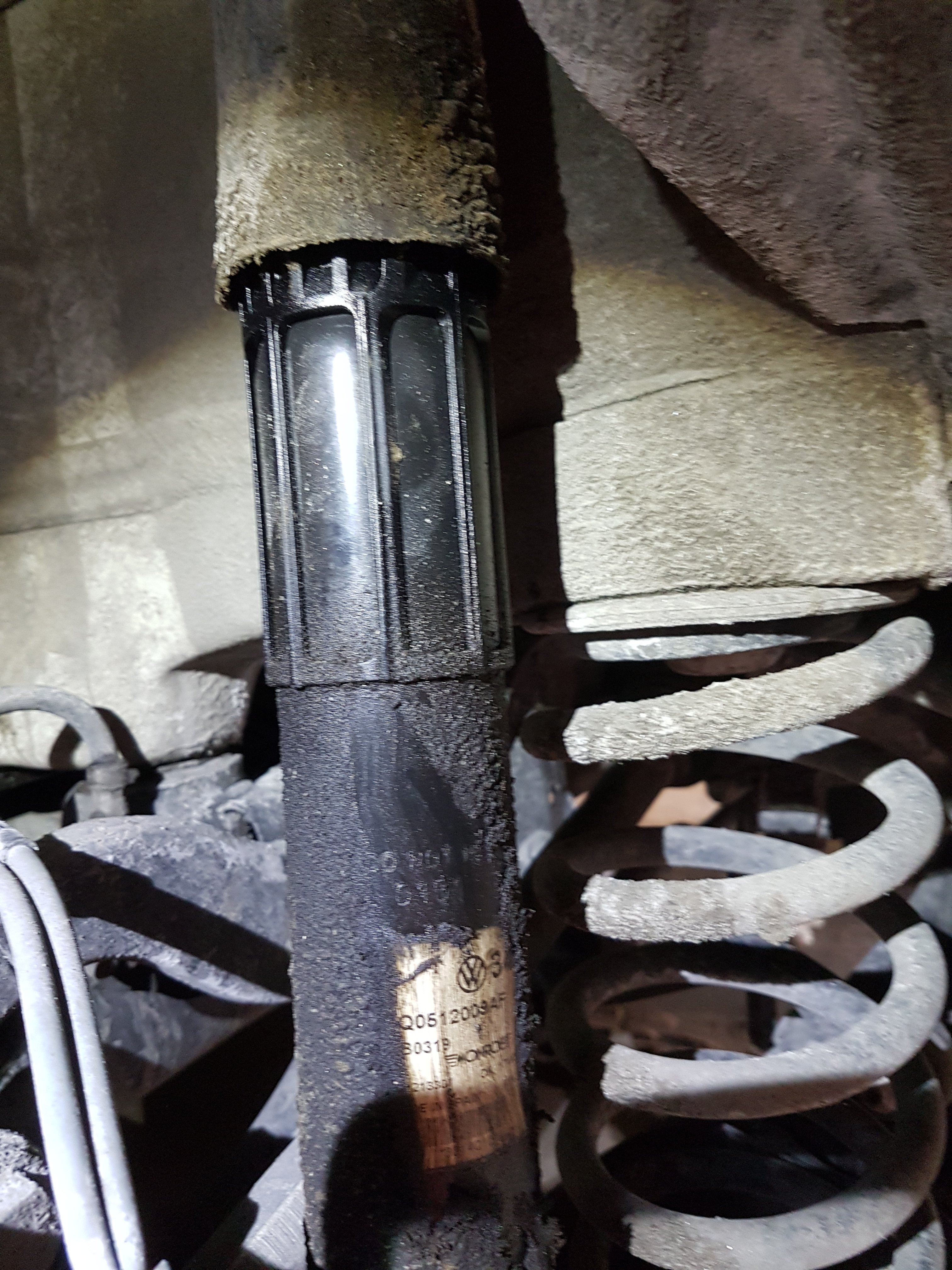

Booked in this Thursday. Couldn't wait though so I jacked the rear end up and removed the wheel.
I think the picture is self explaining - my RARB must have been working overtime trying to get the car leveled.
All the oil on the outside and no oil on the inside = bad handling :)

My dealer/workshop is excellent. No discussions about what should or shouldn't be.
Sent them the picture of my left damper and they've ordered a new part based on that. But of course - I haven't had any other problems/rattles that are hard to find the source to.
Dealer advised no fault found.  But as i told them it only seems to do it now when its ice cold.
My new damper didn't arrive in time but the Skoda technician took a test drive with my car and came to the same conclusion. Faulty damper and the noise probably comes from the heavy load the RARB is getting trying to level the car. He also said that the bad handling over sharp edges is caused by the bad damper. Not that it's bouncing more like a car with really hard suspension.
