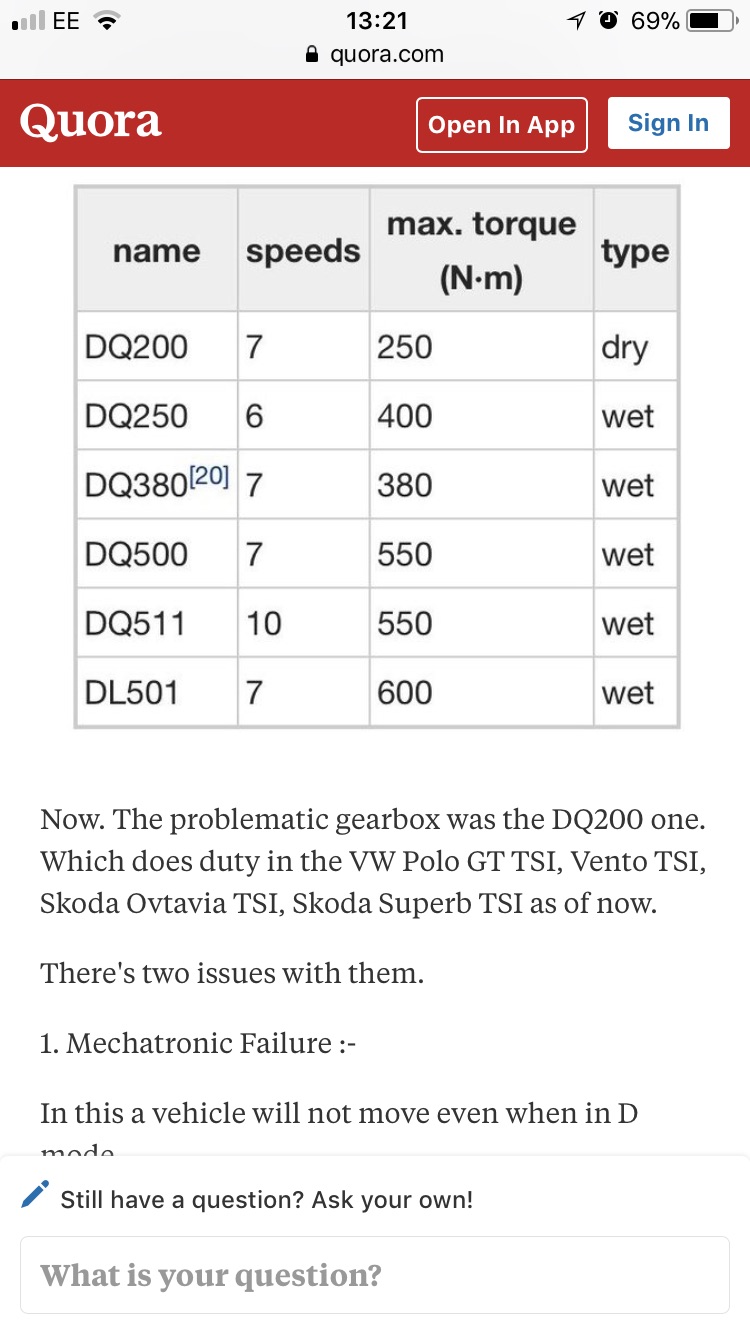

But I have read somewhere on internet dry clutch just on Tsi models.i will send picture which I found it online.
