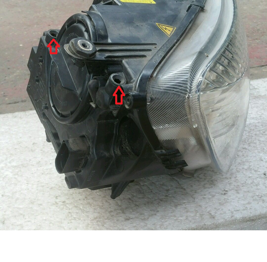

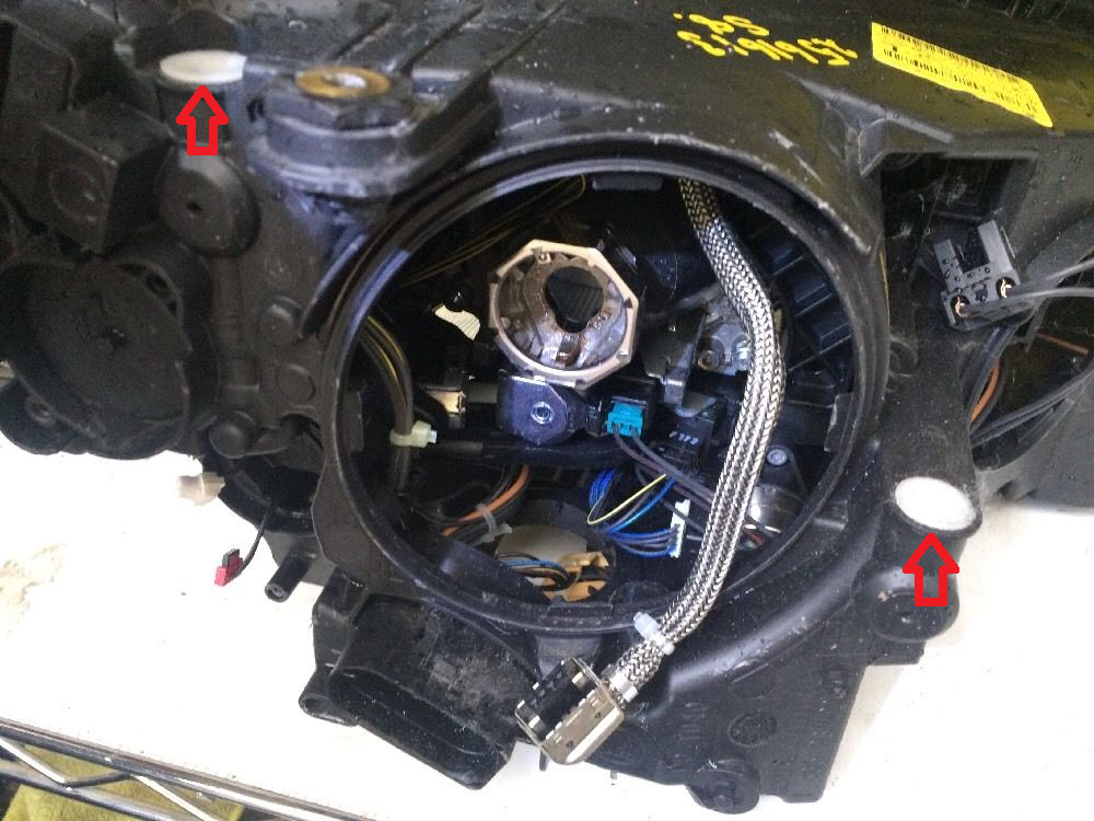

I have a 2012 Yeti Elegance from 2012 (Pre-FL).  I always found the Xenon headlights to be a combination of really good and rubbish, because the dipped beam has a very sharp cutoff and seemed to be too low.  With the amount of traffic these days, the luxury of using full beam is often not available, so I frequently felt that I really couldn't see far enough.  The law doesn't allow an adjustment control on the dash for Xenons.
I contemplated adjusting them myself, and as I understand it each lamp has one screw for up/down and one for left/right alignment.  It is quite possible to do this manually without invoking any electronics, you need a long allen key to reach them.  However be prepared for a lot of trial and error as a little tweak can have a big effect.
However, if the adjustment needed is simply for both lamps to go up or down by the same amount it is easier to give the job to a dealer to do electronically.  The MOT regulations allow the flat part of the beam to be between -0.5% (minus half a percent) and -2% (minus 2 percent).  The lamps are stamped with a recommended setting of -1% (minus 1 percent),  Unfortunately the car was delivered with them set to about -1.5% judging from the 50 metre distance along the road from the car to the point where the beams reach.
So after putting up with this for 4 years I got the garage to adjust them to -0.7%.  With a headlamp height of 750 mm the reach has doubled to 100 metres. What an improvement !  I wished I had done this sooner.  They still pass the MOT and in 12 months  I have never been flashed by anyone to indicate dazzle.
A word of warning.  The garage will use beam setting equipment.  As with all technology, it should be OK, but might be faullty.  Similarly, the person using it should know what they are doing, but might not.  The final arbiter is how the headlights perform on the road, not in the workshop.

The screws are on the headlights... Should take a hex key, possibly 6 or 8mm iirc.
Please don't adjust them without using a headlight alignment tool to check them!

My 2012 Yeti with Bi-xenon headlamps were set extremely low when I bought it. So low as to be dangerous in my mind.
Followed instructions from a previous post on this forum to adjust them, and boy what a difference.
Feel safe to drive on dip beam now, and no one has ever flashed me to complain (if they were too high).
Only a long allen key needed, and the adjusters were on top of the headlight bodies.
