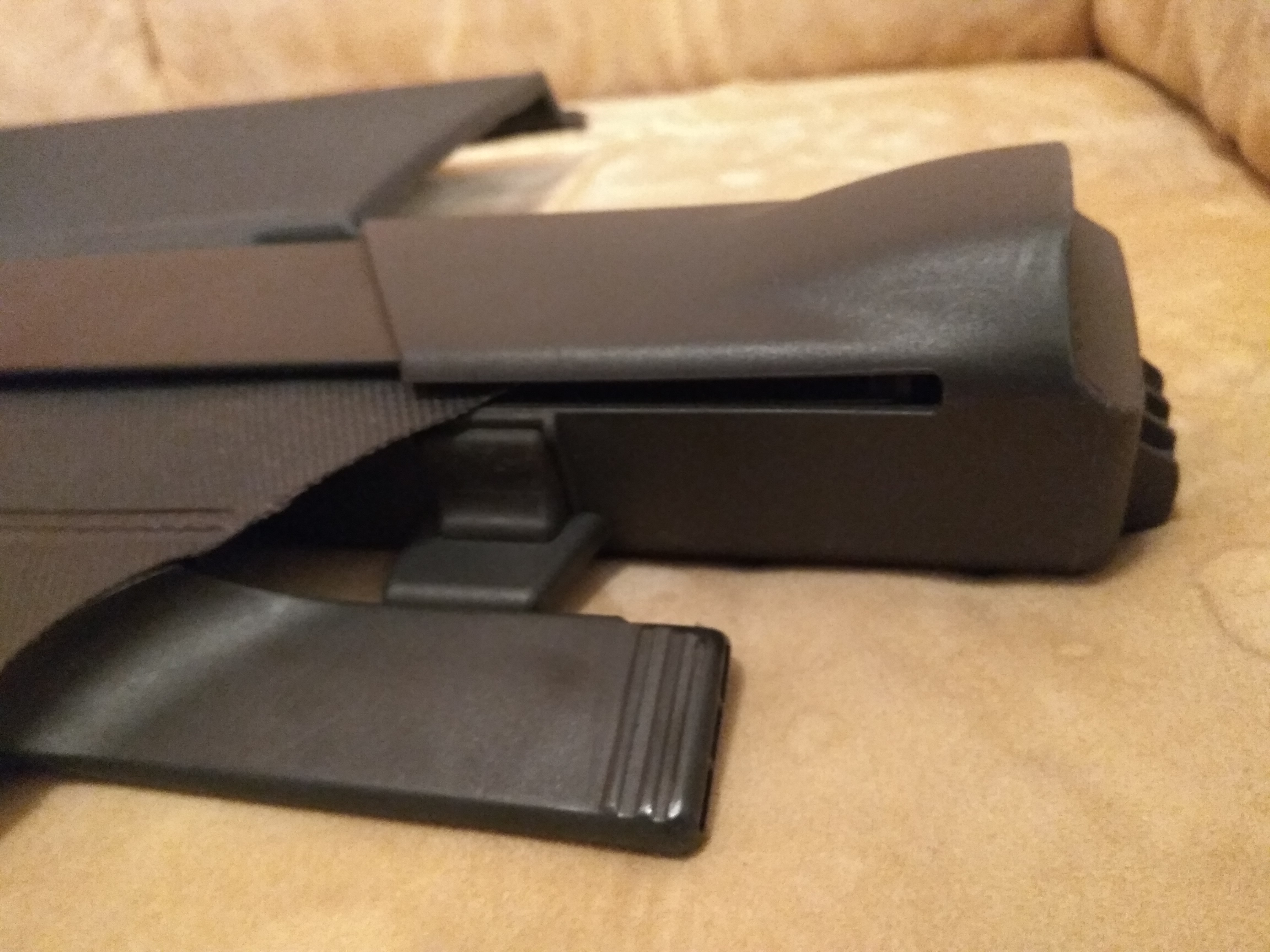

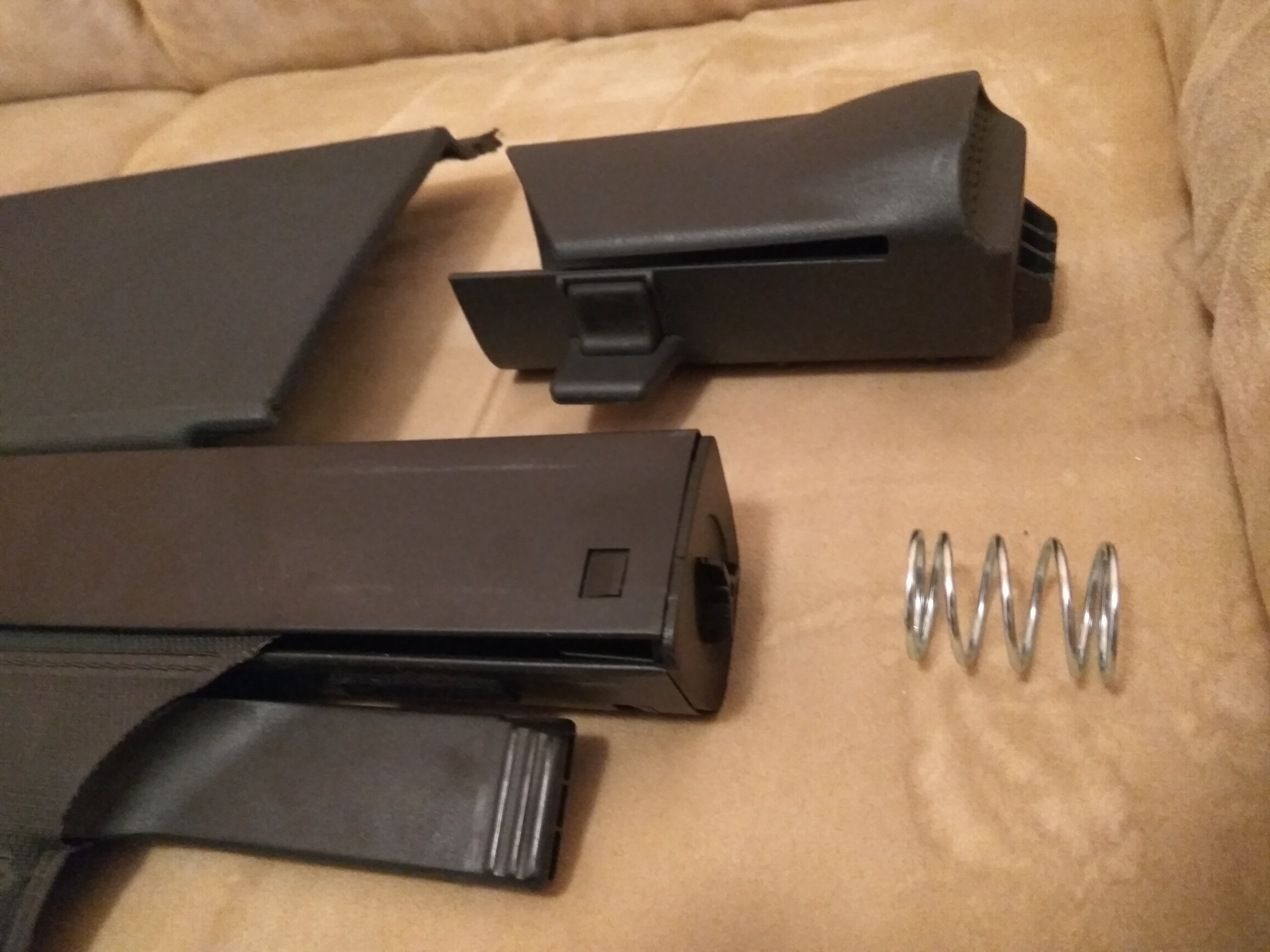

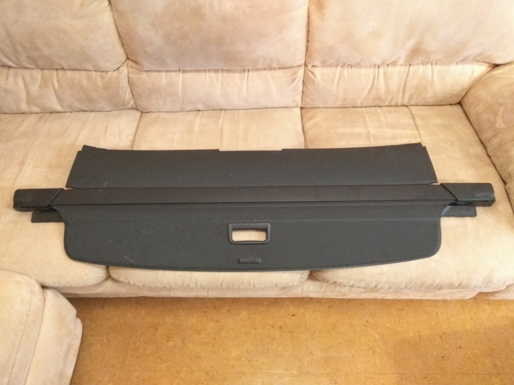

Hello, I found a way how fix it, by disassemling the cover and twisting the spring stronger.
As you probably know you can take it out of the trunk by pushing in the 2 caps, collocated on the right and left hand end of the cover.
- These caps can be removed. I didn't find an easyer way than strongly pulling on them, but nothing gets destroyed. Then you can see what is shown on the 2nd picture. The spring of the cap, and the removed cap.
- Then you can open the clippers to remove the part holding the rolled up cover. The right hand one, which is shown on the picture, just tolds the roll in place. The one on the other side is the one responsible to pull in the cover. Be carefull removing it, because it might be under (rotational) tension.
- To be sure better remove the whole sheet on the right hand side (shown on the second picture).
- Inside the roll is a spring, which creates the tension pulling it in. Disassembled its tensionfree. So now you can stick in the lid on the left side, and twist it against the cover in order to create the tension. You can twist it about 30 times - but try yourself. Then CAREFULLY put it back in the box, stick in the other lid on the other side. Make sure all clippers are back in their slot.
- Now you can try if it works. If yes, put back the springs and caps on both sides, and voila.
