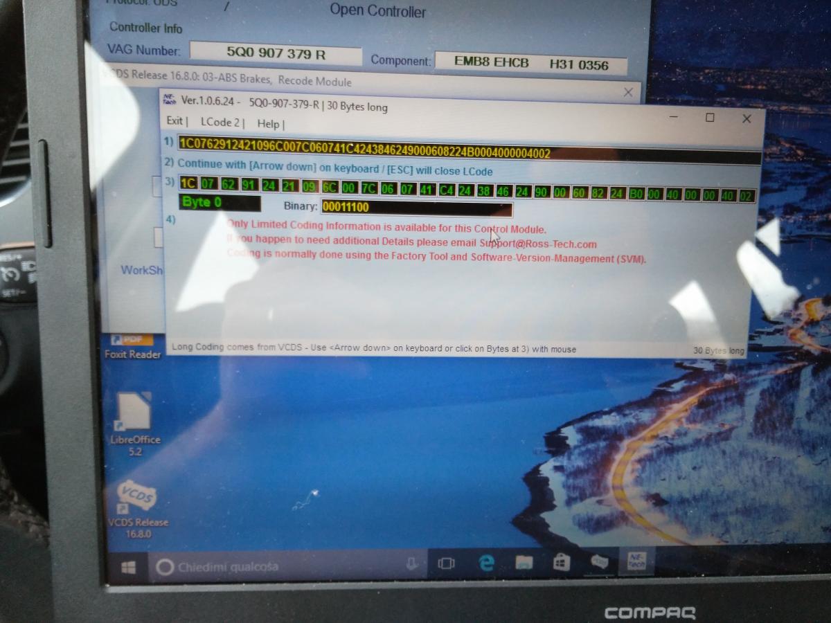

Hi get this message,
what can i do?  can't code the Hill Holder
Sorry i have not much vcds experience
Try updating to the latest VCDS which is version 16.8.3, that may have the options shown better.

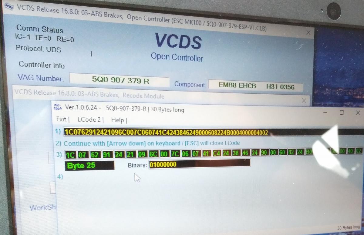

Do you know the process for coding in VCDS...to enable hill holder???
I have these notes saved:
Folgende Codierung ist anzuwenden:
STG 03 (Bremse) auswählen
STG Codierung -> Funktion 07
Byte 25
Bit 0 aktivieren
Bit 1 aktivieren
Also links to these videos, not in english but still helped me:
After coding HHC you can go to adaptation (ABS module)... Then, you can decide how strong you want it... There are three options: early, normal and late.
Do you know is this possible to do for every Octavia 3...or do I have to have some special abs module on my car??
