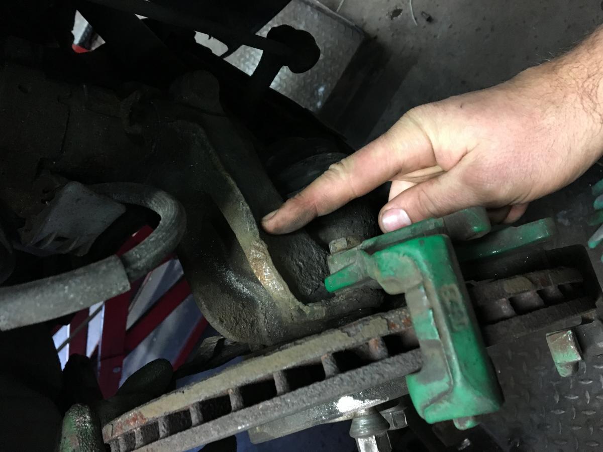

Visited a local brakes & tyres specialist today due to my driver's side disc making worrying scraping/grinding noises. Turns out hammering off your alloys is totally ill-advised. :( The hammer must have hit at the hub unit a tiny amount and over time has forced the calliper to be forced ever so slightly and diagonally forward, connecting with the disc.

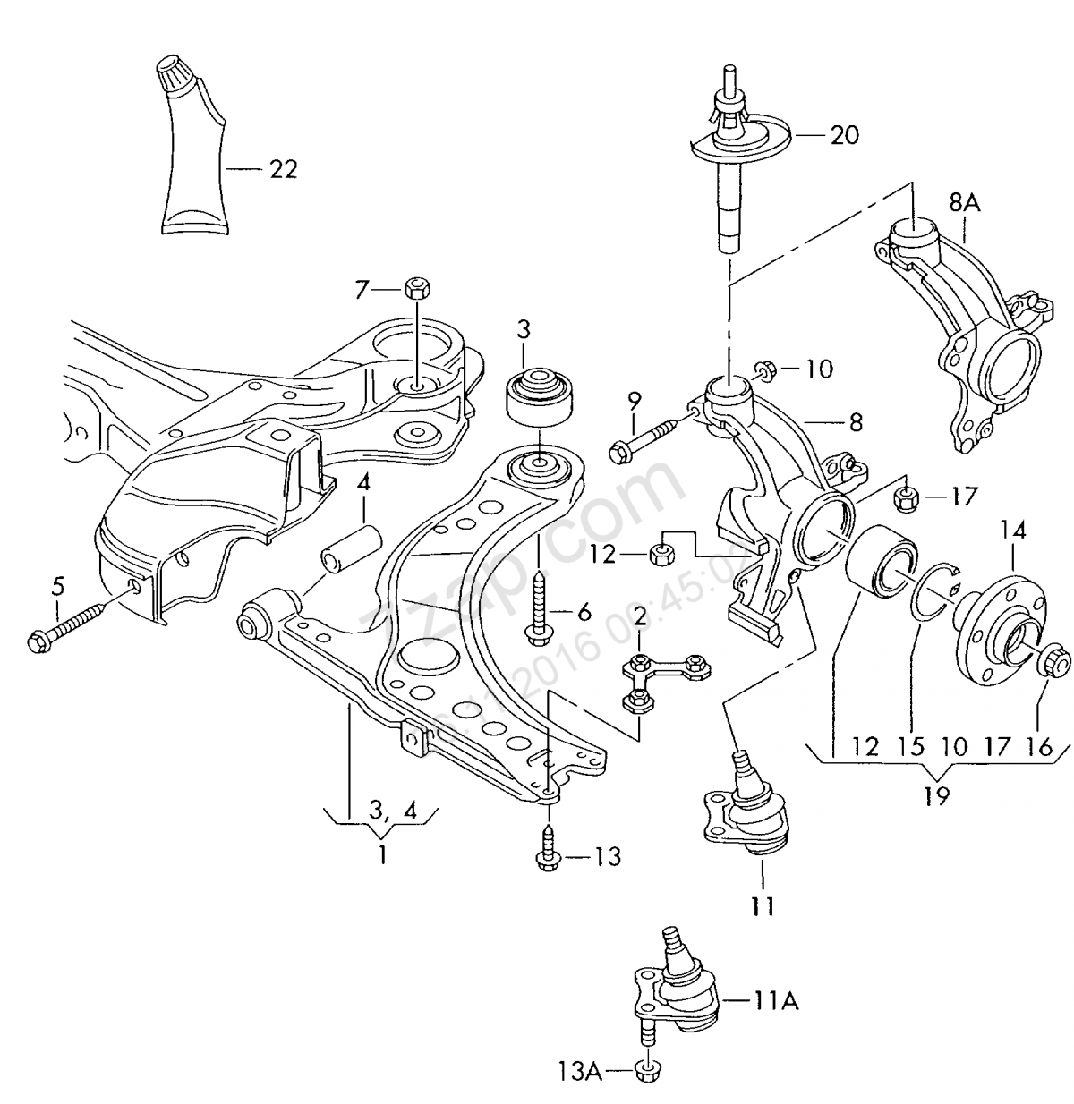

I think this is what you need, but hopefully others more familiar with Otavias can confirm.
That listing was found by searching 1J0407256AH, second item 8A here, which I think should be right for your car.   Knowing your engine code would help confirm.
That is the correct part, but if you go direct to the GSF site and enter the code BLACKFRIDAY in the checkout you'll get 50% off :)
The service mechanic's first language wasn't English. Is what he's point at (attached picture) definitely the 'Hub unit' in question?
Excellent point, brings it under £50.  I wonder what the genuine part costs? Almost worth phoning to ask just to see the contrast.

Bought. Nabbed a top mount while I was there, too. Saved £64 in total. Many thanks to all for your help!
